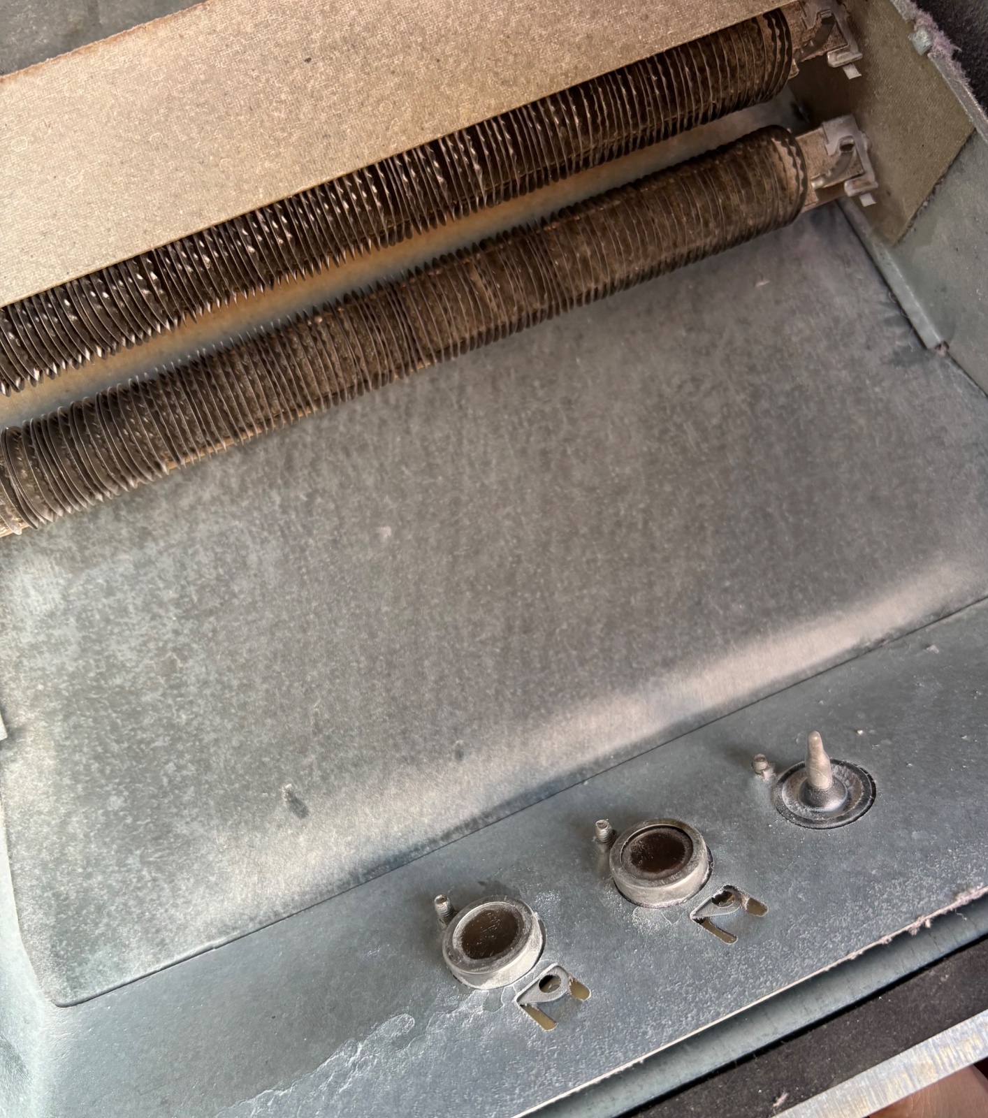

Our Hotpoint TCL780 tumble dryer has stopped heating up. Everything else appears to be working okay with it.
I was wondering if it could be the thermostat components?
I’ve attached a photo of what I believe are the thermostats.
Just wondering if anyone had seen this problem before? Would appreciate any suggestions!

Is the stat the two circular components on the photo?
We cannot tell, from the photos.
How do you check the stat other than replacing them?
That, depends on the stat type. There can be simple on off thermal switches, or actual temperature sensors, feeding temperature data, back to the control board.
Simple check first - check the resistance across the heater element, to work out whether that has burnt out.
