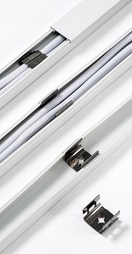

The standard method it seems is to use metal clips inside the plastic trunking
as shown so the cables even if melted do not obstruct the fireman's progress.
The clips however need to remain in place even when all that is left of the cables is copper wire. They are normally used every so often not every screw goes through one, when I was working on a gas terminal we used steel tie wraps every 5th the other 4 would be plastic, so the weight is increased to what is normal.
