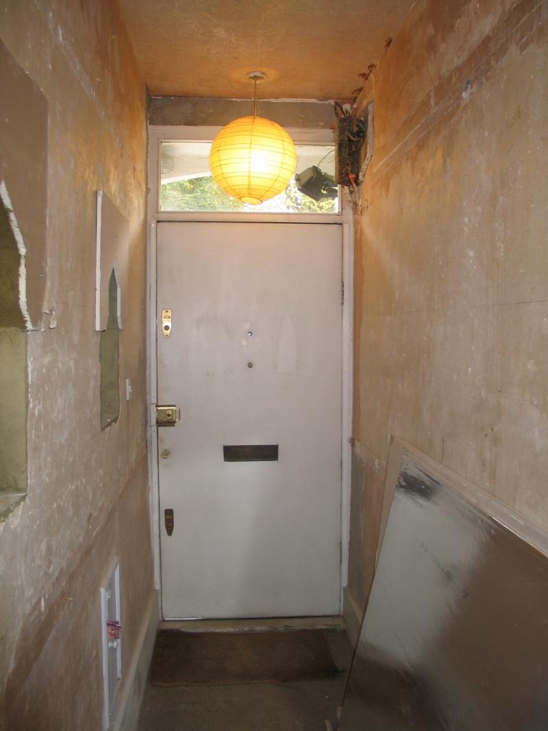

Have just started to do do some major renovation on our house and have removed a battered old box that was enclosing the service head. Revealed underneath was what appears to be a very Heath Robinson affair and even more worryingly the wiring seems to suggest that the house is not earthed ...
Location of service head:-
Two CU angles on service head:-
I got in contact with the DNO (EDF) who sent a couple of guys around this morning who informed me that there was earth going up to the main service head block but not coming out to the fuse units to the right of the block. They then informed me that they were only responsible for the main block as the additional units would have been added by someone else when the meter was moved to the small cupboard that you can see in the bottom left hand side of the corridor in the first picture. They also bizarrely went on to say that in some older houses the main earth is linked to the gas mains and it is not necessarily the electricity suppliers responsibility to provide an earthed source.
I was under the impression that they would be responsible for everything up to and including the meter, but before I call EDF again I'd really appreciate any input from you guys out there.

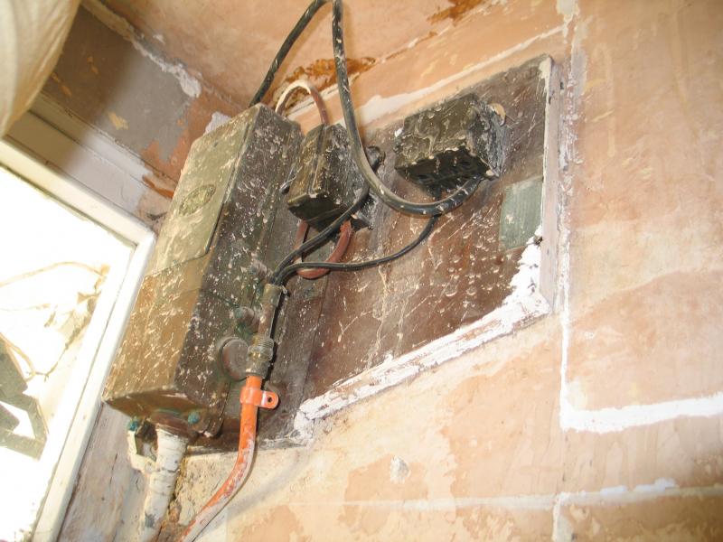

If you look on the main cable below the head there appears to be some sort of earth provided from the clamp round the mains cable and that extending to a bolt fix on the head to the lower LHS.
The DNO is not responsible for internal wiring, so earthing is the premises owners issue once on that side of the mains.
I'd suggest you get the DNO earth tested by a spark, if okay then he can supply a MET block with a 16mm cable between the MET and the service head earth point (large eyelet crimp over cable and put it under the same bolt the earth head is- suggestion ONLY).
From the MET you should have 10mm earth bonding cables to the gas and water main (within 600mm of the stop cocks), and a 16mm to a CU or in your instance cable suitably rated for the fuses you have.
Since they look well past the service level and there be further works down the circuits (earth checks, rewires or simply connection what hasn't been) I'd go for a full freshen up of the site- a rewire if necessary.
As I understand it (I spoke to a DNO about a similar matter this week) they are responsible for the supply up to your meter.
It does look like you have some kind of (undersized) earth in existence though.
I can't help but think the whole thing is a bodge - the pyro only looks to be somewhere around 2.5mm? If you look at the pot on the end of the pyro there should be some numbers and letters on it i.e. 2H2.5 or 2L4. I'm thinking it doesn't really look large enough to supply a household.
Officially, only the DNO should work in this part of the equipment. It may be they will put the meter back on the board for you?
If they will then get them to terminate it into an isolator, then a household spark can connect a 60A or similar switch fuse to a sufficiently sized cable.
You are right in there doesn't appear to be any earth to the pyro supplying the meter.

Its rare to see this. A long length of cable between the service head and meter. But yes, the cable is undersized, and I wouldnt think it was the work of a DNO. But I dont understand why the meter would have been moved from there to another location in the same room. I mean, fair play if you want your consumer unit lower down, but why the meter?
I'd ask the DNO if they could renew the supply - fit a new head and meter onto that board (or a new board if you wish to supply one pre cut - they wont)
And when they fit the new service head they may PME it too. The best option.
Then you need a spark to renew the supply to your consumer unit - the current setup is not ideal, and would need a 60 amp fuse to protect it at source (the DNO fuse may be 40-60 amps, but you cannot rely on this to protect your 10mm cable, you need your own fuse)
The best option is to run a 16 or 25mm² SWA cable to the CU position, or re-position the CU to the position above the door. It looks like the house is having a refurb, so its an ideal time to do this.
Pyro is that orange cable/pipe on the right. Its a type of cable that is resistant to fire, so often nicknamed pyro.
The pot is the bit on the end, which keep the mineral fibres in the cable and seals it from moisture.

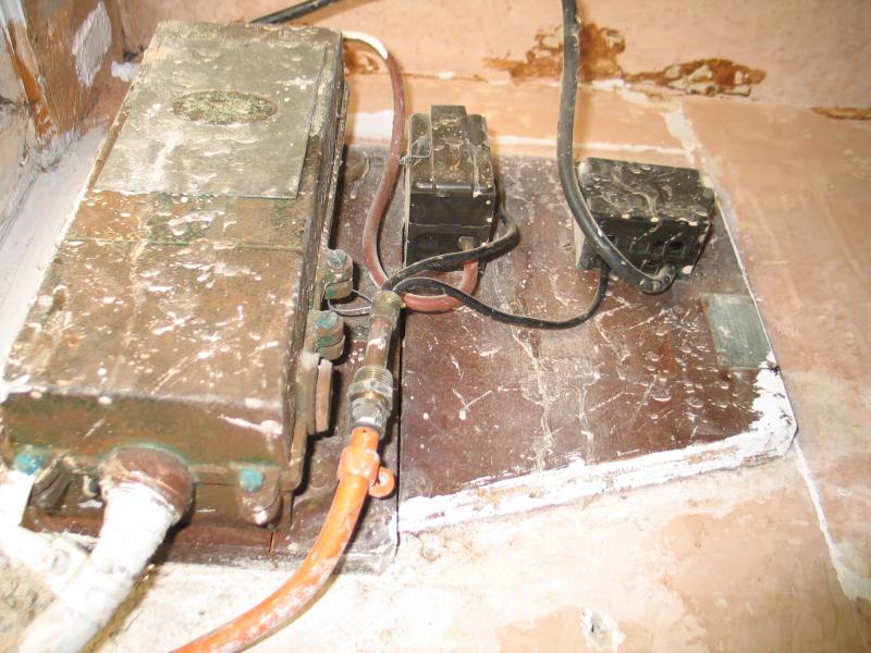

Look very carefully at the end of the pyro on the gland (the bit resting on the orange outer sheath) the and the pot (the bit where it turns to black wires) and see if there are any markings.
I'm just comparing them to what you have in the way of tails from the cutout to the henleys. It looks quite a bit smaller. Of course - we don't know what you have in the fuse holder (sealed brown holder in the middle) tho.
