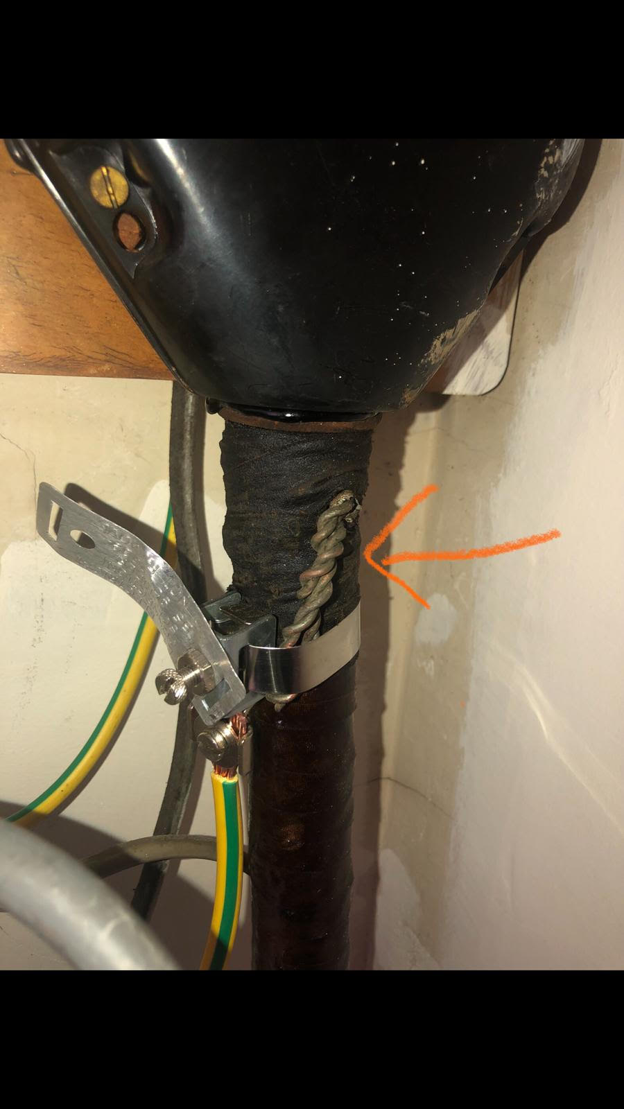

some photos would be useful, especially of the incoming supply cable and the service head.
is the electricity meter inside your flat, or elsewhere?
how old is the building?
are you in a town?

Photo attached, thick black cable is the electric supply coming into the flat

the incoming cable looks to me like the original.
if you have any difficulty getting them to provide PME, tell them it has a pipe clamp round the armour (this is poor practice since, if very tight, it can damage it.
It might actually be clamped onto the bituminous bandage, which is not much good.

In the picture, the earth clamp looks very new.
The cable looks very black.
Is the black on the cable;
Bare metal?
Bitumen?
PVC sleeve or similar?
Unless the clamp is on clean bare metal, you aren't going to get much of an earth.

The cable is covered in bitumen, but that twisted cable sticking out is the earth from DNO. There is no aqequate ZE reading on that DNO earth.
