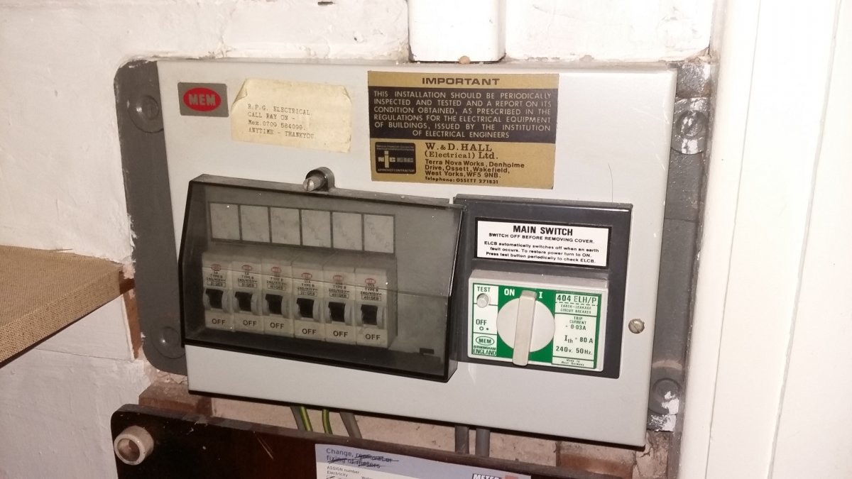

20160823_123503.jpg consumer unit, probably late 80s.

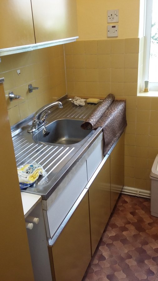

20160823_134116.jpgthe other side of that wall, mostly taken up by an enormous sink unit.

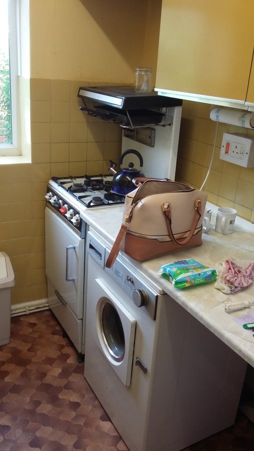

20160823_134121.jpgopposite. In the fixtures and fittings pack they ticked the cooker nd washer were included. I rather think these actually qualify as scrap metal. Ie rubbish that should have been removed . . .

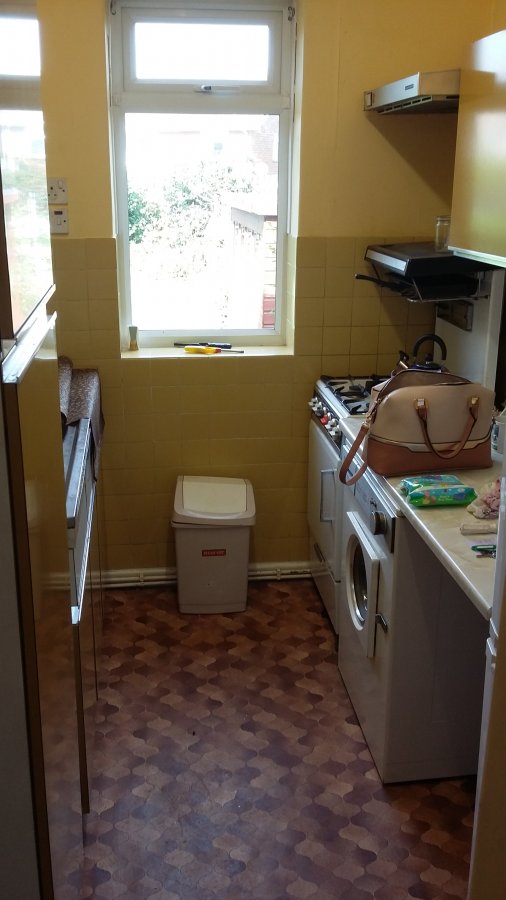

20160823_134111.jpgkitchen down the middle. The wall will be removed at some point. It sounds like a stud wall but low down i can see some brickwork behind the cabinets. We are also having a full width extension built too, after we move in.

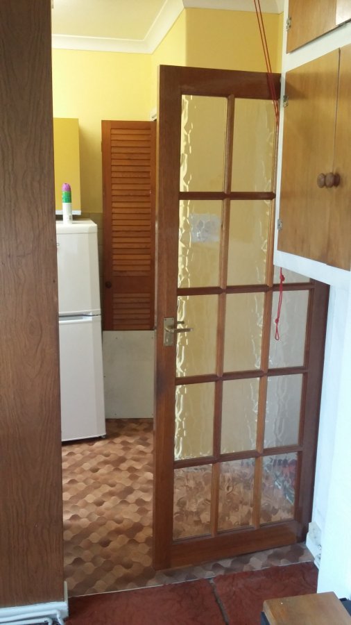

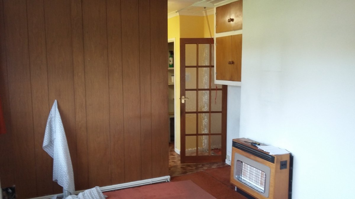

20160823_134101.jpgthe door. If open, you have to squeeze through the gap.

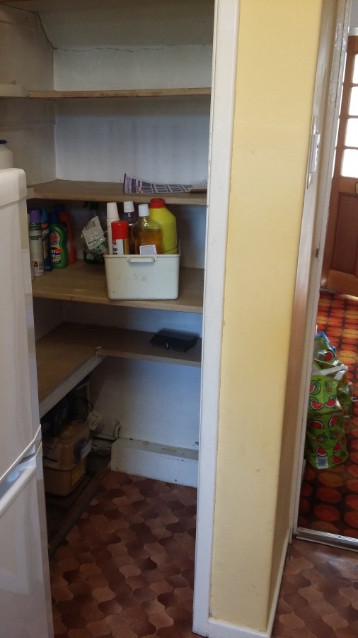

20160823_134128.jpg kitchen larder, containing an assortment of cleaning products, a full tub of Hillards salt and the gas and electric supplies.

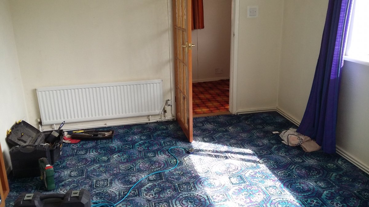

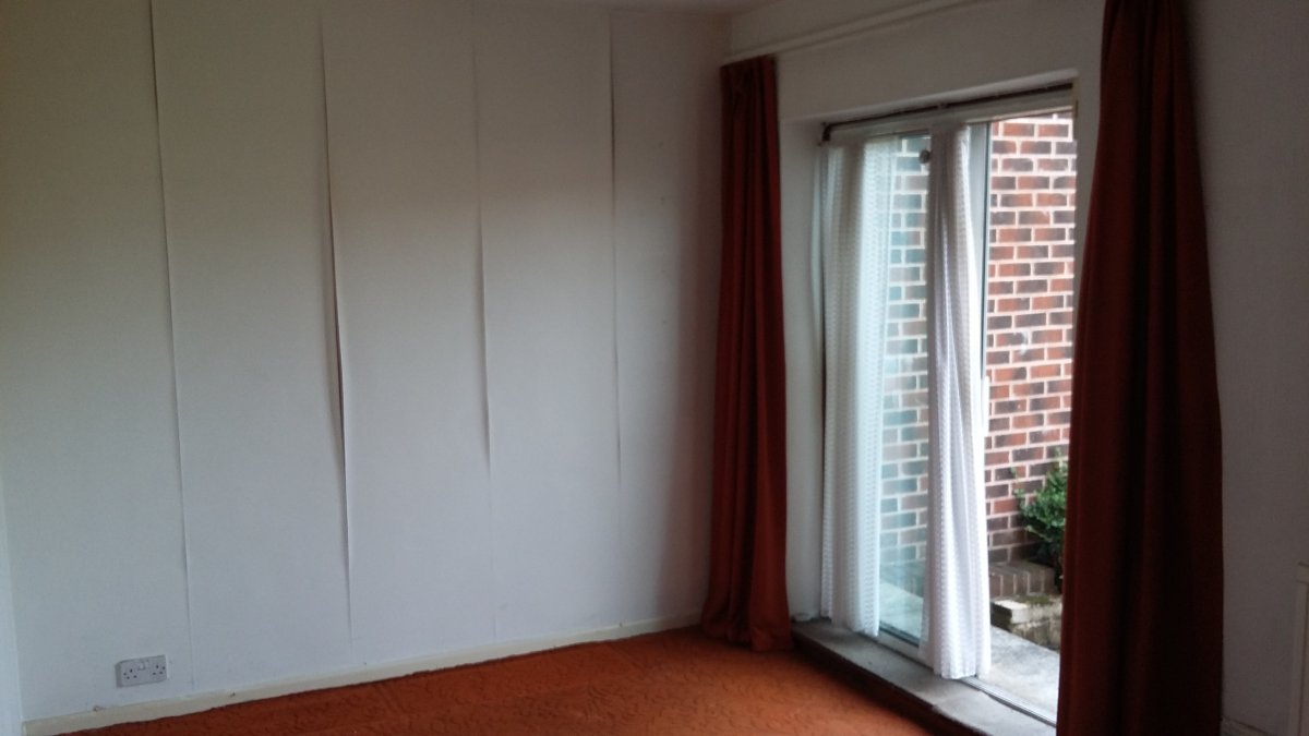

20160823_134144.jpg moving on to the living room. The carpet in here is really quite nice quality and we may leave this in place if we have to move in. That fire is back to back with one in the dining room, with a back boiler in between.

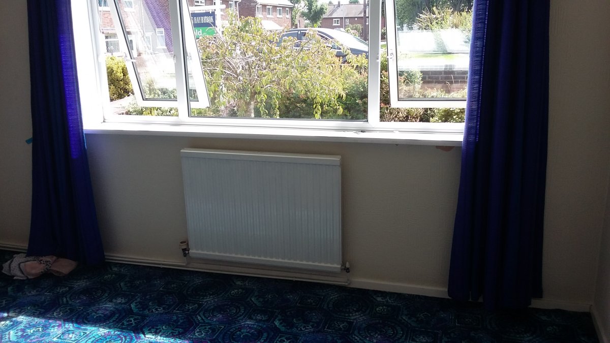

20160823_134200.jpg some of the windows are newer than others. The newest were fitted in 2009 by safestyle. No doubt that dented the inheritence. . .

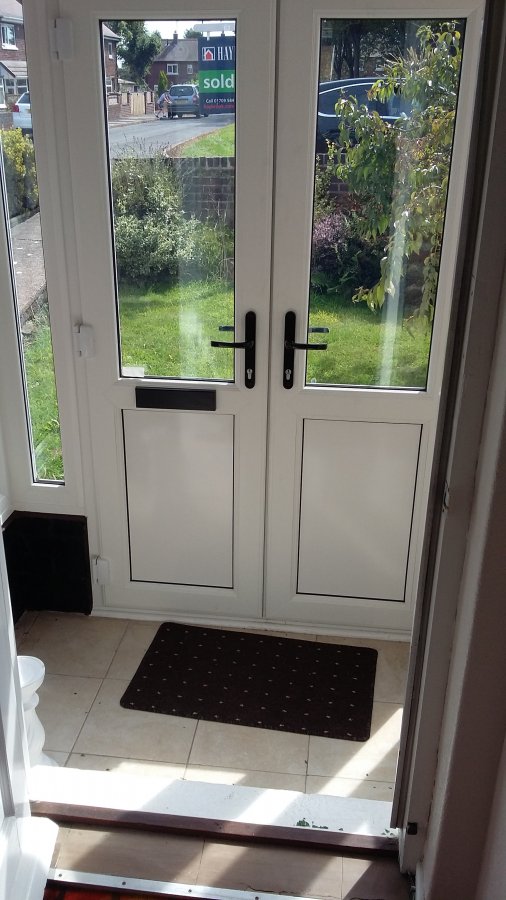

20160823_134225.jpg this porch was also renewed by safestyle.

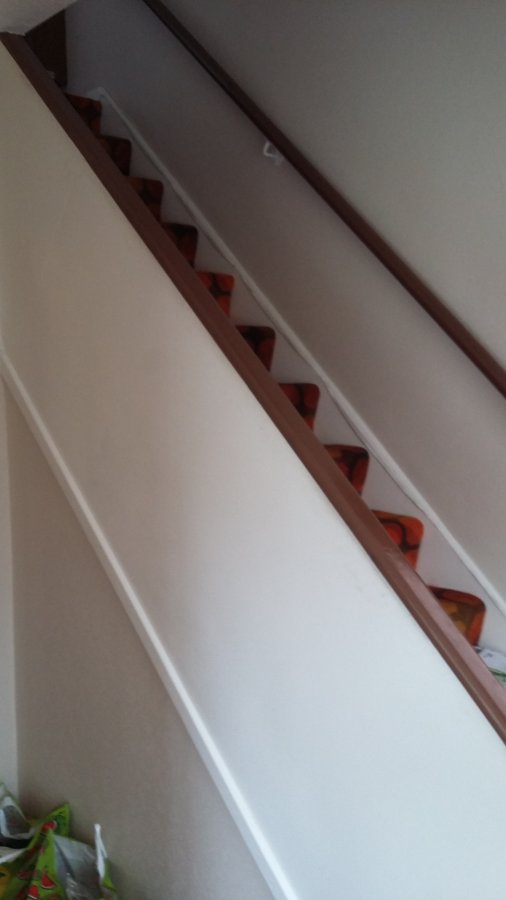

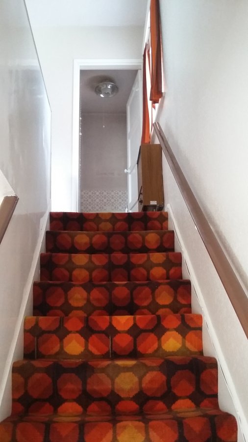

20160823_134212.jpgstairs. The hideous boxed in stair rail i believe is original as all the houses round here have this. I will investigate replacing it with a more traditional post and rail system.

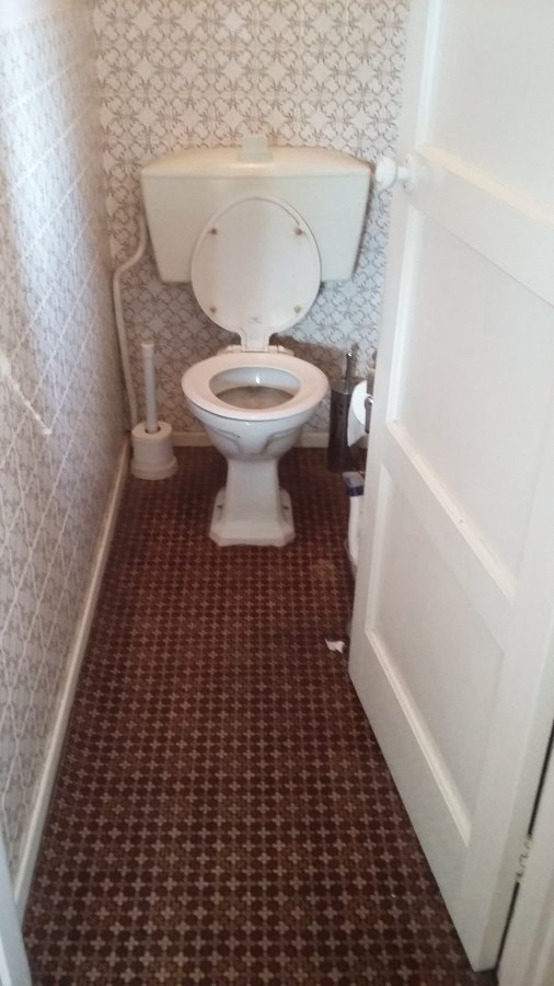

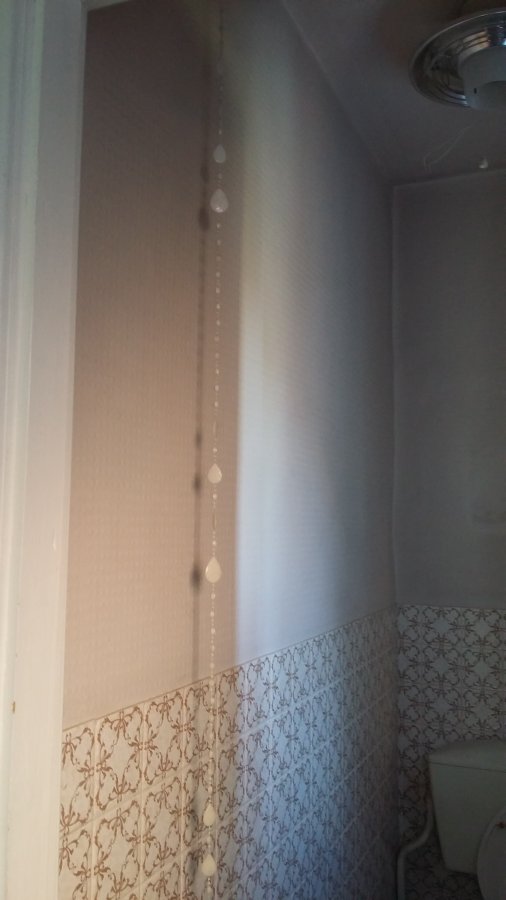

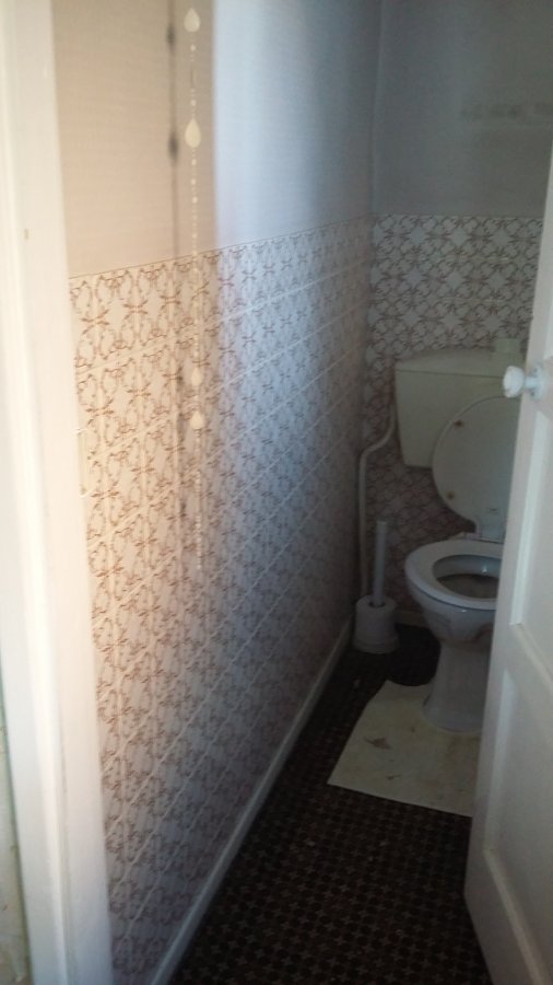

20160823_134245.jpg toilet with retrofit plastic cistern. Originally had a high cistern. Can see the marks on the wall. The wall to the left of the pot will be removed to form one bigger bathroom. It appears to just be a thermalite block wall and runs parallel with joists above and below.

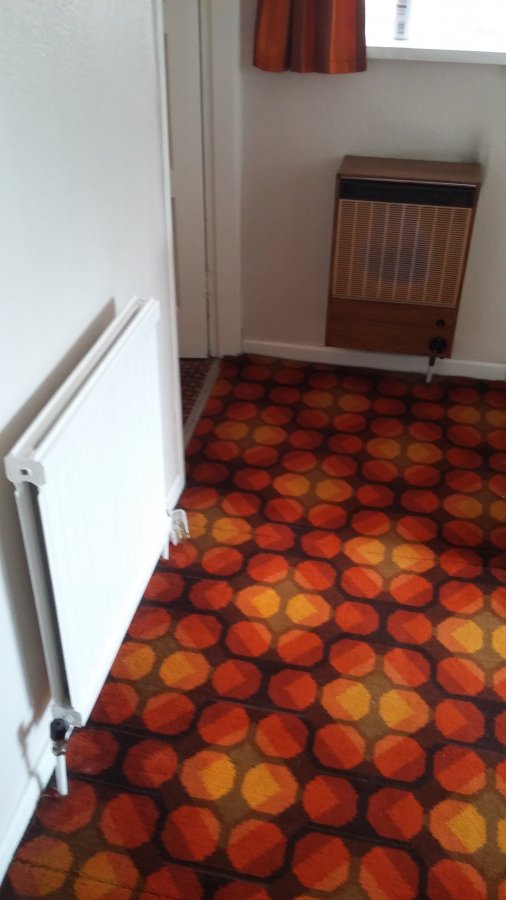

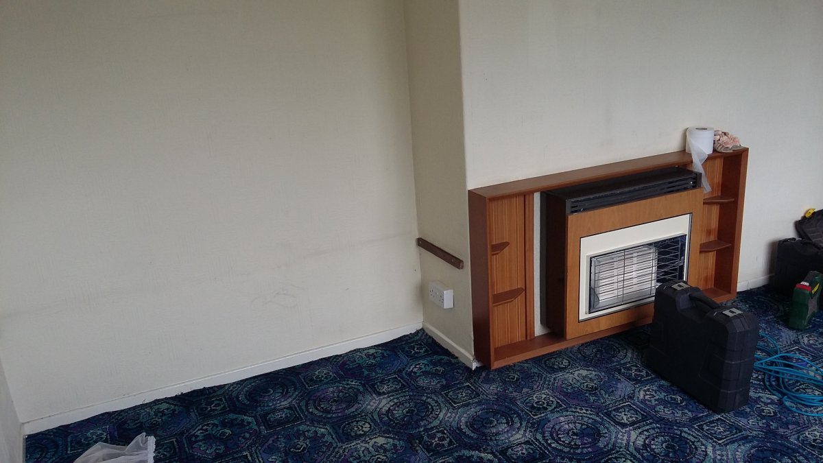

20160823_134502.jpg quite why they needed this ugly gas heater and a radiator on the landing is beyond me.

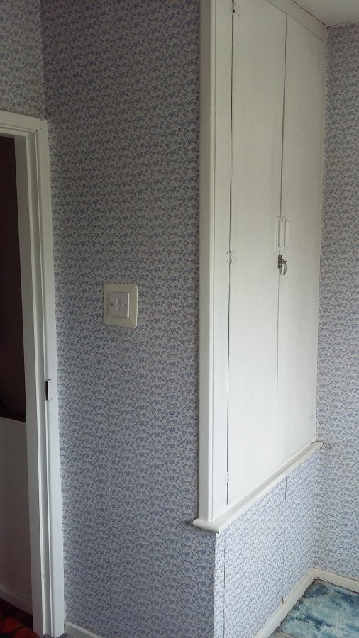

20160823_134342.jpg front box room. Actually quite a nice size, but we will be knocking that cupboard out down to the bulkhed and building a bed frame over it. Much better use of the space.

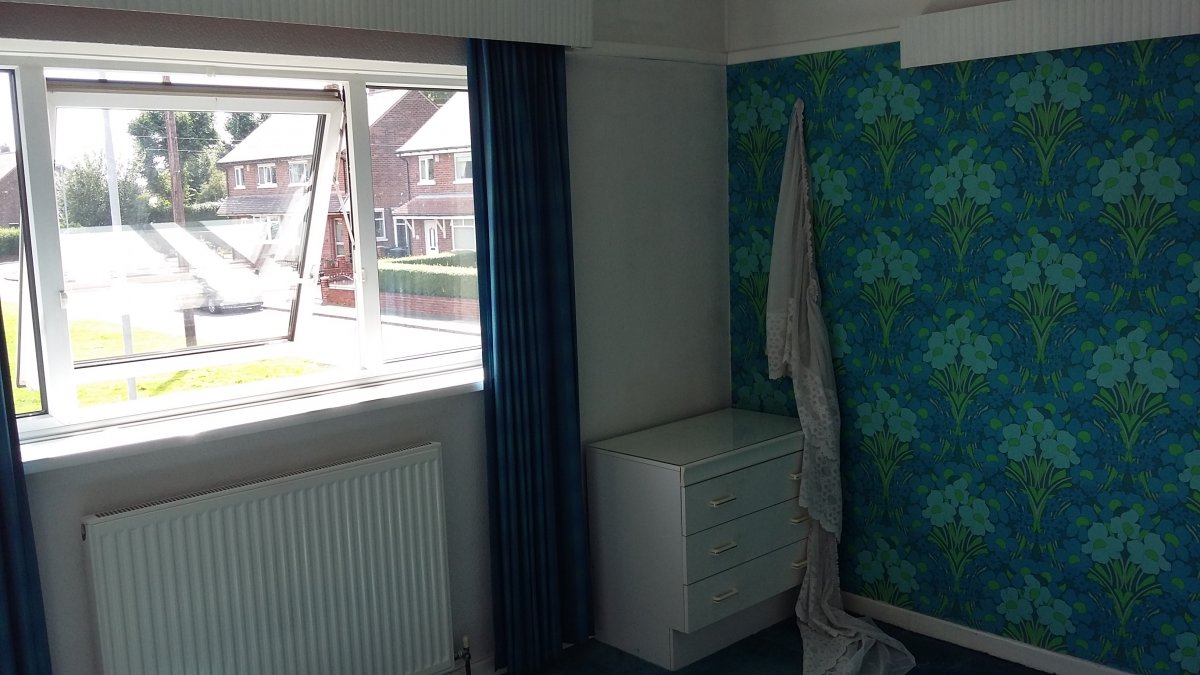

20160823_134425.jpg front master bedroom. Ugly t12 fluorescent lamp over the bed, wired in bellwire to a plug. The plug has a second bellwire poking out of it thats been cut off. My daughter (2yo) attempted to plug this in yesterday. Ye gods. Also worth mentioning all the bedrooms only have one souble socket. A rewire is coming.

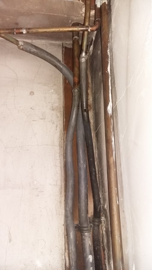

20160823_134536.jpg airing cupboard. Lead. Pipe. Everywhere.

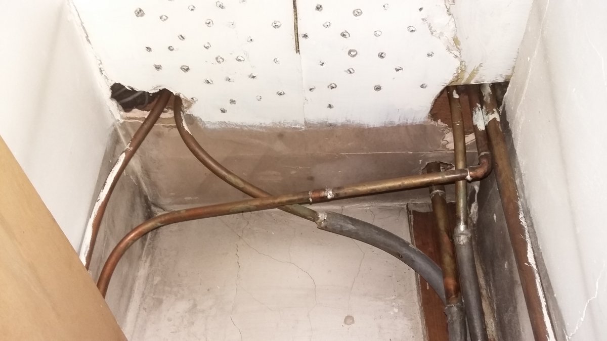

20160823_134609.jpg interesting pipework.

indeed some of it is much older. I imagine the toilet pan is the same age as the house which is 1950s.

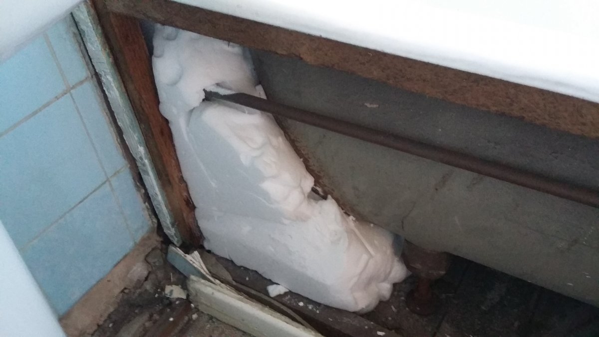

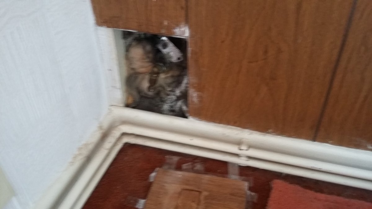

20160826_151719.jpg cavity wall insulation under the bath. Put my foot through the tiled panel. It was the only way.

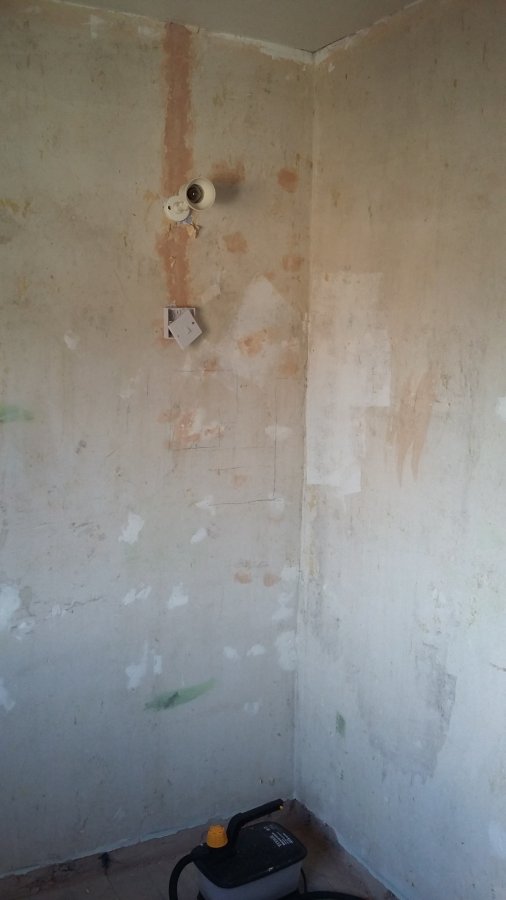

20160826_173314.jpgrandom wall light in the box room.

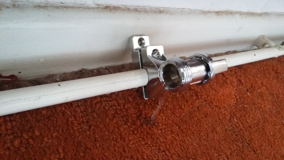

20160826_173447.jpg how we drained the heating system. I know its meant to go on bare copper but it only had to seal for 20 minutes!

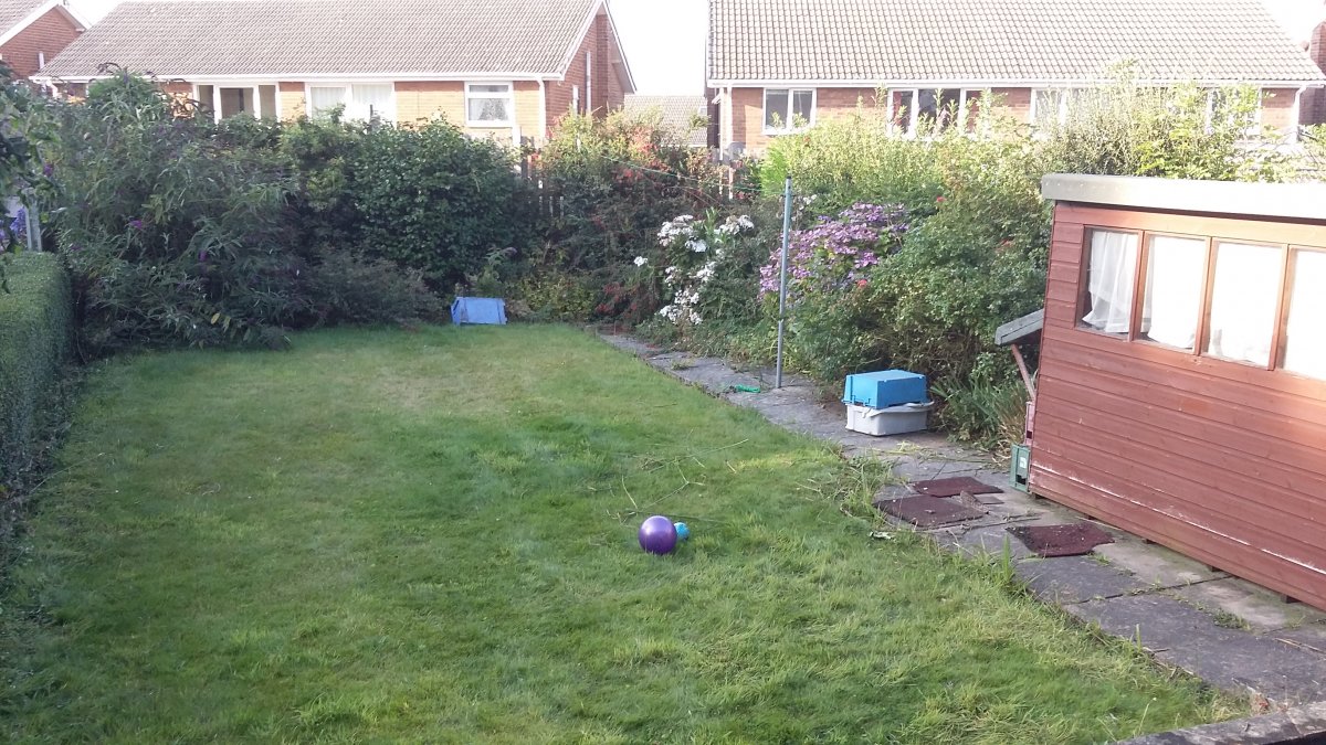

20160826_173522.jpg the garden.

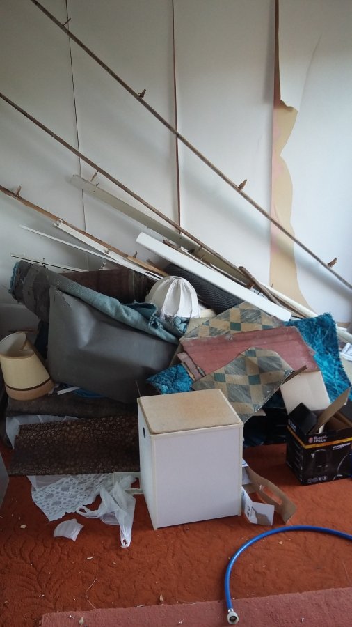

20160826_173501.jpgrubbish pile.

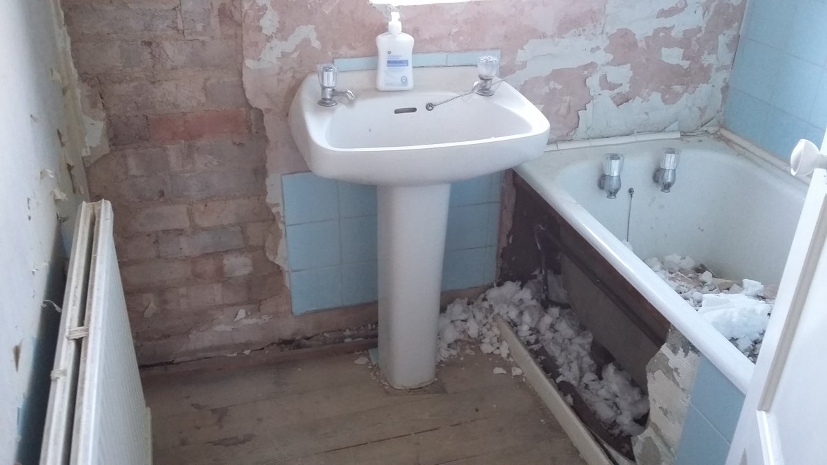

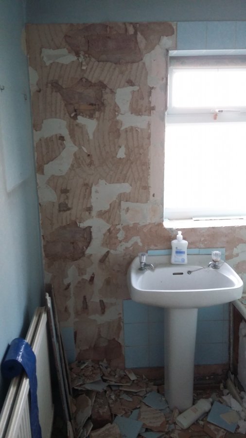

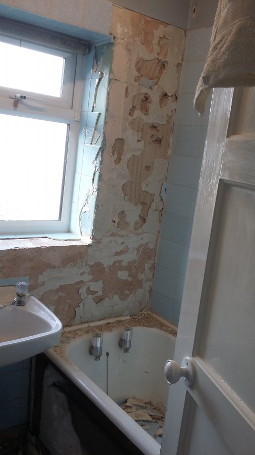

20160826_173731.jpgbathroom. All the plaster will need to come off, it is crumbling away like sand.
20160826_173742.jpgbath. The wall between the bath and toilet is being knocked down this week probably. Provided we can get the bath out. I'm hoping we can save the sink and toilet, loose the bath to maintain facilities for all on site.

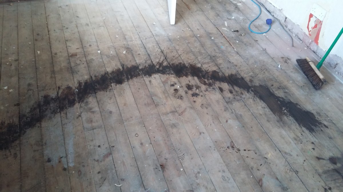

20160826_173758.jpg accident with a radiator. My dads contribution. The rad was empty but he decided to take it off the wall and start swinging it around like tiger woods. He learnt his lesson, for the others we tighened the bleed valve and inverted the rad as we lifted it off. Some of the rad tails were just too tight so we just lifted the valve off the copper pipe instead.

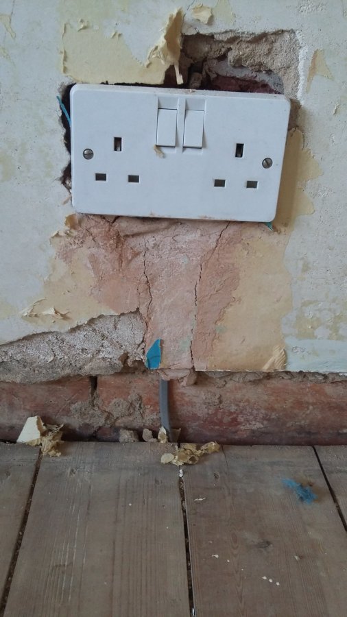

20160826_173814.jpg socket fed with suspiciously thin cable.

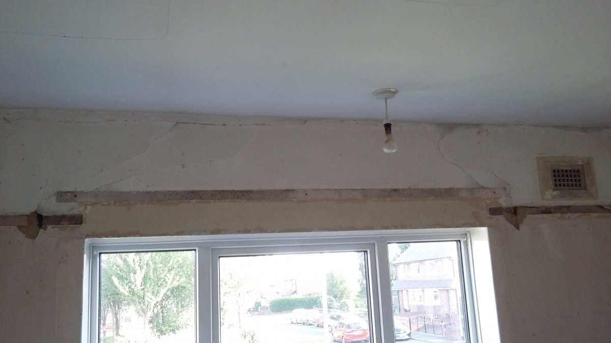

20160826_173834.jpgpicture rail just finishes above the window. Only picture rail in the master bedroom. Strange.

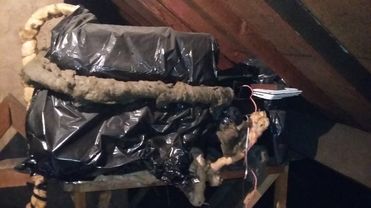

20160826_174132.jpgtanks in the loft, featuring my bodge at tying up the f&e ballcock. I added a few tiles under the batten to tighten the rope. The tank was full which i wasnt expecting. The pipe across the front is the overflor from the big tank which drains into the f&e tank. The overflow from that then goes down through the airing cpd and apparently out into the bathroom drain hopper. Strange. Oh and both pumpover pipes go into the hot water tank.

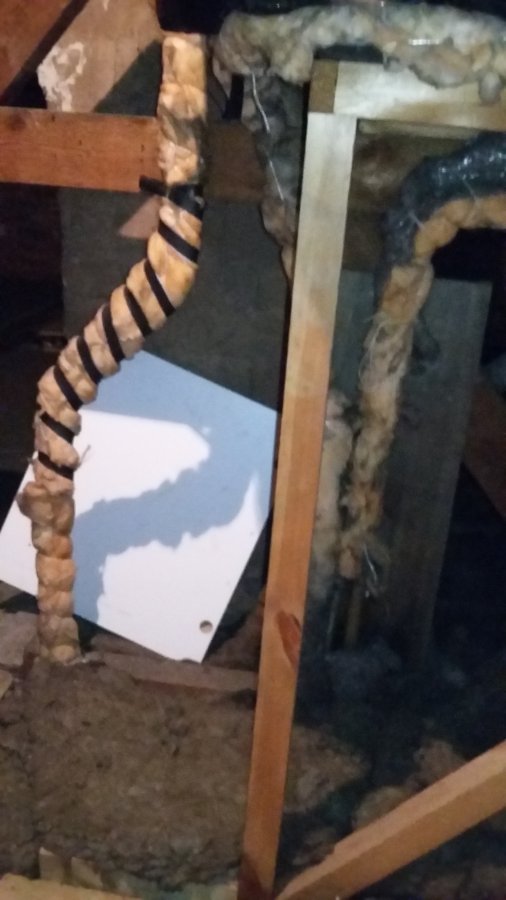

20160826_174141.jpgpipes to the tanks, with insulation that the mortgage surveyor implied may contain asbestos. . . Thoughts?

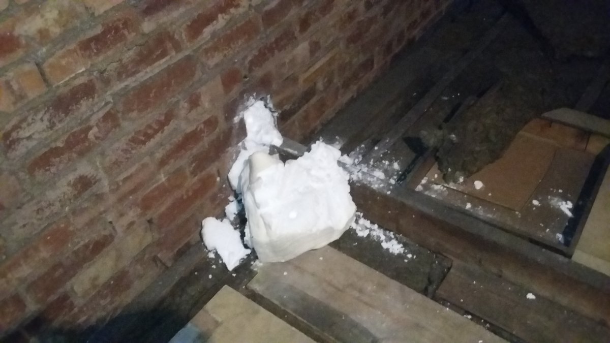

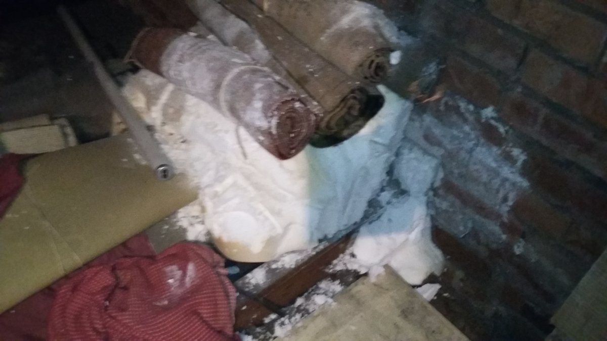

20160826_174158.jpgmore cwi, a good few cuft of it pushed up some old rolls of carpet in the loft.

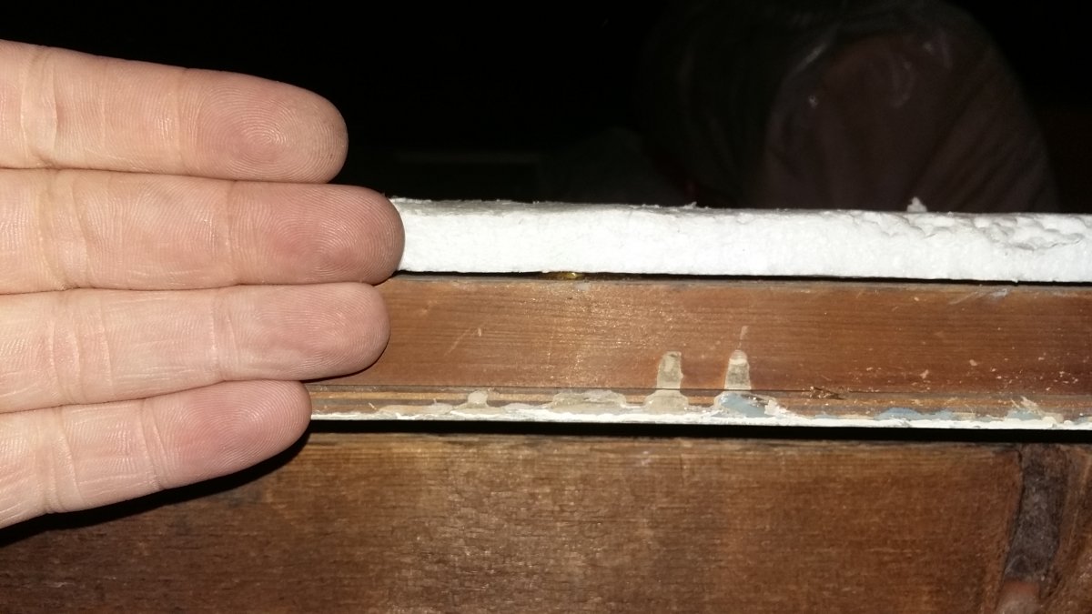

20160826_174243.jpgexcellent insulation on the loft hatch. Width of my finger.

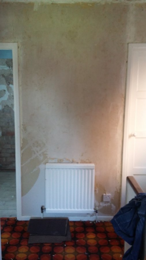

20160829_163915.jpghallway stripping commenced today.

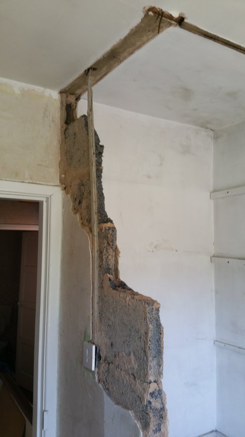

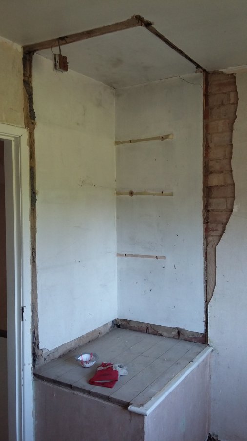

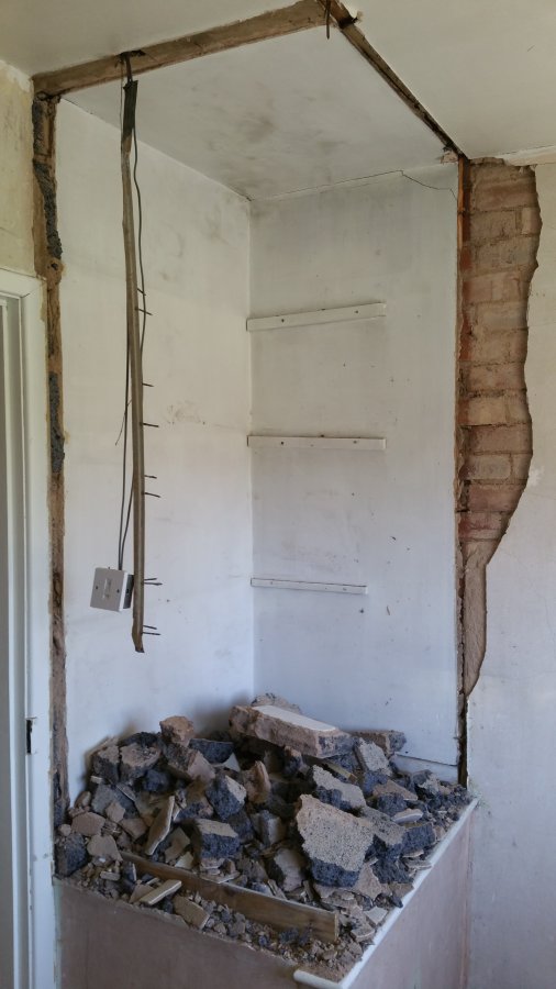

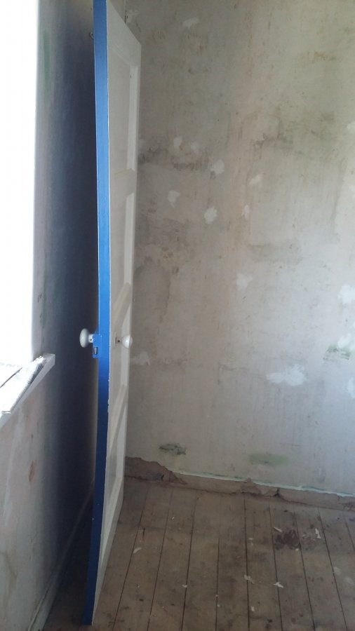

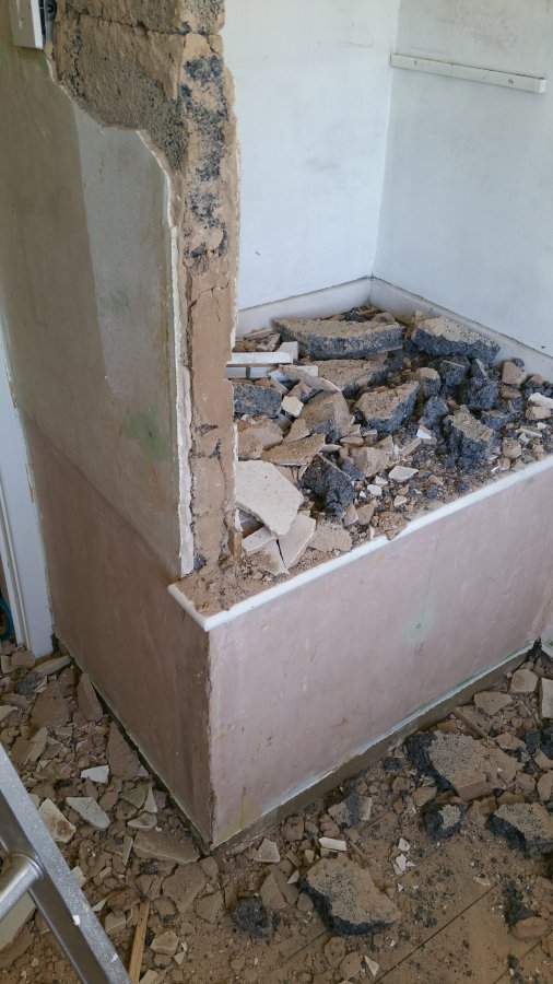

20160829_163925.jpg i knocked down wall no1. This was a cupboard formed by a thermalite block wall and a double door. It is above the bulkhead aboe the stairs, but we decided to open this up to make the box room feel bigger. Not that its a small room for a box room, but the bigger the better! I am a little concerned by the state of the plaster on the adjacent wall. It just seems that if i pull on it it will just fall off. It is cracked and sounds hollow. It may have to be stripped to the brick.

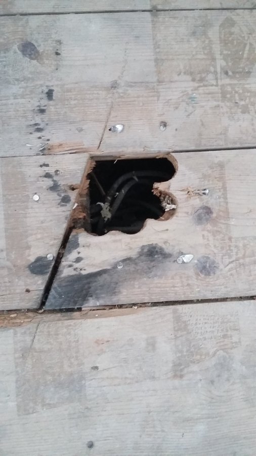

20160829_163936.jpgseriously lazy electricians decided to butcher the adjacent fixed board rather than take it up.

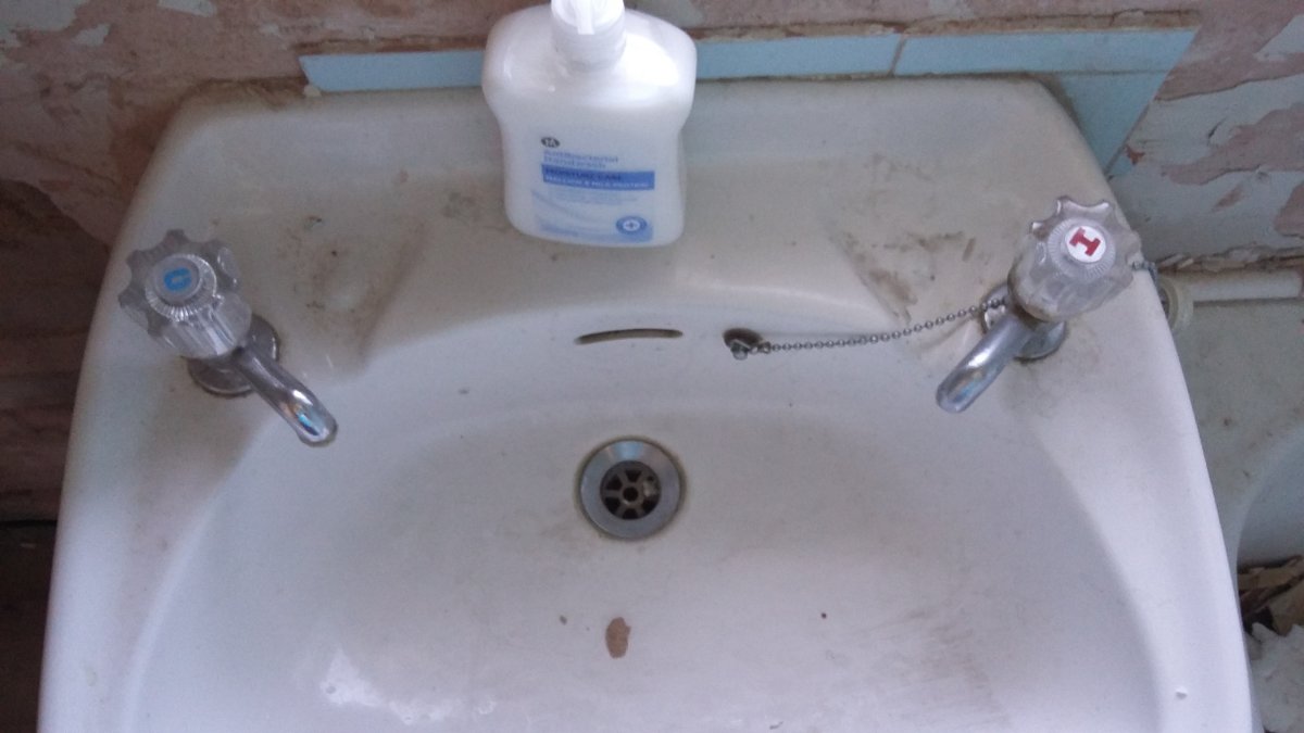

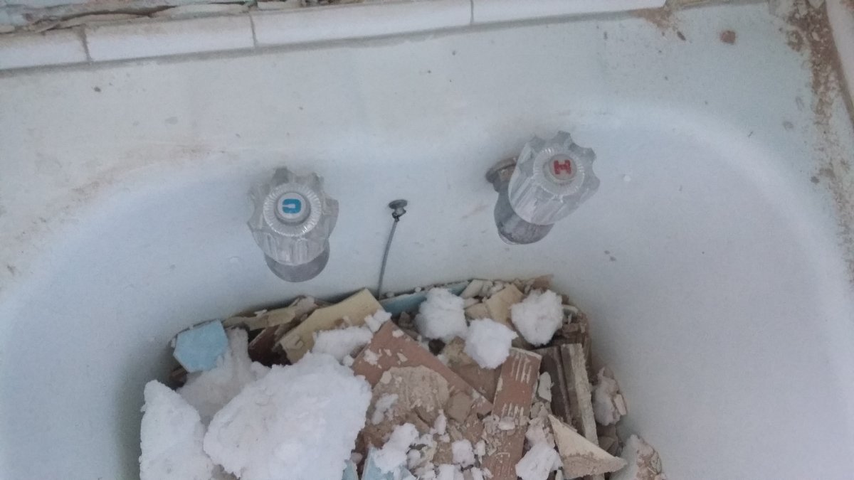

20160829_164112.jpgquestion. Did taps used to be this way round? Both the sink and the bath are this way around. Or has someone messed up here?

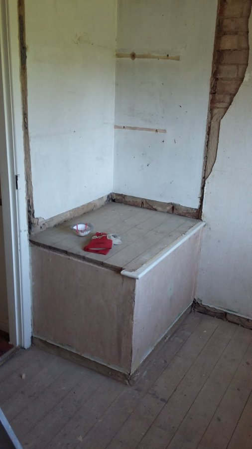

20160829_152208.jpgdone!

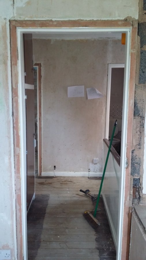

20160831_162416.jpg also took off all the architraves upstairs. I was considering taking off the door linings and renewing. But decided not to because, well, look at the bloody size of them! 2 inch thick! Lucky to get half an inch these days. Also the door linings appear to be integral to the structure of the walls. So they stay.

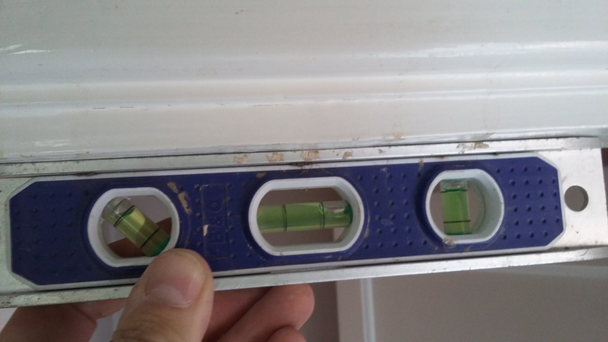

20160831_162509.jpg this was why i wanted to renew them. Only one out of 5 is level, and that one is being boarded up!!
