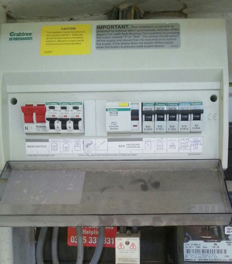

Hello all,
Having a bit of a dilemna at the moment. We're selling our house (2 bed terrace) just now, or rather have sold it, subject to contract. It was rewired about 5 years ago, we haven't got certificates for it, back then I don't think I understood that we should get any. I know better now. As far as I know it was done properly, he was a qualified electrician, and it has been worked on since with no sharp intakes of breath.
Now we are completing documents for our solicitor which include questions about whether it has been rewired and to supply completion certificates etc. I told the buyers it has been rewired, as it has. Solicitor says an indemnity will suffice, but I don't want the buyers, or their mortgage company, getting worried that the place is a death trap.
So what to do? Do I get an electrical installation safety certificate and hope that will be enough to satisfy everyone? Should it? Have I got a bigger problem?
Thanks for reading.
Here's a photo of the consumer unit if it's of any use...
I guess you have no contact details for the guy that did the rewire? He will be able to give you a certificate now, assuming he is legit.
But failing that, an EICR (Electrical Installation Condition Report) is the best you can hope for now
Looking at you consumer unit, it is unlikely that it complied with the regs 5 years ago :(
No, my bad, I just noticed that the first bank of MCBs are actually RCBOs !!!
I was going to say that it was unlikely to comply because of this
Actually I think they were pinched from a small consumer unit that was there already, installed not long before, to run supplies to council fitted oven and shower, which we ripped out when we moved in. We gutted the place and plumber and electrician had an empty, stripped and chased house to work on.
