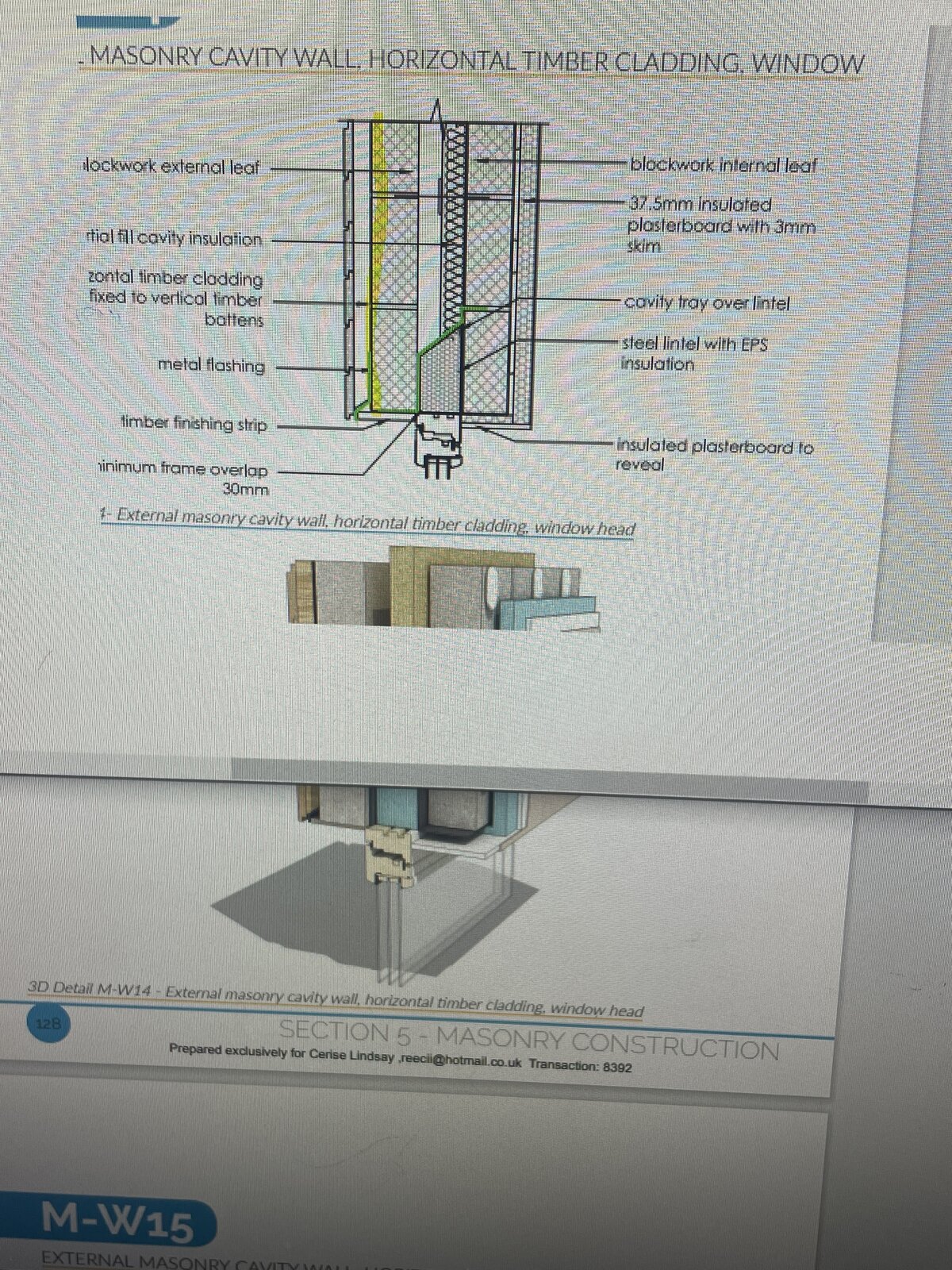

I have blockwork cavity wall with timber cladding does it require breathable membrane as block has high water absorption and is porous. Which I highlighted in yellow
if i render a double skin blockwork cavity wall. Should u install stop render bead around the weep to allow water to drain? which will aslo stain the render
