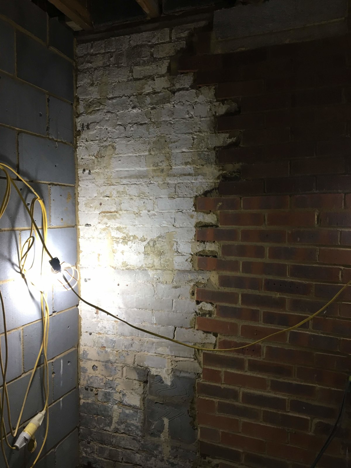

I have an alignment difference where my extension (100mm cavity) meets the original house (approx 75mm cavity). My builder is complaining that the plans didn't have any difference and is looking at a variation$.
How is this best to pack this out?
Is there an issue with leaving it? (it will be behind a kicthen unit)
Is this something I can easily DIY? (Builder would plaster afterwards)
Thanks.
What's going on the walls. I'll assume plasterboard in which case it just needs battening to bring the levels to match. Any builder should do that without question.
Couldn’t you just have your builder plaster/render the painted section after roughing up the surface with a comb chisel maybe?

It would be easy to batten out the wall, plasterboard and then skim.

It's just the 900mm section of wall in the photo, right?
I'd have just lost something that small in the dotndab process, maybe with an extra sheet of plasterboard.
It is an external wall; the builder was planning on plastering the remaining 4m wall. As this is setback by 20mm he can't skim straight over the top of this so wants to charge me to pack/plaster.
Would it be a problem for me to pack out with timber, and then plasterboard up to / just past the wiggly brick line. He can then plaster up to my board.
Would use 9.5mm plasterboard work best (similar thickness to plaster)?
presume its an solid external wall so just SBR the recess twice an then pull it out with 2 coats of lime an sand render.
then 10mm render the whole 4.5m wall an then skim

I think he's saying that it's the 4.5m run that's set back, so it's a bit of a job. If you dont want to pay to batten it and can't win the argument with the builder then I'd probably look for ways of hiding it with a kitchen unit.

but how i see it is the toothed in brickwork is 20mm proud of the white painted recess.
so pull out the recess an then do the whole 4.5 wall ie the 4m run an the .5m recess.

That's what I thought too. Not sure why it can't just be built out with half a bag of bonding coat or thicker render if it's just that part?
Looking at the photo again, it is just that 900mm bit.

I am a low grade DIYer. What is likely to be the easiest way of packing. Batten & plasterboard?
If he's saying it's 20 quid extra then maybe they fair enough. I could have probably mixed up some bonding and levelled it out in the time it's taken to reply to this thread three times :-)

The plans show the existing wall with a thickness that matches the new wall. The new walls have been built 300mm with a 100mm cavity for insulation/building standards. The builder didn't price to pack out the 275mm wall to 300mm to match the new wall.
Therefore I might have a go at saving some cash.
By bonding do you mean that dot/dab will be easier than timber batons. I plan oversail new brickwork by just enough to cover the jagged bricks.
Builder will be plastering the new wall; what thickness do I need to create so that his plaster is level with my plasterboard? 9.5mm? or 12mm?
Will dot/dab be ok to 'fill-out' the 20-25mm 'cavity'?
NB This is a kitchen. There will be a full height unit infront of this; but builder is advising it is still better not to leave as is. Are full heights units usually self supporting off floor, or do i need a baton to attach unit to?
