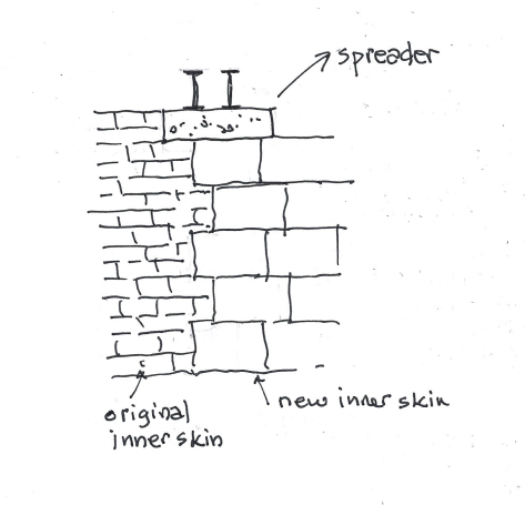

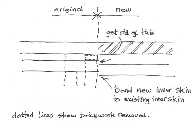

I'm effectively doing the same as this: (cbde picture)
Knocking through, steel on stop of padstone, this is where the cavity was once, there is a gap, I need to brick it up. Suggested to tie the new to old brick work but one cavity is 75mm the other is 100mm.

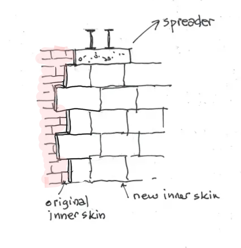

For strength is it better to step the brick work and have 25mm gaps all over or angle the brick ever to slightly? (Tony picture)
The new brick work on the right being 100mm and on the original left being 75mm cavity.

Take the new blockwork past the padstone, and block-bond it in so that the padstone and beam is bearing on the new blockwork and then the load from the beam is properly transferred down along the whole wall not just vertically down the bit below the beam
You are saying step in then from the 75mm to 100mm but bond with the new wall only?

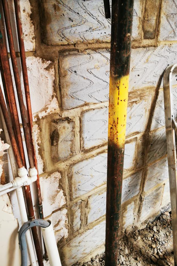

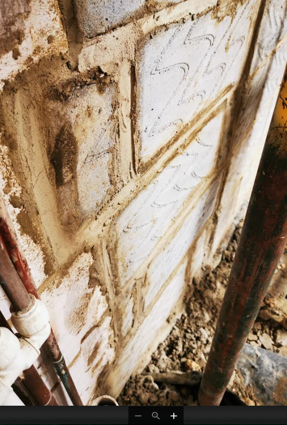

I started a couple of blocks and realised I'm angling the block to suit not stepping in and wondered if it's allowed in the regs, hence asking the question.
You can't really tell from the picture but it's at a slight angle - the best option is to remove this, and step in?
