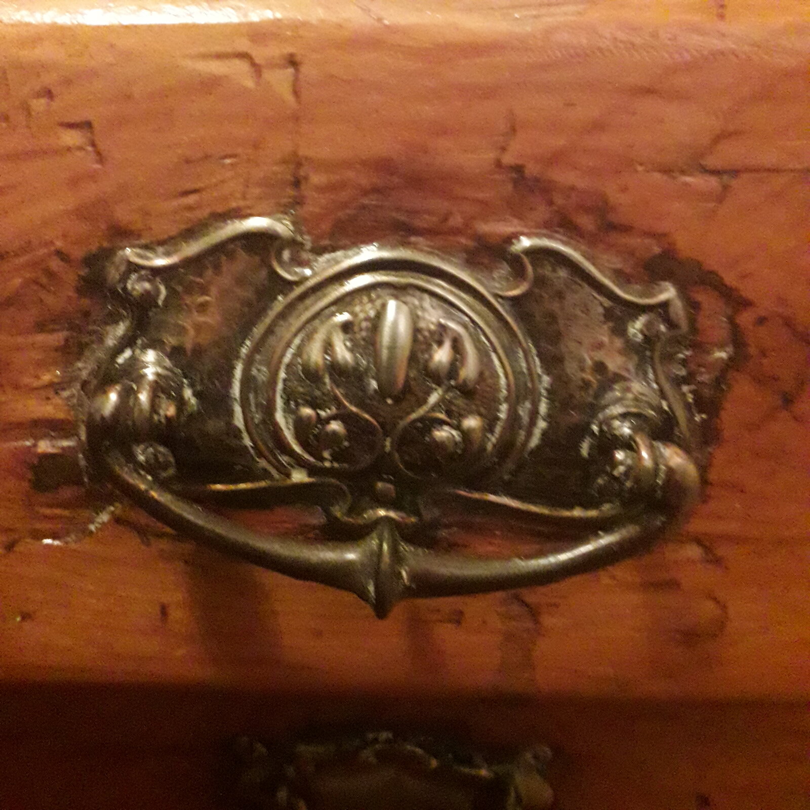

How can i get this screw to stay in?
it would be very useful to see photos of the inside of that drawer-front; and any doors with similar handles.
the nut will not be down the screw hole. It goes on the inside face of the wooden panel.

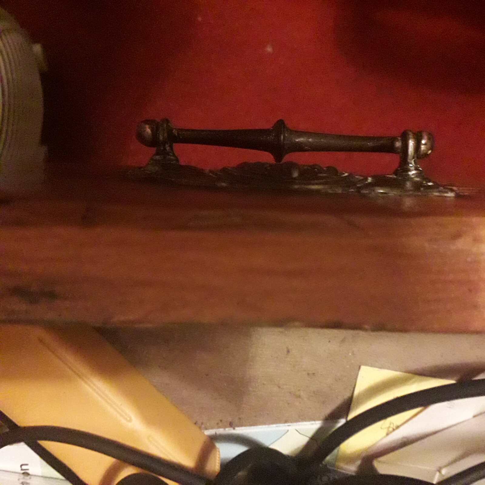

Another handle bird's eye view;

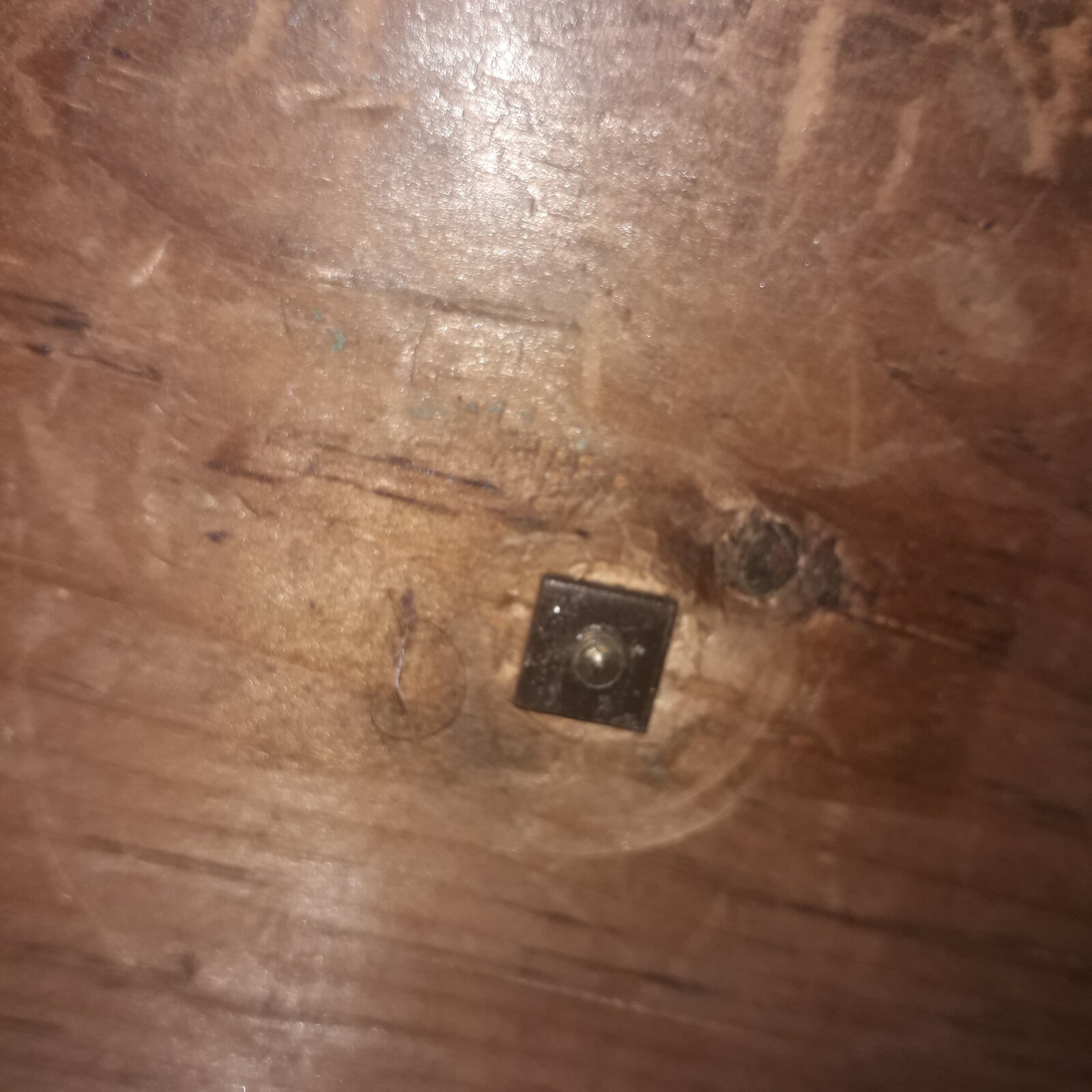

Then I found another one loose amidst the junk of the drawer;
I tightened the two of them from the inside of the drawer with this, thankyou it's all sorted for now and I apologise bit I'm a total beginner;

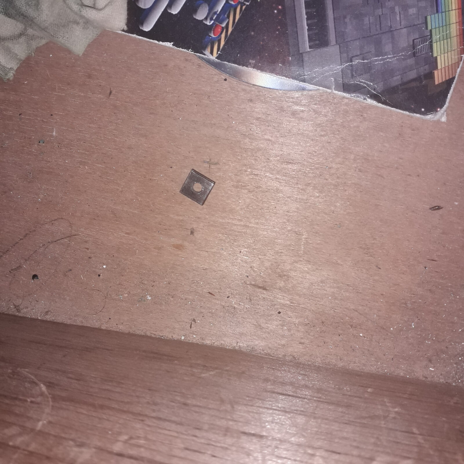

those are the nuts.
for best results, if there is enough spare thread, put a penny washer between the wood and the nut, and put Nutlock or Threadlock on the thread to prevent the nut coming loose.
This square-like piece of metal was loose, I tightened it up ;View attachment 230197
At a guess, that will be an Imperial size and possible 1/4 thread. In which case an old 1/4 inch roofing bolt nut will fit and they are square, just like the one in your photo, so should not look out of place.
Alternatively, a modern 6mm roofing bolt nut, might be persuaded to go on with a bit of brute force.
those are the nuts.
Ok thanks.
