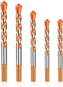

i'm using 6 x 60mm plastic rawlplugs, and a 6mm masonry drill bit, so ive definitely got the right parts here as far as i can tell.
The bit i'm using is like these, with a slightly wider tip at the top that is exactly 6mm, and the main shaft of the bit is slightly narrower

I dont think you said what you are drilling into - brick? also what plugs are you using - some are useless. My favourite are fischer duopower wall plugs
IMO you are expecting too much from your masonry drills. When I find modern wall plugs a tad tight for my patience, I swiftly shave some wood along the grain to make my own slightly tapered plugs and after hammering them home I drill a narrow pilot hole before screwing my fixings home.

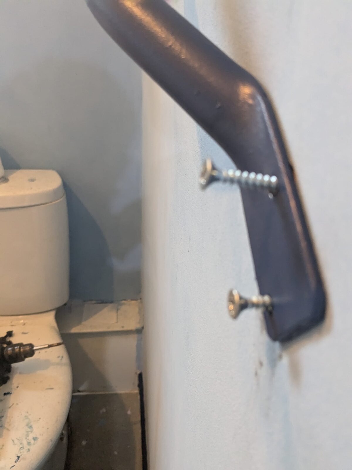

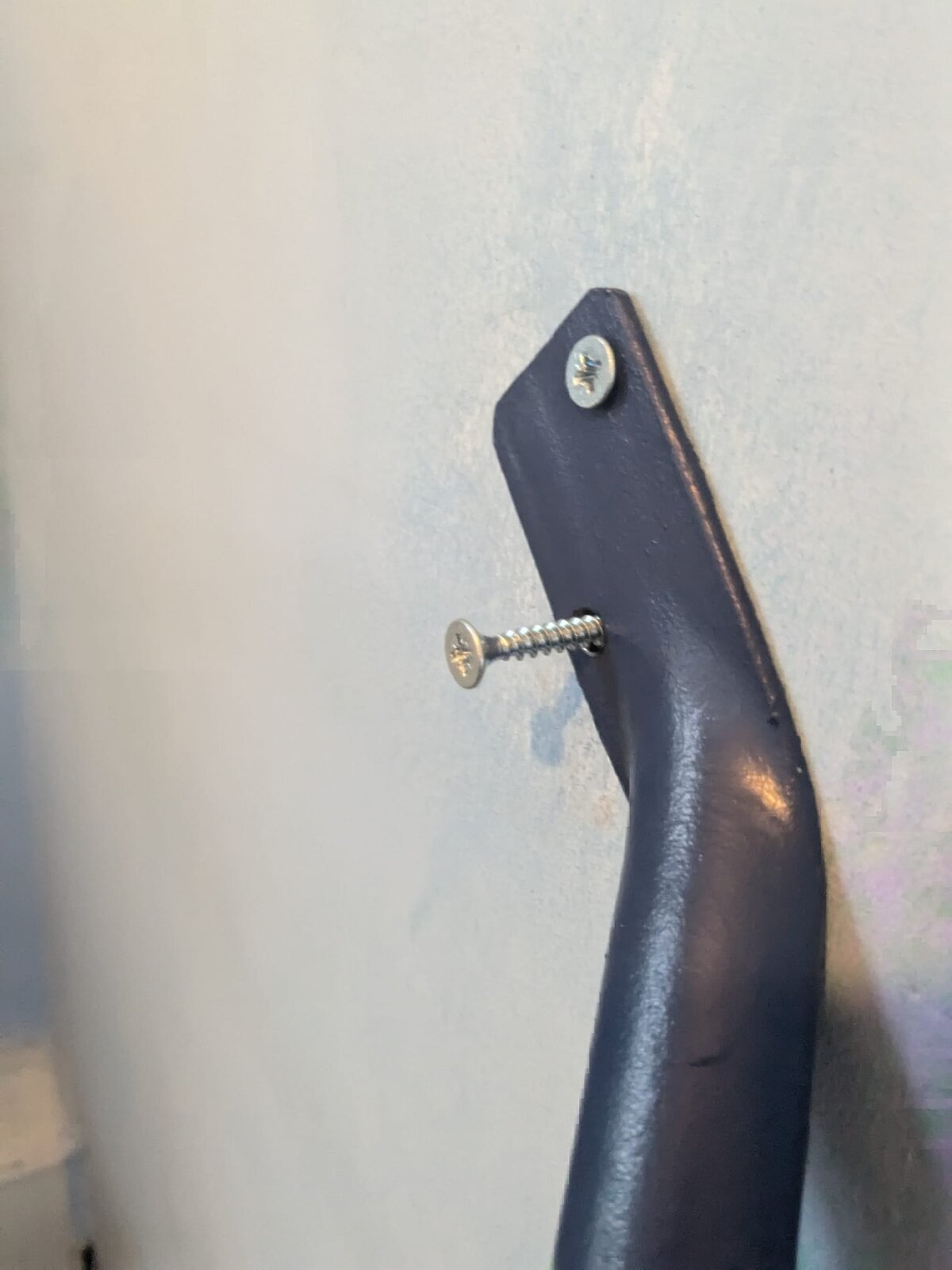

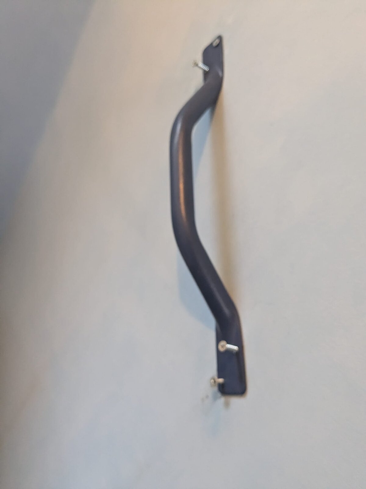

Help!
I'm almost there, a snag has appeared right before victory
I got the fischer plugs and screws i linked earlier, next day delivery, i got out my 8mm drill bit, and bored the same holes slightly larger, i put the plugs in
Like before, they went most of the way and stopped. However unlike before, i was able to tap them the rest of the way with a hammer, because these plugs are really sturdy, great call there burnerman
So then i'm trying to put the screws in, and running into a problem. The screws just won't go all the way. One of them went all the way in because the wall is softer there, possibly damp or a hole in the brickwork, but the other three refuse to go any farther. I'm using a screwdriver attachment on my drill, and leaning my whole bodyweight against it, and setting the speed down low, but either the drill doesn't turn, or it turns in place damaging the + part where it goes in, these screws are not moving
With the depth that they're at though, this grip bar is VERY sturdy, i dont think a team of wild horses could pull it off the wall now, its going nowhere
Should i try to take the screws and plugs out, and re-bore these holes a little more? I',m worried that might cause a repeat of the same issue that made me start this thread though

disregard last post, ive decided to go ahead with the boring, very gradually, its taken an hour of careful re-drilling attempts and testing until i got each plug to a point where the screws can go all the way in, with considerable effort for the last 10mm or so but they go, this should be solid
