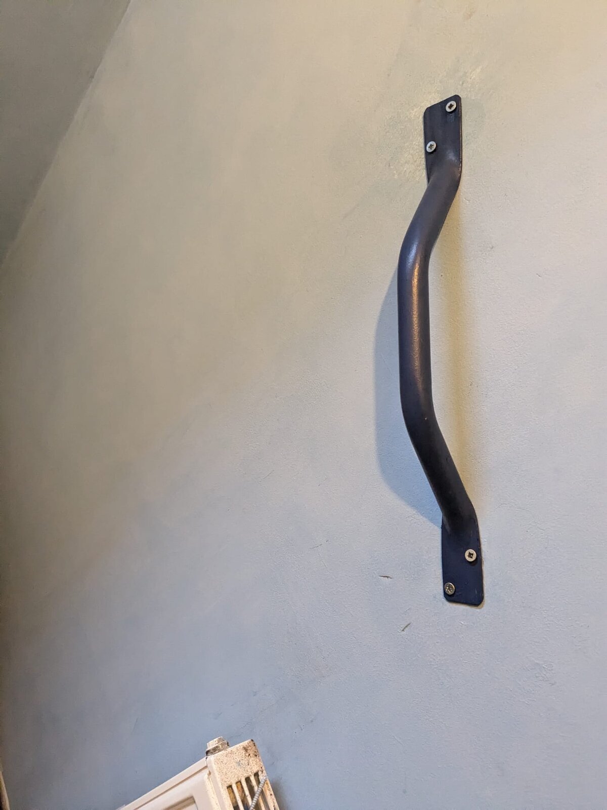

The last few mm of the plug stick out. If i try hammering the plugs in, they just warp and deform, going nowhere, because they are plastic i guess.
Usually because the hole is just not deep enough. You need to drill the hole, deep enough, that the entire plug goes through the plaster, into the brick, then allow some extra for the dust to compact, in the hole, beyond the plug.
You should never let the inserted plug finish flush with the surface if plastered - it should always be inserted deeper, usually by using a screw or punch (the tip of which is the same size as the plug head) to finish at the brick face. Drill the hole 5 to 10mm deeper than the plug is long. It doesn't matter if the screw passes past the end of the plug.
Bit of vaseline on the screw or scrape across a wet bar of soap, we used to use tallow in the old days.
You should be drilling 6-10mm longer than screw or it will bind.
no worries about this, i don't even bother measuring when i'm going into a wall, i just go the entire length of the drill bit, which in this case is about 150% of the length of the plug, plenty of space
enough, in fact, that one of my plugs has slipped farther inside a bit, i dont see any problem with this, that just means more of it is in masonry instead of plaster, and it holds firm
but then why do plugs come with a little lip designed to prevent exactly this? Even the fischer ones
with considerable effort for the last 10mm or so
It sounds like you have actually reached the brick, rather than just the plaster.
For anything substantial, including these handles you are fitting, you do need to fix into the brick. The plaster is much weaker. Get screws that are long enough, and drill holes that are deep enough. Push the plugs in so they are at least mostly in the brick.

i'm pretty sure the screws were sticking because the plug couldn't expand anymore, but i guess lubricating them might be worth a try, i have a silicone lubricant spray i bought for door hinges, and some WD40, they'd probably do the trick right?
Are there any pitfalls or gotchas to worry about when lubricating screws? It seems like anything that makes them go in easier, would also make them come out easier?
nah i always drill into brick now, i learned this lesson a while back, and thats why i don't use any screw+plug shorter than 60mm these days
its just that there wasnt enough space for the plug to expand, i needed to widedn the hole a tiny bit
Well i have finally managed it, the grip bar now now securely mounted with four 8x65mm screws, it does not move under strain, i'm happy with this.
I did use lubrication on the screws, i'm not sure if it helped
