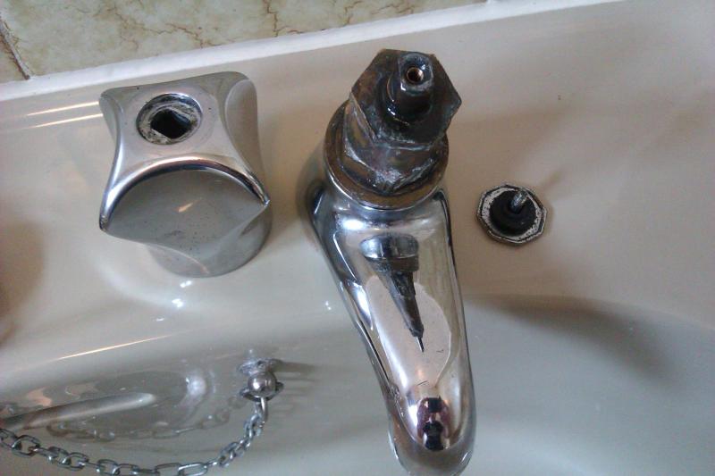

How Do I Remove This Tap
You gonna need a few things to do, keep tapping up and sideways, and keep saying halilujah :) it will come off its just scaled together.
Oh I forgot a bucket full of perseverence.

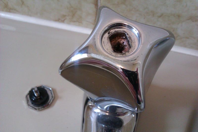

Thanks again for the help so far. Here are a couple more pics. The first one show the cold tap, taken apart obviously, the second pic is the hot tap, tried again using the various methods as advised, there us just no movement or give at all.
If you can undo the retaining nut below the basin a little that should allow you to pull the tap away from the basin by half an inch or so (pipe work allowing).
If you can do that you would then be able to screw the top screw back in a few turns and while holding the tap up by the cap, tap downwards on the top scew. A couple of sharp taps with something that won't mark it should do it.
Have you got something that will fit fairly snug in the top, then get someone to tap it down while you pull up
After all this if it still isn't budging, I'd isolate the hot tap and remove it from the sink and then you can set about it without fear of damage to the sink.

I wouldn't really want to damage the small threaded cap, as that is what keeps the top in place (when it's not stuck solid that is). And sticking it together with silicone would cause me grief next time I need to get at it.
Well, if you can't get the head off, it's new tap time, which means removing taps. If you have to remove taps anyway, why don't you take the hot tap off to work on it? It's what you're going to have to do anyway if you resort to new taps.
