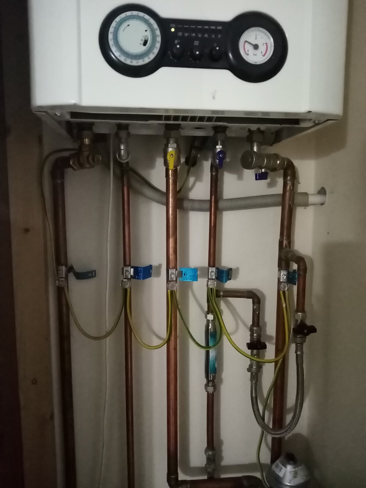

How do I repressurise a Heat line Vizo 24?
25 Jan 2021
2
The boiler won't ignite and the pressure gauge is just below 1. I've watched loads of YouTube videos on how to increase the pressure, but I can't find a video that shows a boiler like mine. Can anyone help me?
Turn the two black handles where the silver braided hose is on the bottom right. Turn them 90 degrees so they are in line with the pipework/valves..
