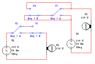

2 way lighting. There is a feed and 3core strapper at one switch and the switch wire and strapper in the other. How can this be connected up to function?

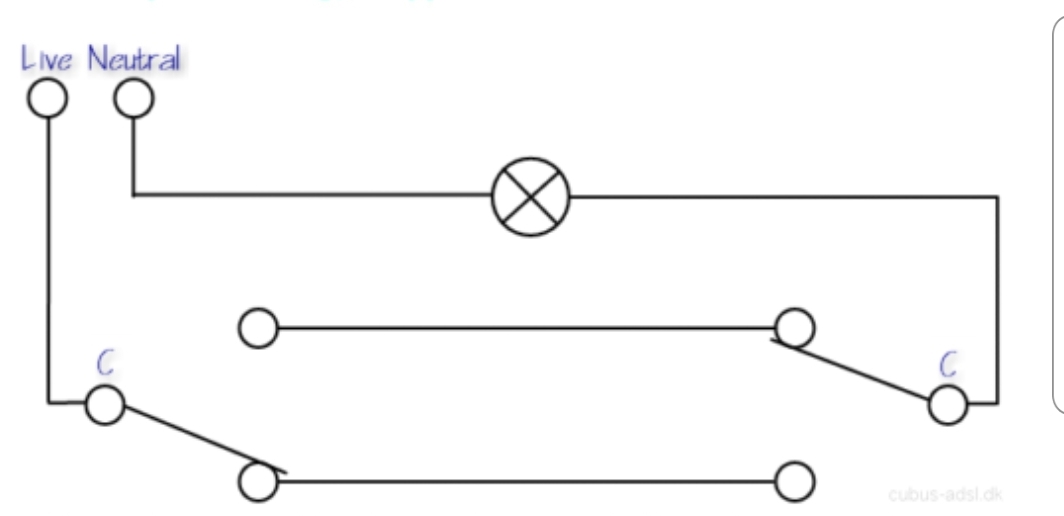

2 way lighting. 3 core strapper and feed at one switch. Switch wire and strapper at other switch. How can this be connected to function?
My switch wire and feed are at separate switches, this diagram shows feed and sw at same switch. So my feed is at the first switch and my switch wire is at the second switch
I assume you are replacing switches, how are the existing wired?
There is more than one way to install 2 way switching.
Bottom left needs a connector block in switch top right does not, which is main reason to use top right.
