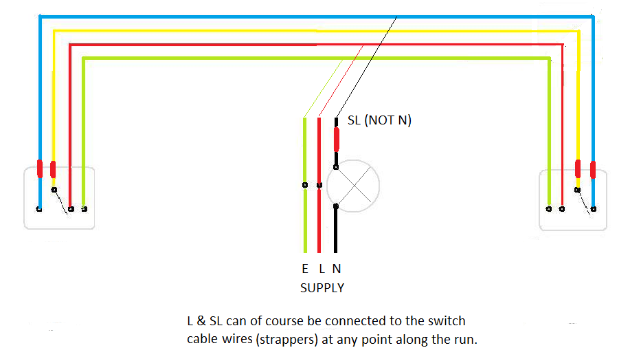

This might help people understand what aesmith had in mind.
Old colours; that's all I had available.
That's exactly what I meant.

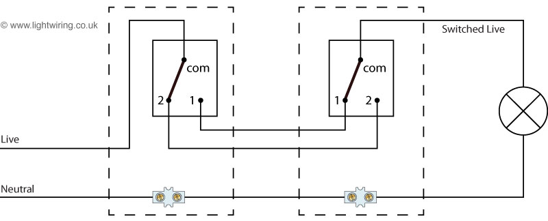

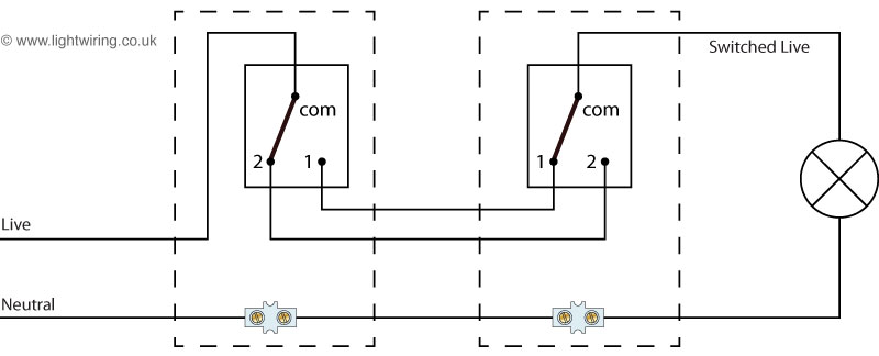

And regarding terminal blocks for N, grabbed from another site. And I think if feed and light were connected to the same switch, you'd still need one block to connect N ..
Yes, of course, if you did it like that you would need blocks for the neutral.
You do need blocks for the neutrals with loop at switch method (which the diagram is really - without continuing the circuit) and of course one at the light (ceiling rose) for loop at light method with which there are no neutrals at the switches.
I think if we imagine the loop in at ceiling rose method where the switchwire is T & E from the rose to a one way switch then substitute that switch drop T & E for 3C&E we can now introduce a N at the switch position whilst already have an N at the rose position.
Similarly for two way we use one 3C&E as the switchwire as described above and the strapper 3C&E from switch 1 to switch 2.
If either or both are 2,3,4 or 6 gang switches then it starts to look even more complicated but does have the benefit of having N at both the rose and the switch positions if needed and whilst it can be technically correct it tends to add another complication for the unwary.
I think this could be what EFLImpudance eluded to a while back.

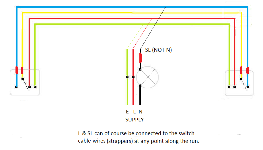

This is what I use as convention but I saw a variation in my friend's house where the ceiling rose was used as the connection point for the strappers - i.e. L / SL but the wiring was run in twin and earth so no common visible. Had me foxed for a while until I moved some wiring and found a single an earth used as the COM connected in a terminal block.
The old wiring in our garage/workshop used twin with no earth, plus various single core sheathed cables to provide enough cores. Earthing for the metal switches was provided by a fly lead from the adjacent power point. Where I retained two way switching I replaced the drop cables with three core exactly like EFL showed. Like him I used old colours as that was all I had available.
