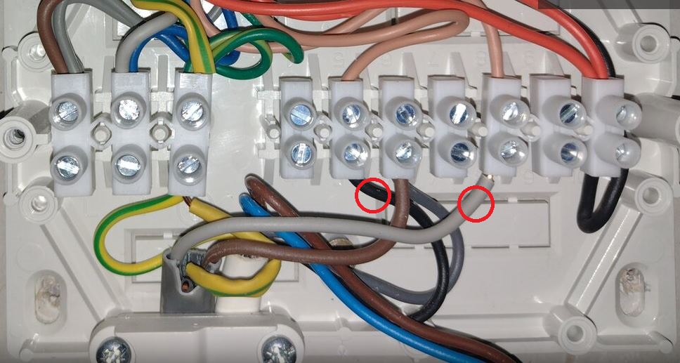

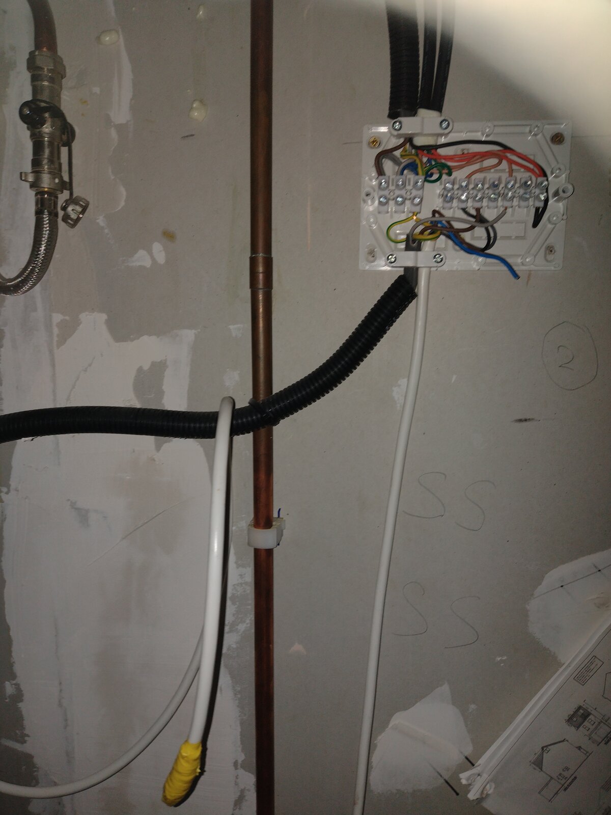

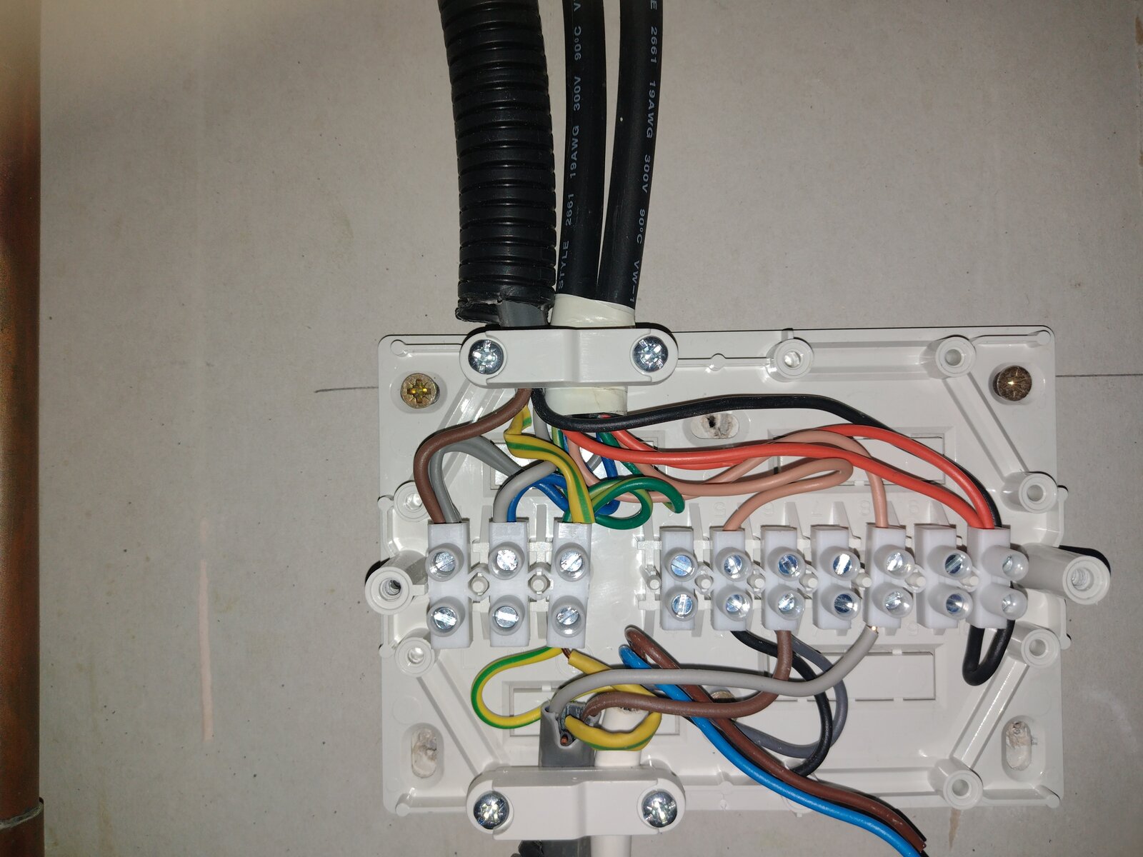

I have uploaded images of my setup.. can someone advise on how to wire up the nest?

I do not have a programmer.
This is a new set up and I was told, all I had to do was install the nest and job done...
I am comfortable installing the nest to a combi boiler, but I have never fitted one to system boiler/unvented cylinder set up before..
Do you need any specific pics of my set-up?
I could be wrong, but you may need to have knowledge of G3/unvented systems before wiring up for hot water.
Which sound a bit odd to me, because the two cables entering the top right appear to be from the motorised valves and if so, the wires that would be normally be connected to the programmer or Nest, look to already be connected something.
However, I think @CBW is right, unvented systems do also have additional requirements that should be checked. As it's a new system the installer who will be an RGI is responsibe for completingthe installation and informing the local authority that the installation complies to the regulations and provide a Building Regulations Compliance Certificate.
