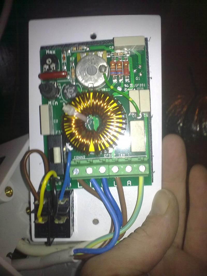

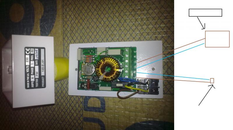

can anyone help me wire this up to my fan,as i carnt find anything on the net,been looking for weeks now,
took it to a shop but the guy wasent to sure,so i left,after he started messing about with it lol.on the first pic is how i think it should be wired up,brown 1st and blue 2nd,going to mains plug,then blue and brown going to fan.?
thanks mate ,but still carnt get my head around it.as mine only has
L.N.U2.U1.A.E.
i was thinking L and N to mains plug.and u2 and u1 to fan, u2 neutral and u1 to live.

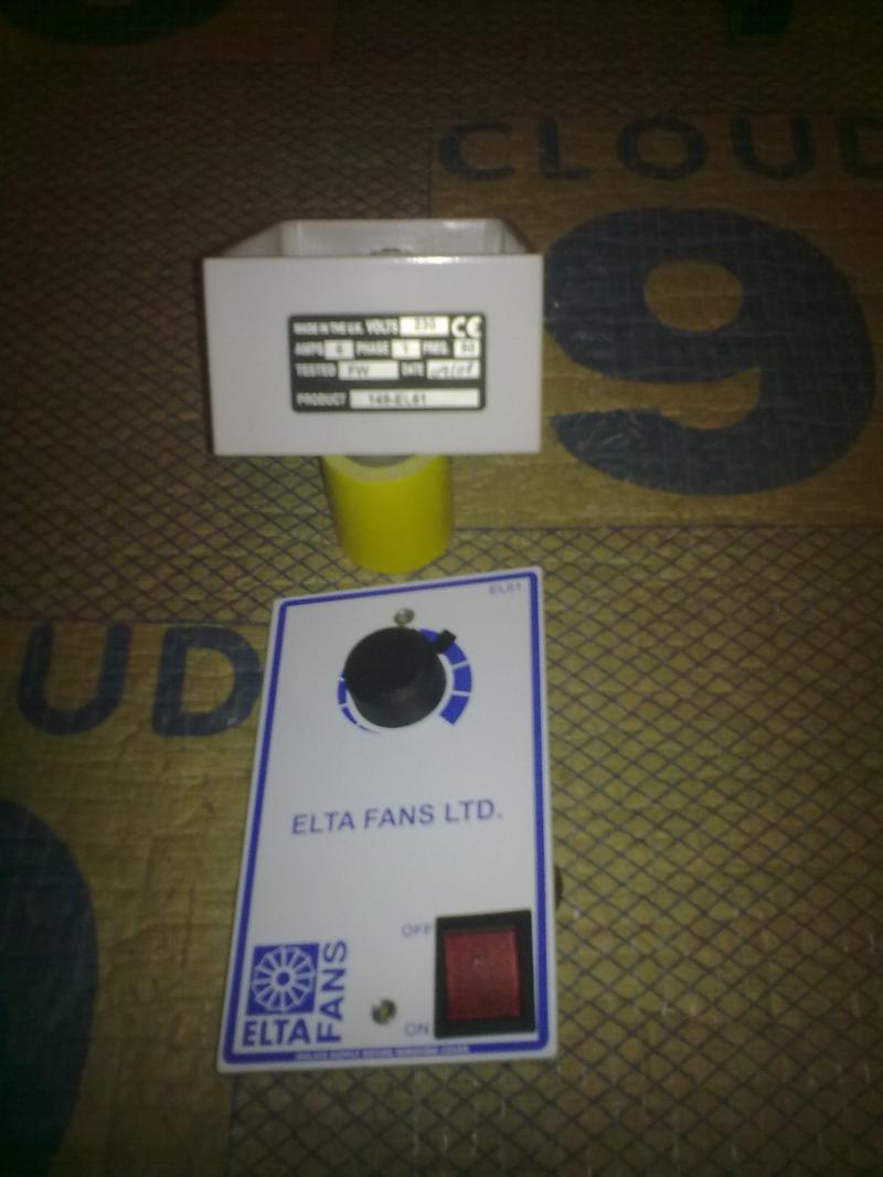

http://www.eltafans.com/non-select/wiring/lc_sc_range_1_dol.pdf#search="149-EL61"
took me all of 30 seconde to get that..
googled "elta fans" then put the product number in their search box as visible from the picture (149-EL61)..
thanks must of over looked that on there web site,lol,so i think this is right , ? when running the fan slow the vibraion is so bad also its louder than when run on full power, that carnt be right ,can it lol

yeh the HIGH'max is set at half and the MIN half all so,is there a way to set the max and min..?cheers ps i think the balance on the fan is ok.
You only have one earth wire - where is the earth from the other flex?
