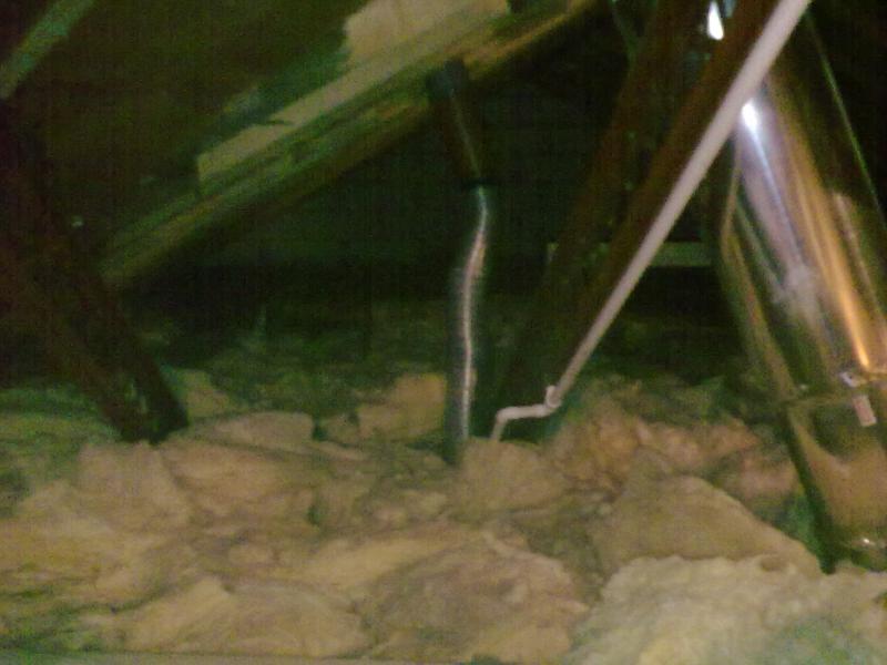

So next off up in the loft where I needed to connect to the soil pipe to run away the boiler condensate . I find this:
Now the picture isn't that great but what the guy had done was extend the soil pipe by using a short length of Kopex flue liner. Genius.

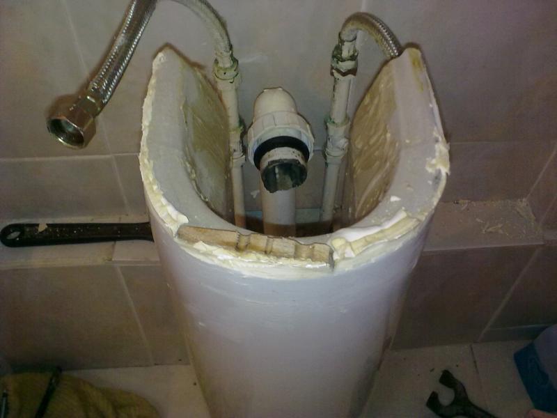

And last but not least by favorite by far. The customer asked me to change the basin taps and waste, so I set about splitting the basin (which wasn't screwed to the wall, just siliconed) from the pedastal (which was tiled solid into the floor) and guess what I found?
Yep that is right. Half a clothes peg keeping the basin level.
I sometimes lay awake worrying about how I have left jobs, but how people sleep after leaving stuff like this is well beyond me.
