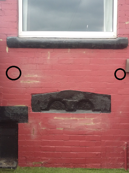

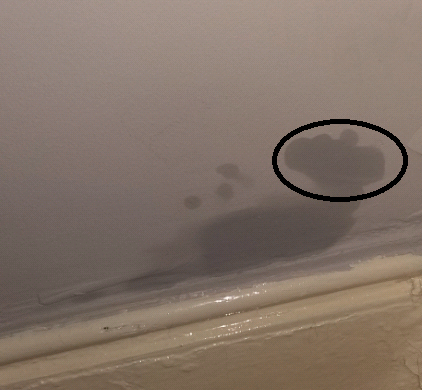

I was thinking I had attached pictures already.
Here is the pictures of the problems and the attempted fixes so far:
This is the first mark that appeared. This now only appears in the area I have highlighted.
I have had the virgin media box on the left removed now and this area never has a problem. The area I have circled is where the mark appears but it is never bigger than this.

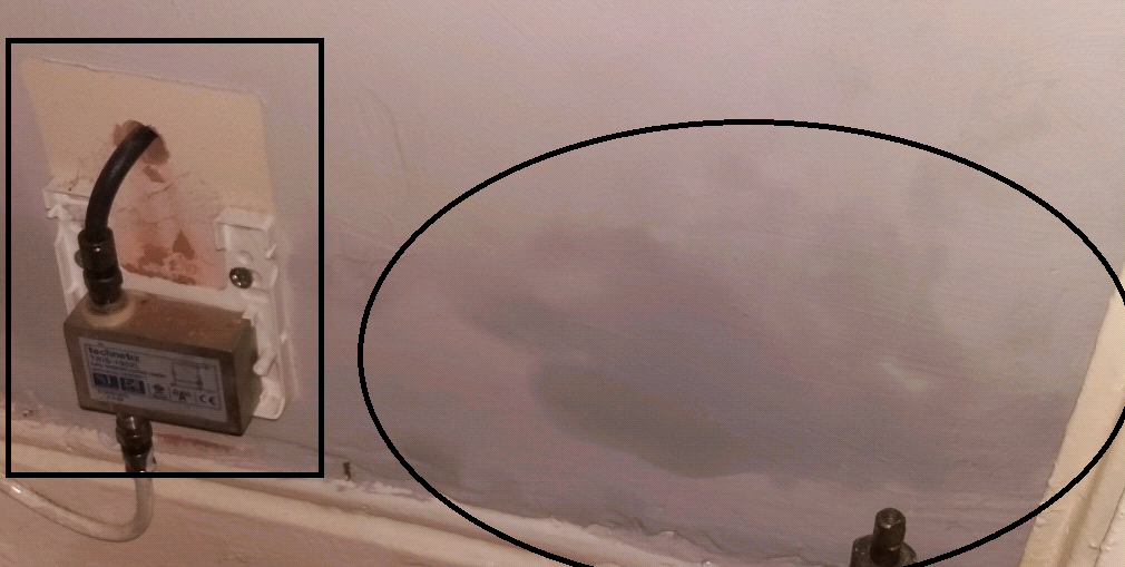

This is the patch pointing work we have had done and also the window that we have had resealed. I have circled the areas that the marks appear on the inside wall for reference. (The virgin media box is now removed and the hole filled with mortar.

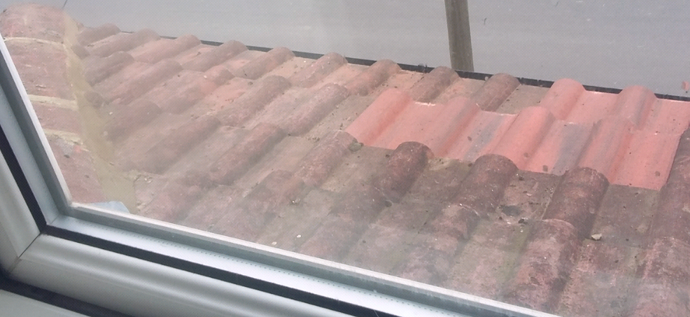

This is the bay window roof that we have had new eaves trays and felt installed and all the broken tiles removed and replaced.
