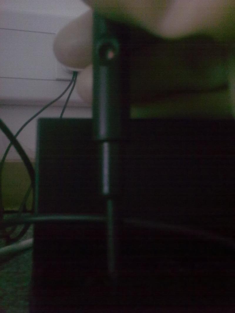

A practical demonstration, 1000V gloves on, neon is on the Live terminal of a meter on my bench. You can just make out the glow of the Neon.
We use these when installing meters as they are deemed the only instrument to prove polarity. We also use them to check all extraneous conductive parts and conductive parts are not live before we touch anything but after this we then use a test lamp to double check.
