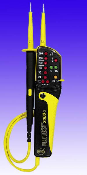

I am relativley new to these boards & to DIY and over the last couple of months I have been reading the top notch advice given by seasoned posters.
One of the things I have noticed is the repeated recommendation to NOT use a neon screwdriver to test a circuit is dead before working on it.
My question is why? :confused: I'm not stating that the advice is wrong but simply want to clear up why because over the years I have always used only a neon screwdriver to test dead. What should I use instead? i don't want a belt one day when I could have easily avoided it.
Please advise. Thanks
Neon screwrivers rely on your body providing a path for the current to flow from Phase through the neon and eventually to earth. It limits this current using a resistor but if your resistance to earth is also very high then the neon may not light up, as as soon as the resistor is removed from the circuit your resistance to earth suddenly drops and you are in a potentially lethal situation.
It is also quite hard to see the neon glow in bright light, so it's easy to mistake a positive test for a negative.
Then you have the chance that the resistor will fail due to being damaged.
Add to that the fact that they are crap screwdrivers and it soon becomes appararent that nobody should waste their money on them :LOL:
The only item recommended for proving dead is an approved test lamp or voltage indicator.

As good as the Flukes are, unless you first test Line to Neutral, Line to Earth trips 30mA RCDs...
Must admit, I've not tried it with the breaker off. Need to try it.
Also, whenever I need to be sure 100%, I always reach for the Martindale. Maybe it's just habit but I'd like to think it's confidence.

What I would like to know (in the same spirit as the OP) is how do you prove that the earth is sound when you use a test lamp or other more sophisticated device? You may not be able to test it using a known live source (too far away) so you could get a false reading.
Your proving unit tells you that your tester is working.
If the tester lights up between L&N but not L&E.....
Use an Earth Fault Loop Impedance meter.

You have to use the means of isolation to energise the circuit in order to be sure that that means of isolation can then isolate it.
You could energise then test then deenergise and test again but that isn't always practical (e.g. some part of the circuit may not be in a safe state to energise)
In that case you have to use a wander lead to a known earth in order to prove that the circuit you're working on isn't energised.
Clearly you would test the wander lead before trusting it...
