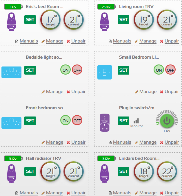

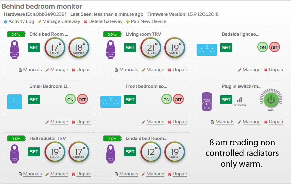

So this morning readings are
So with central heating off her room (Linda's bed room) does cool down, however not as much as mine (Eric's bed Room) but her room is above Living room which is set higher, so heat could raise through ceiling and floor, so latter in the day we get
where her room is much hotter than set, I have dropped hall temperature, to 19°C and her room to 12°C and swapped spacer from thick to thin in her room, to change set to 36°C and could see and hear plunger retract, on replacing set to 12°C and could hear motor run and last few seconds seemed to strain so assume is hard down, before changing spacer her radiator stayed just warm when heating running, since changing heating has hardly run, so I test bathroom radiator first with no TRV and that one has always been cold each time came to test so feeling one in bedroom pointless it will be cold as boiler not running.
So could be some thing silly like her using a trouser press, but since able to monitor her room as she had complained always seems to be too hot when heating running, so now looking at mechanical part of valve, so if radiator just warm is that a fault or normal? Could fact that her valve has been closed for a long time be a problem with poor seating, and now valve is exercised once a week at 10:30 am on a Monday will it improve.

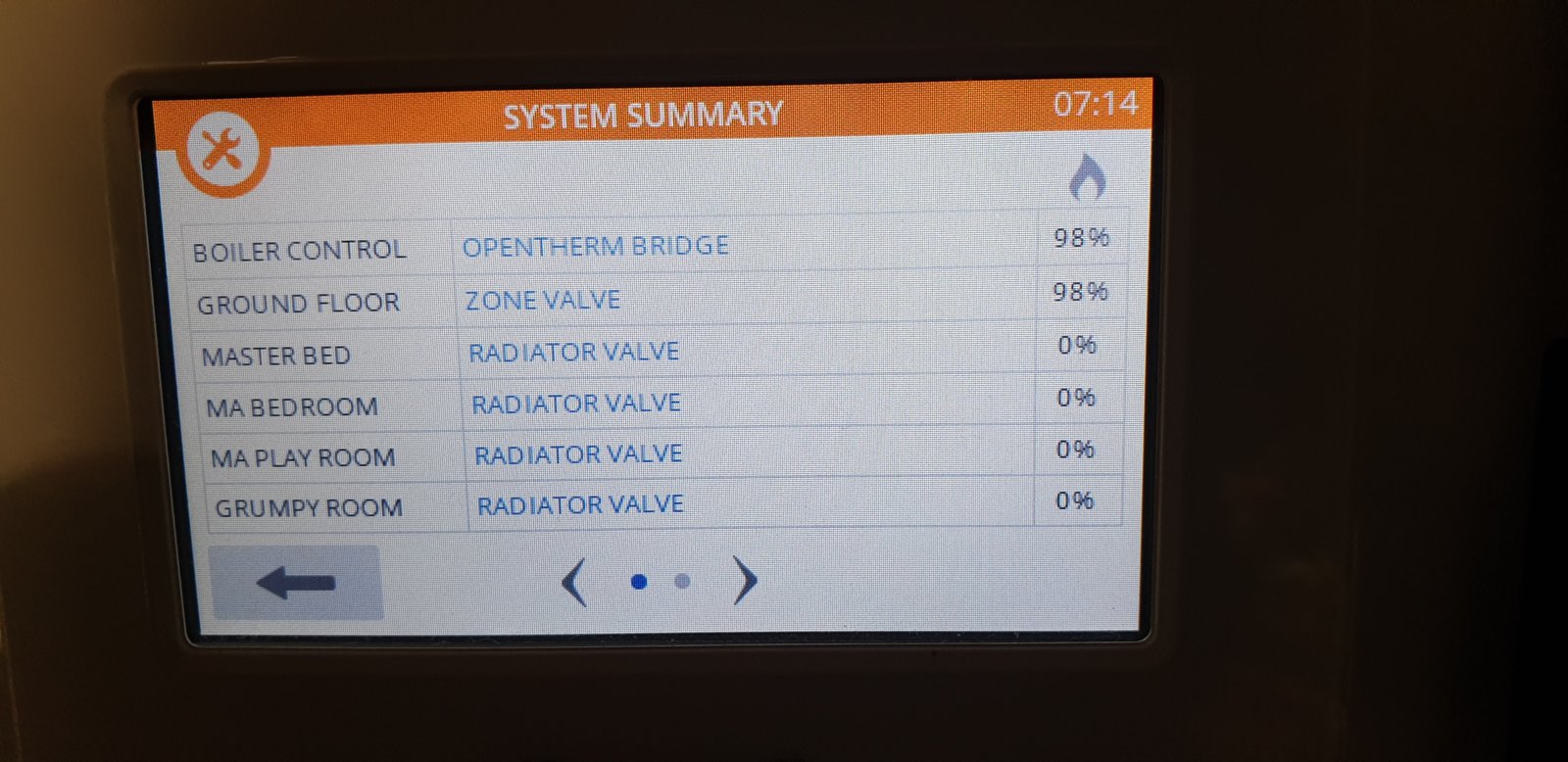

Not true dude (partly). The valve will position itself where the flow is correct for the amount of heat required. On hr92's there is a setting that tends you as a percentage where the valve is.. The last firmware update askari gives you this positioning on the main controller :
