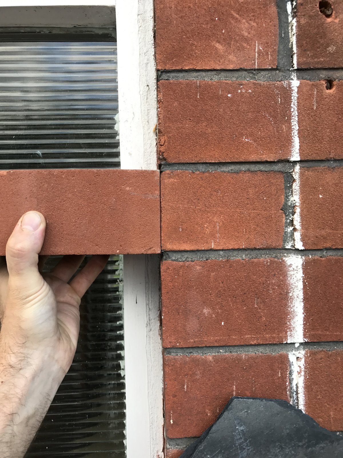

I think I just found a good match for the bricks on my house too, Ibstock Aston Red Sandfaced 73mm. Just need to find them in stock somewhere so I can pinch a sample.
Very pleased with the match!!!
