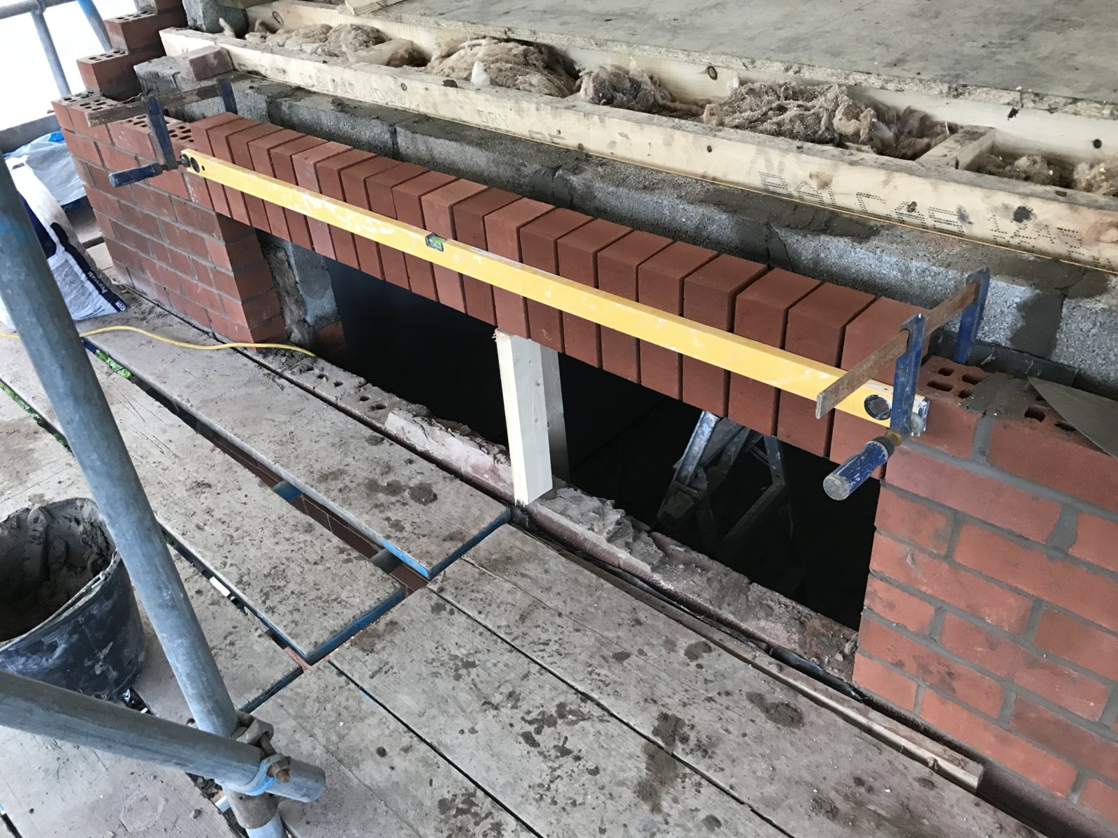

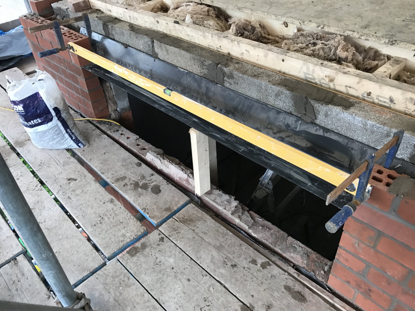

If you look at the first and second images above you can see the bricks I used to weight the tops of the headers to prevent them from tipping forwards. Bloody pain!

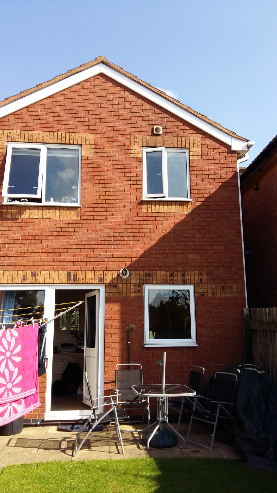

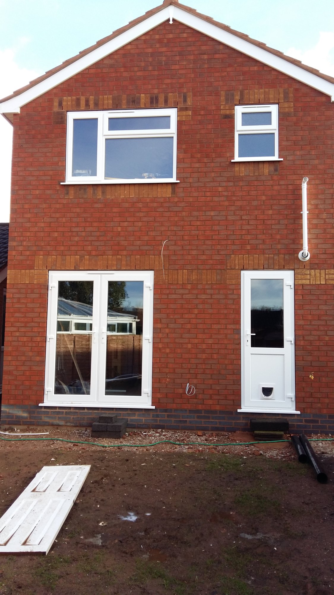

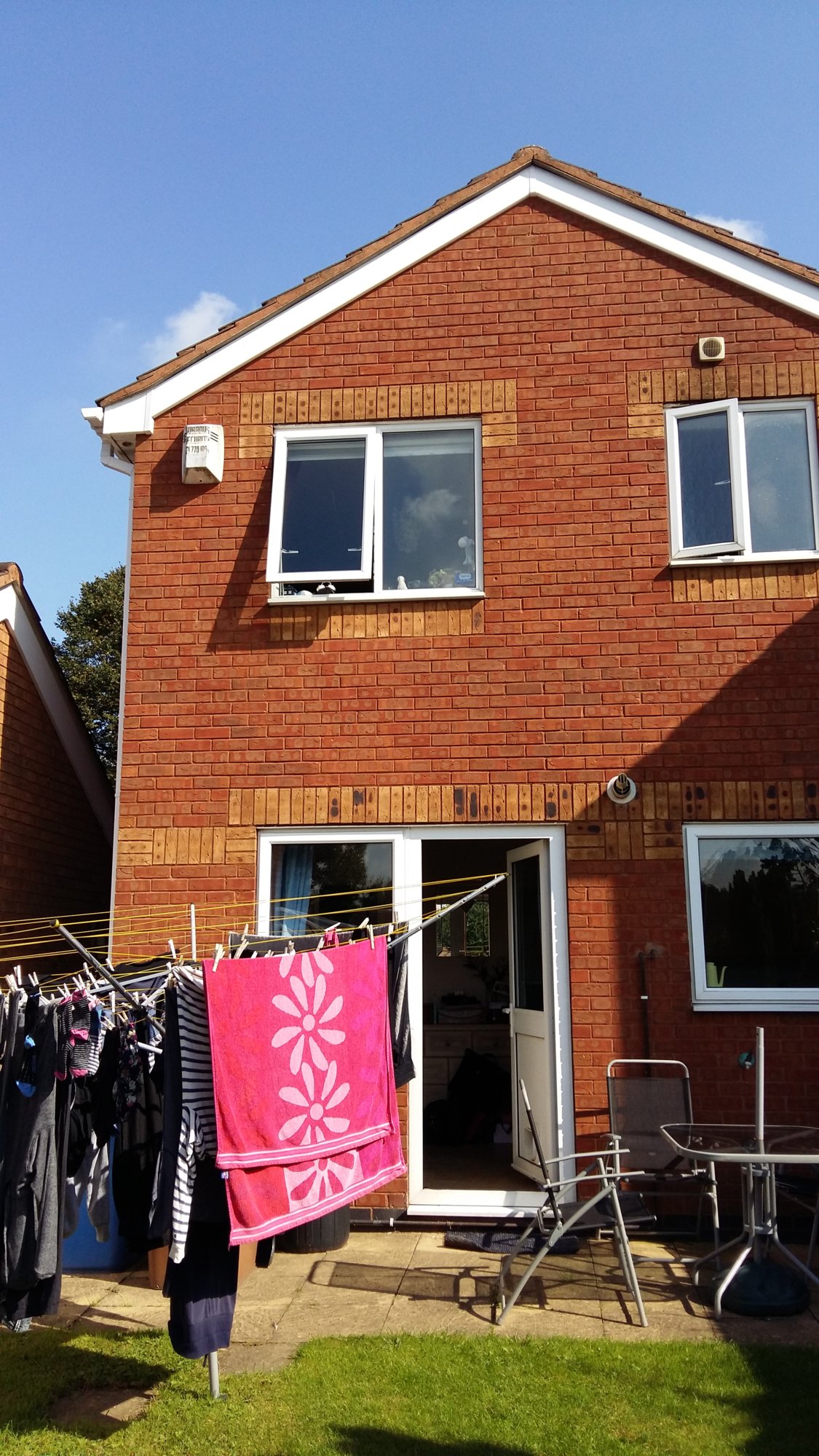

Before.........

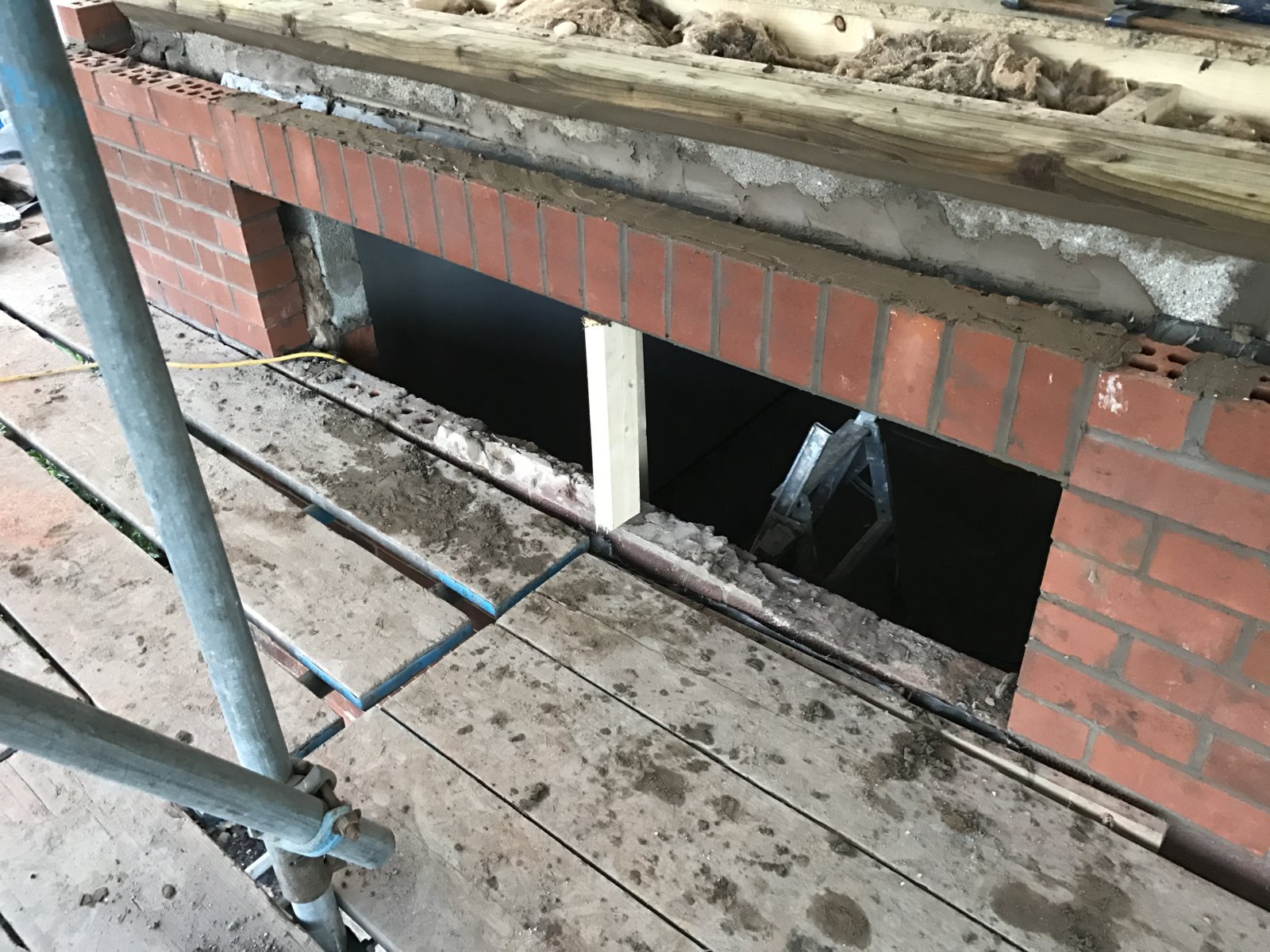

After.......(spoiled by an uncaring plumber:sneaky:).......

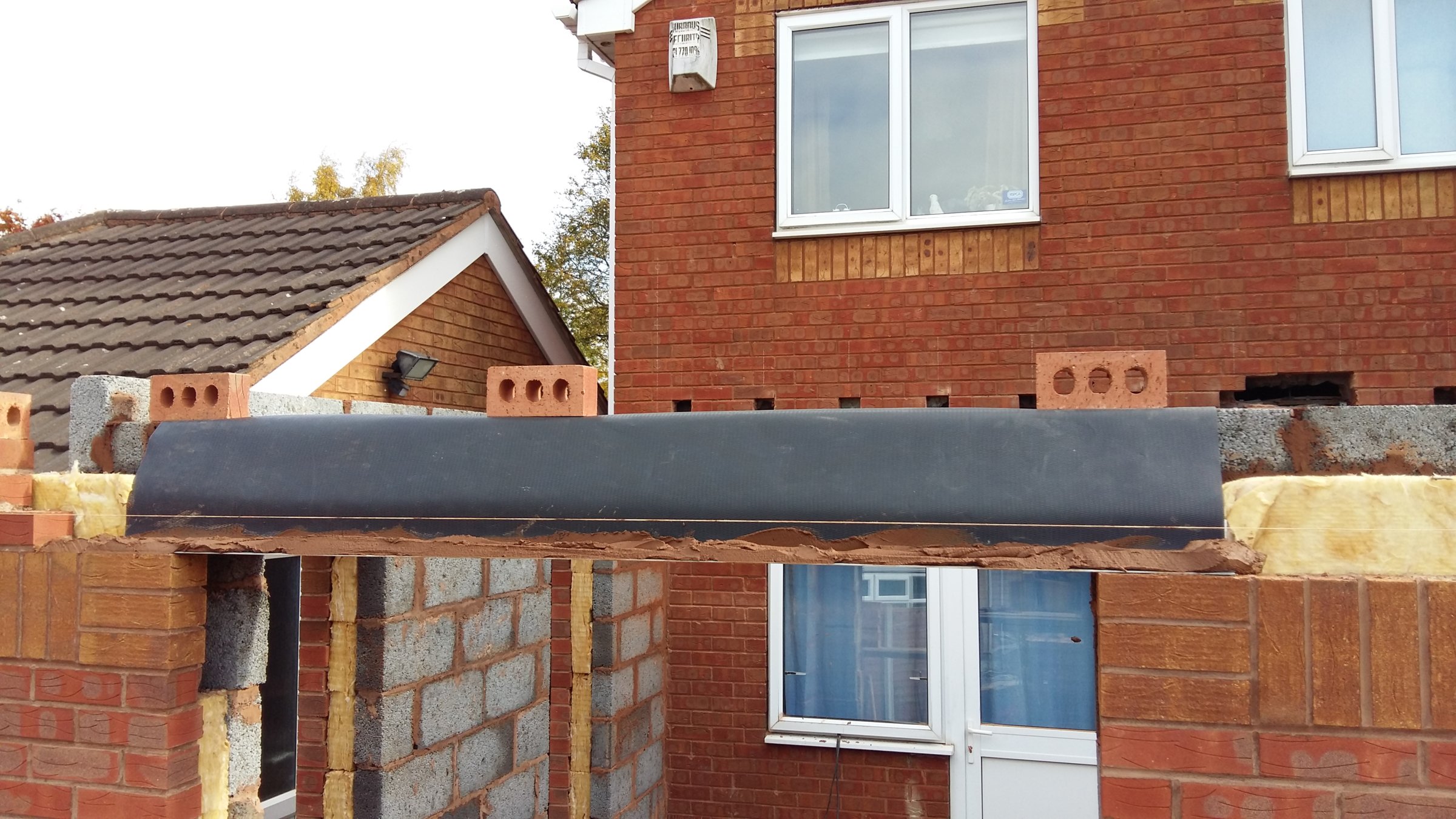

You’re worrying me now, because I did a soldier course (albeit a short one) and used a line like normal and nothing tried to tip forwards. That was on one of the black catnics with a flat edge at the front. However later when I used a different lintel with a downward sloping front lip, I had a mare with bricks wanting to tip forwards and it wasn’t even a soldier course
You can always use a straight piece of batten wedged between the jambs, which catches the edge of the bricks and you can also mark the gauge on.

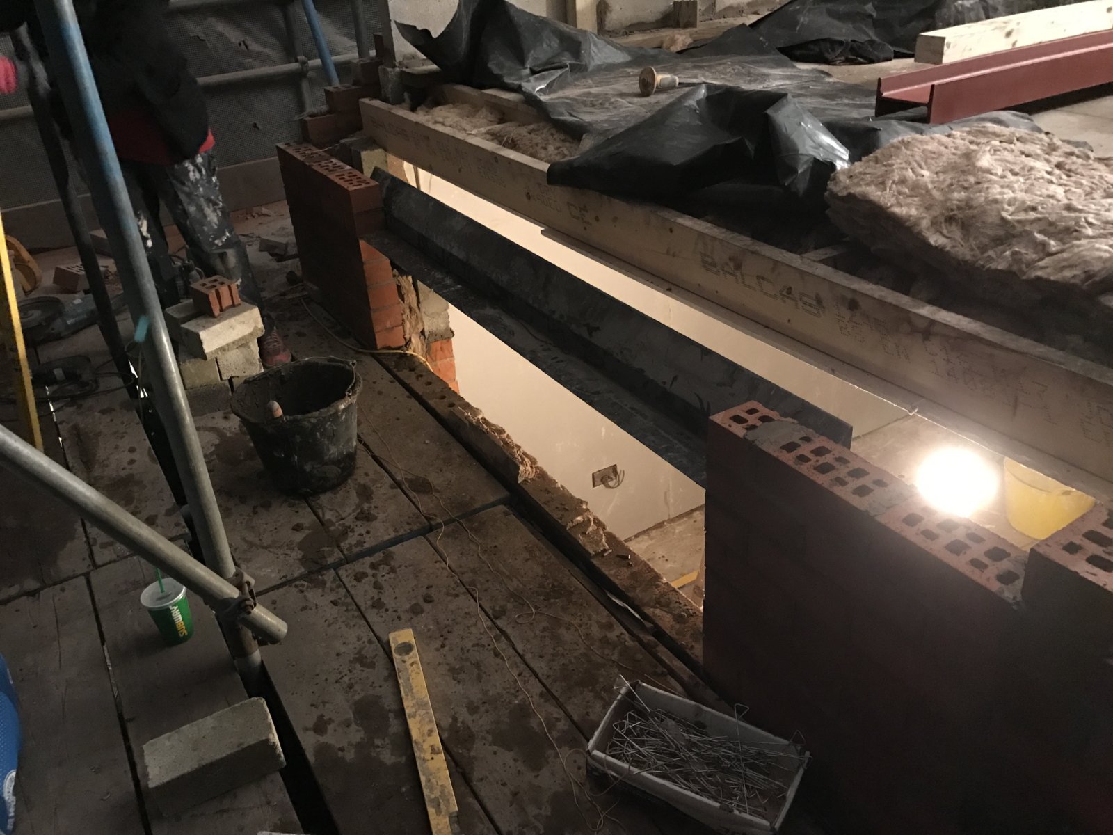

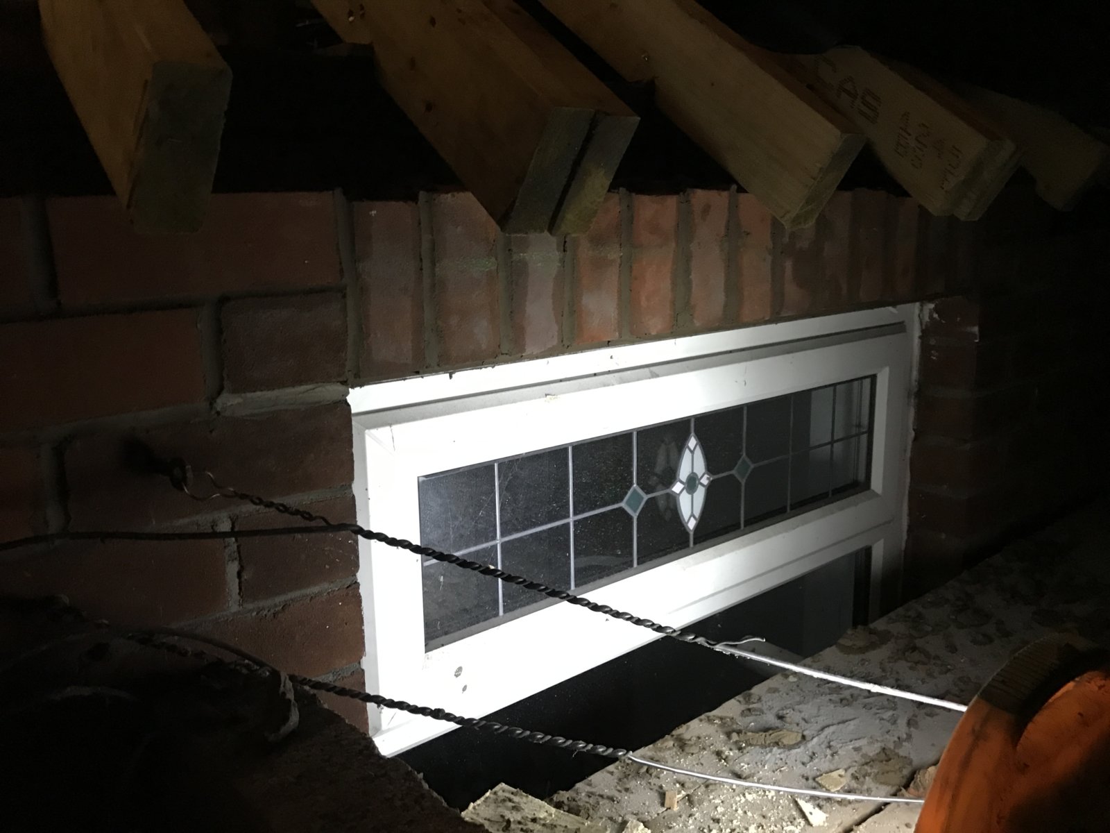

I'm doing another today, i bedded the lintel in the dark last night.
Don't forget the cavity tray and weep vents. The WV's and tray just makes it that much harder to do.
The one I did in the dark looked better but I had a brick left over :LOL::LOL:
