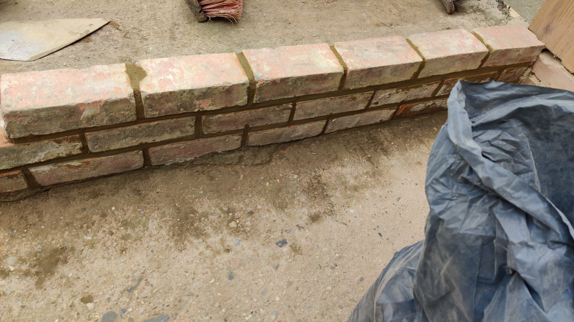

So today I done pointing on a garden brick wall before I lay some additional bricks on it. I wasn't too happy with the consistency of the mortar and wondering whether I'm doing something wrong/maybe made it too dry or could the issue be using a paddler mixer as opposed to mixing by hand?
I used a 4:1 ratio of building sand, cement and a splash of plasticiser and water (gradual). I used those household 1L cooking measuring jugs mixed 8 sand and 2 cement if that helps to get a better idea. In terms of the total water refilled bottled water and was probably about 700ml?
Mixed the sand and cement dry with paddle mixer low speed. Added a splash of plasticiser slightly faster speed, gradually started adding water and mixing. I got to a stage where I didn't want to add more water to ruin it. However the mixture wasn't butter smooth like you see on YouTube? It wasn't lumpy either a little bit gritty but it didn't crumble, held it's shape when squeezed.
I was able to do the pointing and overall to the eye it seems fine but just wondering whether the mix may have been compromised or how I can improve it?

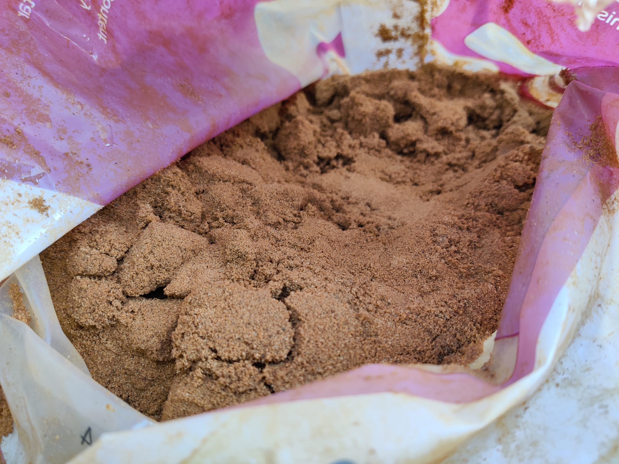

Probably not enough water. The quoted amount of water you used is a bit meaningless as it totally depends on how wet the sand from the bag is. When you say padel mixer do you mean on the end of a drill?
If it’s got a bit of a gritty feel and it’s definitely building sand, my moneys on a little bit more water/plasticiser needed…
Are you sure that's building sand? It looks a bit yellow. Building sand would normally be more red/brown.
Some places sell building sand which is actually really sharp sand and that can make crap unworkable mortar
It's impossible to "compromise" a mix. It does not matter what is used to mix it, how it is mixed or how the ingredients are added. If it's all mixed together properly and uniformly then it should be fine.

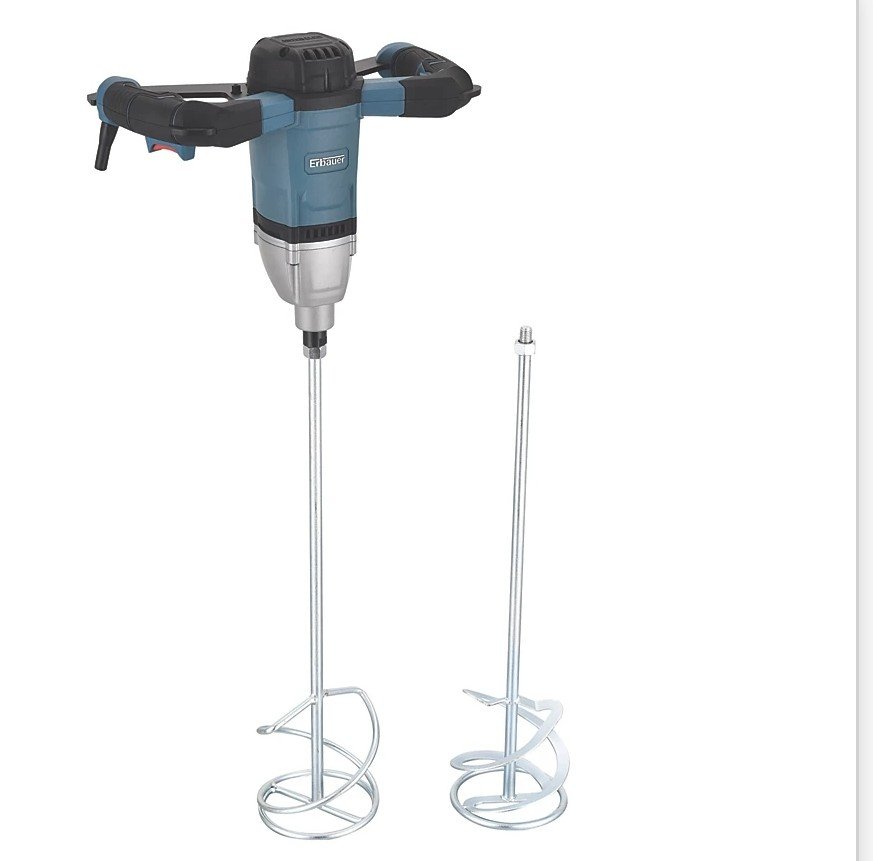

An actual dedicated paddle mixer (attached photo).
Yeah I bought the sand from Wickes over a week ago. Will take a photo of the bag tomorrow. It's definitely building sand as I have 2 tonne bags of sharp sand but can't use that for bricklaying so got building specifically.

@all I have attached photos of the sand that I am working with.

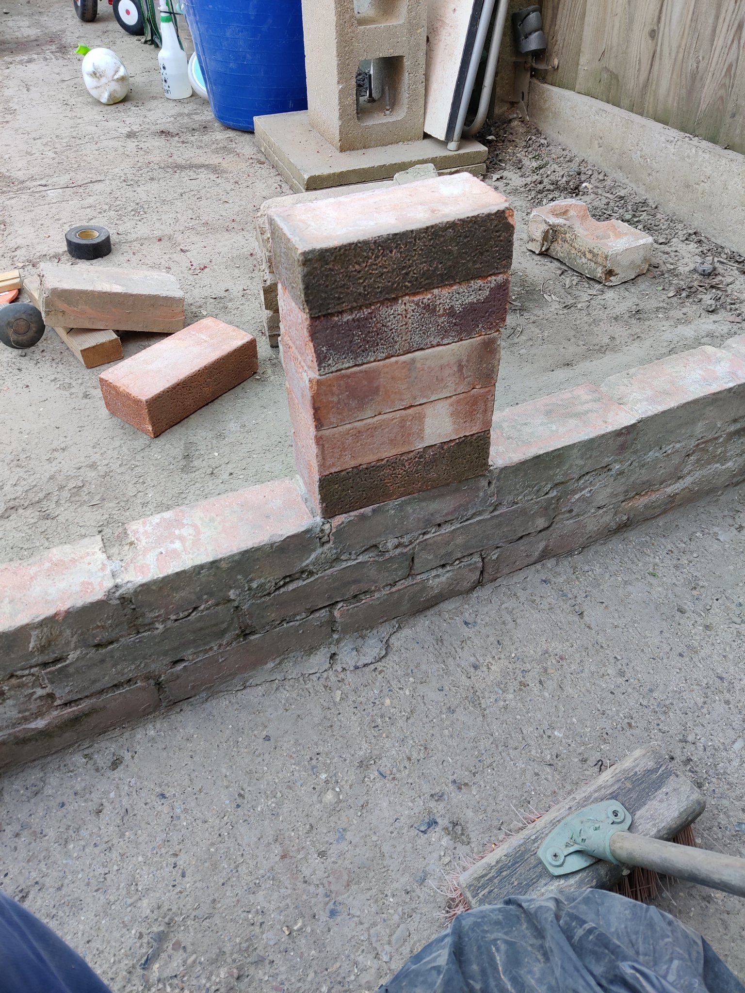

So I had another go today at the mortar mix and began bricklaying. Consistency was creamy this time just needed a touch more water!
How creamy can I go? As I had a few issues "beating" the brick down low enough, either due to adding too much mortar or mortar still bit too dry?
Put a full bed on the brick (bottom) then grooves/waves through the middle and slapped a bit on the center of the side and scraped the sides outwards.
If I pick up a good amount on the trowel and hold it vertically the mortar held there as an indicator of when it's ready, is that the correct way?

There is no 'correct' mix. Well mixed gear is always better than poorly or partially mixed gear. We use a wetter mix for dryer porous bricks and for running in. We use a slightly firmer mix for cornering up or engineering bricks. We like it wetter for blockwork but not wet blocks.
All I will say is, mix it well.
Are you tooling the joints straight away? They look a bit toothpastey. Lay them scraping off flush with the trowel then point every hour or so (weather dependent). Do them in the same order, so the freshest gets pointed last.

So maybe my mix wasn't the issue for the lower course as had a lot of trouble "beating" it down. Due to lack of experience and as there was basically a lip/wall on one side of the brick guess the excess mortar would compact there preventing/making it harder to get down to level if too much mortar was used?
Once I started the upper course where all 4/3 sides were basically exposed allow the mortar to squeeze out if needed waaaay easier.

You should point up as soon as the muck has firmed up a bit. If you are a slow bricklayer and the bricks are dry, this usually means as soon as you have levelled them up.
As soon as you've done a course perhaps. If you do it immediately after laying that brick then you'll get that toothpaste look, where the tool sinks in too far, and you get ridges sticking out from the edges of the tool.
Leave it a little time and it resists the pressure and those bits that get squeezed out fall off instead of staying attached and/or smearing across the faces.
It comes with experience knowing when to joint up. If it's really hot when laying a softer, more absorbent brick on a long run, you might find it easier to rub the bed joints up after each course and leave the cross joints. After a few courses the cross joints might be ready and you can do them, and then run the jointer back over the bed joints. If you leave the bed joints too long they can be really hard to joint them up and you will leave burn marks on them.
