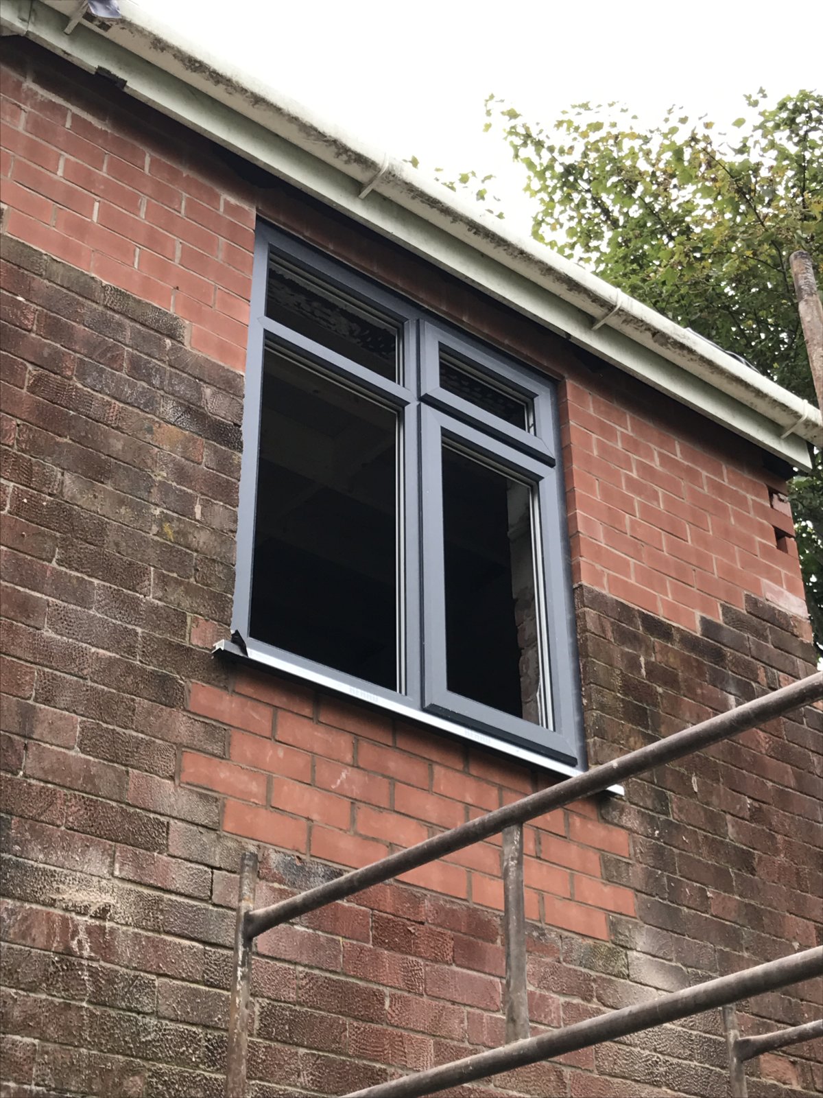

I think my brick laying career is over now.
I pulled the old window out, bricked it up and put the new one in. It's looks ok from a long distance. A proper Bricky is doing the front in about 4 weeks.

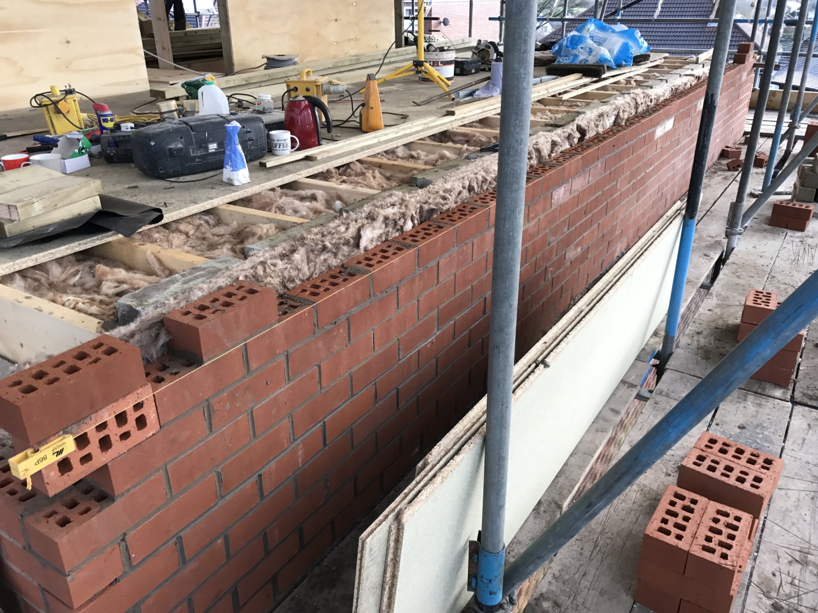

Well the bricky ran over on his last job so didn't come, then the roofer had a job cancelled so came early which meant I had to lay more bricks.

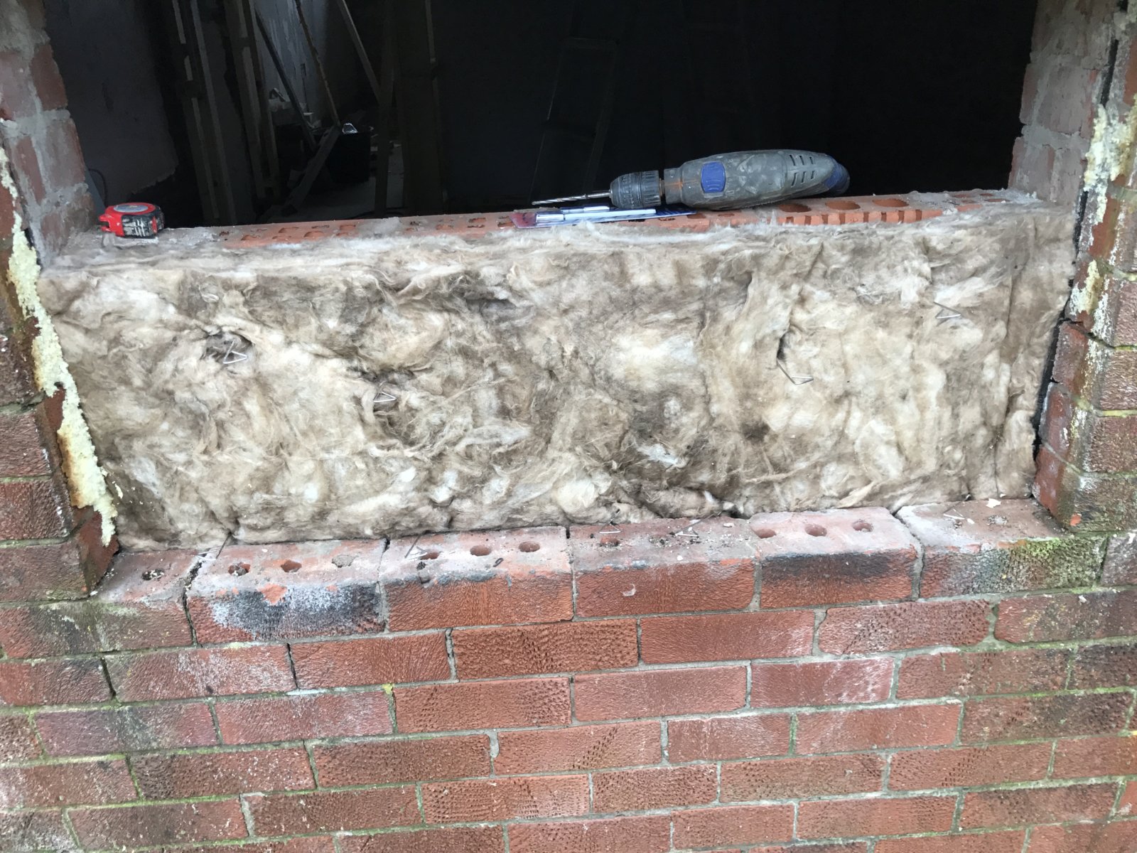

This weekend I need to replace a couple oflingels and do s couple of rows of brick and block.

Soldiers over a steel lintel.....:eek: As tough as it gets.
Gently prop the lintel.
Make sure all your perp' joints are full.
Your bricks will try and tip forwards so don't bother using a line. Rather, lay all the bricks a upright as you can, then once all the perp's are well and truly full, you should be able to tap the bricks back to upright, using a long straight edge.
Cuts facing up.
