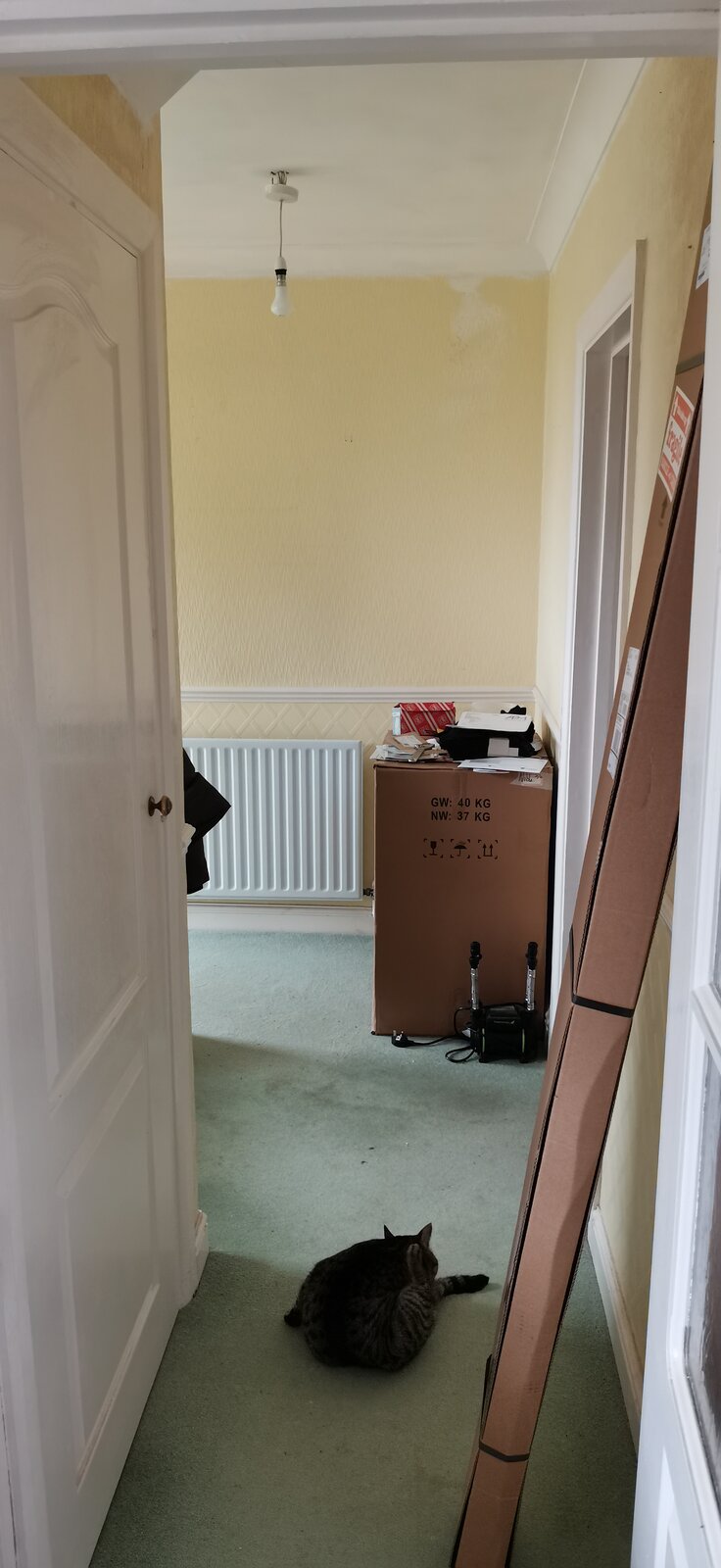

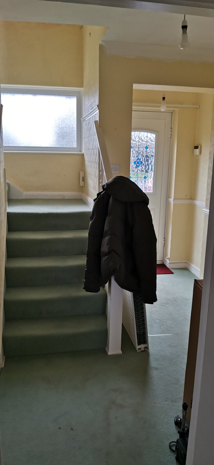

I have balanced the radiators and might check it again but I think the issue is the hall radaitor being under sized, my only concern is fitting a larger rad might make the rest of the house colder.

How big is the hallway and how big I see the rad?
The hall is L shaped 3.175 x 2.604 x 2.420h radiator is 600 x 1000 single convector.

Older systems were designed for a hallway and bedroom temps of 60 F. Bathroom and Kitchen 65 F. and Lounge Diner 70 F.
If correctly sized AND doors were closed These temperatures would be maintained.
A gas rate of the boiler to determine how much heat is being put into the rads would be helpful. Compare this with the rads output to see if enough heat is being generated.
So being quite open by the stairs, a lot of heat will be lost going upstairs.
I had same problem with mothers house, large hall radiator there to reheat hall when front door opened, but otherwise heated hall too fast, cure was a TRV on hall radiator set to 3.25 on a *123456 wax head and wall thermometer set to 19°C used the stop inside the thermostat so when turning heating down, and back up again, always stopped at same point.
Theory which seemed to work in practice, door opened so hall at say 12°C takes some time with late Mother in wheel chair, the heating goes on and the TRV is wide open so only the lock shield valve controls flow in radiator, at around 17.5°C the TRV starts to close, but it is not fully closed until around 20°C so before 19°C the radiator has started to cool so on a cold day the wall thermostat was never activated, but on warmer days it did work.
