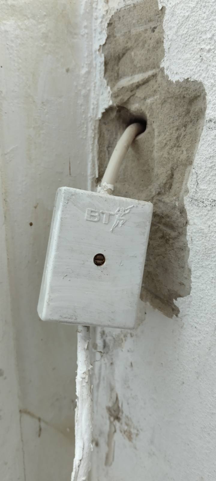

We're having a section of external wall, currently plywood I think, rebuilt with block, cavity and brick.
The phone connector (see pic) will end up in the cavity, so we're thinking we need to build an access box into the inner (block) wall in case any work is ever needed on this connector.
How much access (ie; how big does the box need to be) could be required in the future? (open heart or keyhole surgery?!)
I'd be a bit reluctant to leave that connector inside the cavity, even with an access panel. If something goes wrong with the phone line in a few years, you really don't want to be opening up a wall just to check a connection. I'd look into getting the box relocated to an accessible position before the brickwork goes up. If that's not possible, I'd make the access opening large enough to comfortably get both hands and a screwdriver inside, rather than just enough to see the connector. Something around 200 x 200mm might be a reasonable starting point, depending on the space available. Also worth checking with Openreach before moving anything, as it could be part of their network. Much easier to sort it now than regret it once the wall is finished
Where do the cables come from / go to?
It looks like a simple junction box to extend the cable. I am wondering if you could run a new length of cable if the origin is at the NTE socket?
I think the cable runs to that connector
through the wall from outside, but yes, I should have a better look to see if it's running down the outside wall from an overhead cable. It then runs along (clipped) to the inside wall - I think it feeds the NTE socket, but again, I need to spend a bit more time tracking it.

So we've had a look and this junction connects the external phone line coming in to the building, to the cable which feeds the NTE.

I would be tempted to get the junction relocated in that case. Not sure what Opereach would charge
Yes thanks for that thought, we're now waiting to hear back from our phone provider... (Am I right that the request needs to go via my provider?)
So we initially thought that we needed openreach to relocate that connector, but then I realise that because the cable coming through the wall terminates in that connector, there would still be a connector within the wall itself.
So I'm guessing the choice is either:
-leave a big enough opening in the wall to access the existing connector
-Have it replaced with a maintenance free connector (does such a thing exist for phone lines?)
-Have the cable from the pole outside running down the wall and into the house removed and replaced with a longer cable (I'm guessing that would be expensive).
Any other thoughts?
Now waiting to hear back from our phone provider...
