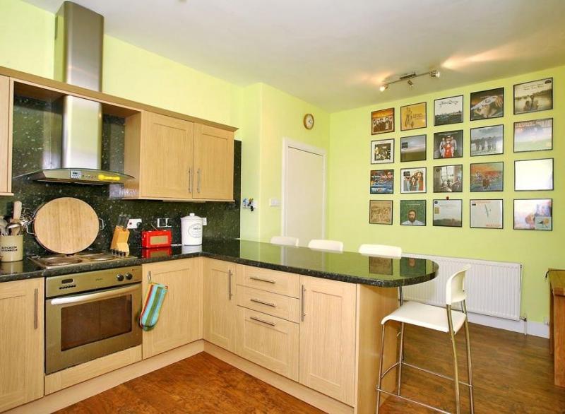

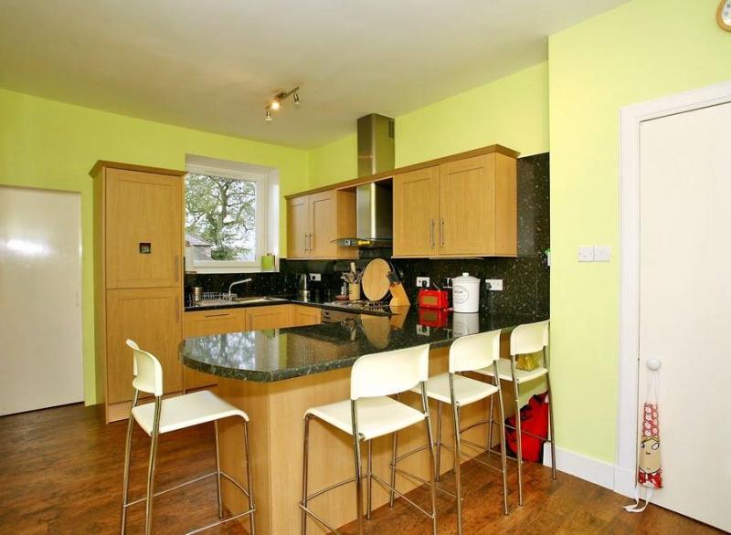

We're now onto the kitchen which is pretty modern and although not to our full taste, is not going to be changed out anytime soon (see photos below).
Yep - that really is lime green paint! As you can see, the window isn't the largest and during the day it can be quite dingy in here. Hence the reason we are going to paint the walls white, install some coving etc...
At present we have 6 spotlights, each with a 50W halogen lamp in place. Lighting is adequate, but as I sit here writing this, the worksurfaces are poorly lit - especially being black! As the main light source for the kitchen (we have fluorescent under cabinet lights but never use them as they click, and a laminate worksurface when lit which directly shows lots of wipe marks) we would like to get rid of these lights for something more efficient, both in terms of energy consumption and lighting ability.

How many of these lamps would be needed to light my kitchen? I guess I was planning to put them where the spotlights are at present. The kitchen dimensions are 5.00m (length) x 3.10m (width) x 2.77m (height).
Finally, are these lights the most suitable for my kitchen given all the options available? If I went with the 20mm PL downlights, with 1m spacing, I would need at least 8 given my room's dimensions.
