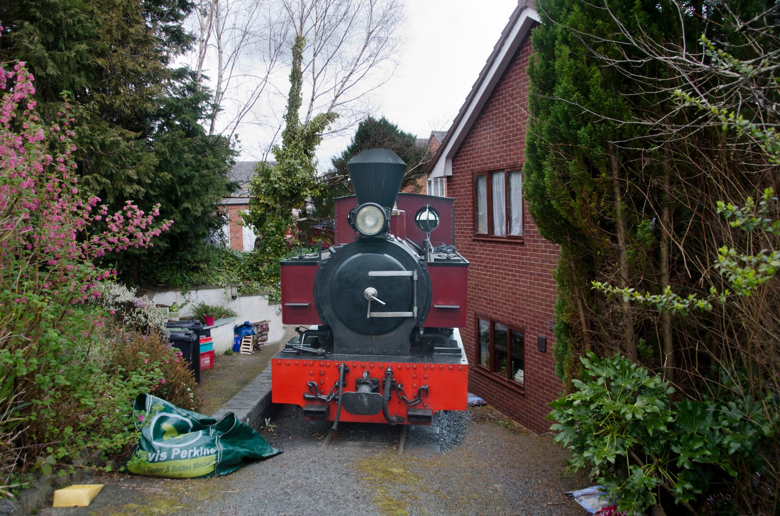

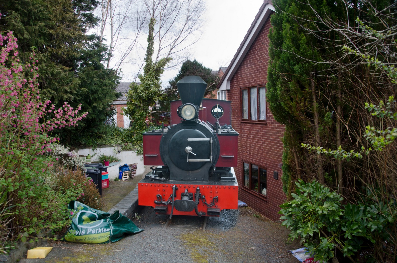

This is not the boiler I have at home Taking work Home.jpg it was just a bit of fun when the government said we should try to work from home. Yes Joan is an old boiler (not my wife's name) I look forward to getting back to normal, the thread has been useful, I had intended to sell old house, but now it seems my son it taking it over and selling his, and really it needs the two boilers combining into one new efficient boiler, there were a lot of errors in the installation, I miscalculated how much heat would go up-stairs, added a couple of radiators down stairs latter, never fitted one on landing, did not fit pressure release valve or by-pass valve, and the fitting of UPVC doors front and back has reduced draft so less heat needed down stairs, it used 8mm and 10mm micro bore pipes which worked well, but not so sure how good when the flow rate is reduced?
