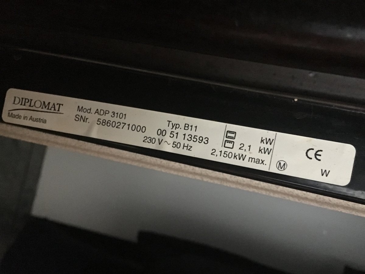

I recently purchased a new electrical oven as the old one had stopped working (although the grill still functioned). The top (hob) is separate - run by gas. However, when the man from Curry's turned up today, he was unable to install the oven because apparently the cooker's circuit is running the entire kitchen and by law he cannot do the work as it is against legislation. He said it is a large fire risk and that I would need to find an electrician part P qualified in order to do the job (rewire kitchen and install oven).
The kitchen is small, with one switch, four sockets, as well as one that appears to be just a fuse?
I'm wondering how much it would be for this job as I'm already expecting it to be a lot and don't want to be overcharged :( Thanks.

@ban-all-sheds I'm not sure regarding how it was connected, it was already installed when I moved in (leaseholder) but what the guy said was that there's one circuit running the entire kitchen as opposed to an independent circuit for the cooker.
Is that the information for the new cooker?
If so, at 2.1KW that is about the same as a regular kettle. You could bung a plug on the lead and plug it into any handy 13A socket.
OK - so now we know that the oven is 2.15kW. The same as a typical washing machine, tumble drier, dishwasher, and less than many kettles.

You need to get someone who does know what he is doing, and does know that your 2.15kW oven can be connected using whatever connection the old one had.

Sorry guys, those were the specs for the old oven. The new one is 2.5kW max does the same still apply?

This sounds like a dual-fuel cooker. I've had some, and they usually come with a 13A plug attached (provided there is just a single oven and the grill can't be used at the same time) so they can be plugged in.
I currently have one with two ovens, and it has to be hardwired as it is rated at 4kW.
Yes - everything still applies at 2.5kW - it's still less than 13A, and still less than many kettles etc.
