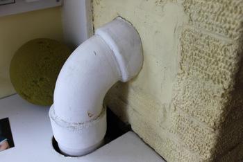

How much should it cost to have an asbestos flue removed?
Why particularly that one, is it the colour, shape, funny angle or just because its on its own ?
I had about the same and British Gas removed it as part of the boiler exchange, don't know what is in the chimney but chances are it is either a flexible steel flue liner (correct) or as in my case no liner at all (bodge) :rolleyes:

The building surveyor said its beyond its serviceable life, it connects what is currently a condemned boiler to a chimney flue, which I believe any new boiler would could not be legally connected to.
I had one person say to me that he would want the boiler 'isolated' and to see a certificate stating that it had been isolated, to prevent harmful gases entering the house when they remove the flue.
The boiler has already been condemned.
Is a condemned boiler automatically isolated?
If not, is 'isolating' a boiler, and issuing a certificate to evidence this, a standard procedure, that a heating engineer would undertake?

I mean, on the face of it, what the guy said to me is reasonable, he wants to make sure its isolated so that he knows no harmful gases will be released into the house when he removes the flue.

I am sure you know the flue is now not applicable to any new boiler - you've had loads of installers out. Why you are taking a surveyors opinion over an installers is beyond me, surveyors actually know very little, IME.
Who is the "one person"?. Probably another surveyor.
OK, re-read post. The "one person" is presumably a contractor quoting to remove the bend? Is it actually asbestos.? Why is your boiler installer not removing it? (If he actually exists)
To remove that flue would cost nothing and is a simple job to any installer
It would be out in a few minutes and bagged up, no danger to anyone.
You can make it as complicated as you like beyond that.
I haven't chosen an installer yet, but I rang one up, and he said he would need it removed before he started work on installing a new boiler. A second installer also said that.
Once I've asked an installer to do the job I can ask them, I just thought because its cement with asbestos that you'd have to get an accredited asbestos remover to do it, rather than your average heating engineer.
you can get bags from council, bag it up and they will take and dispose of, not sure who your talking to but they are jobsworths.

3 different types of Asbestos, 2 of which are dangerous and that one isn't. Bagged up as others suggest, nae probs
