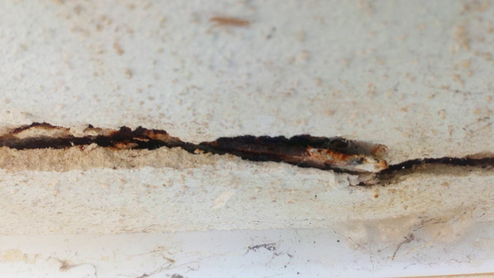

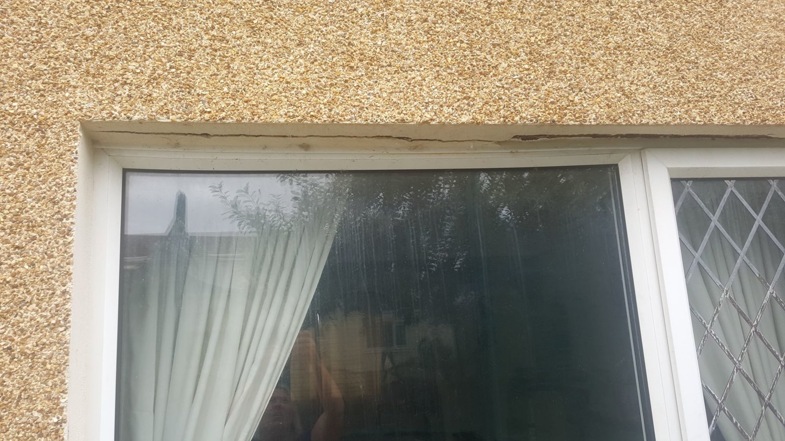

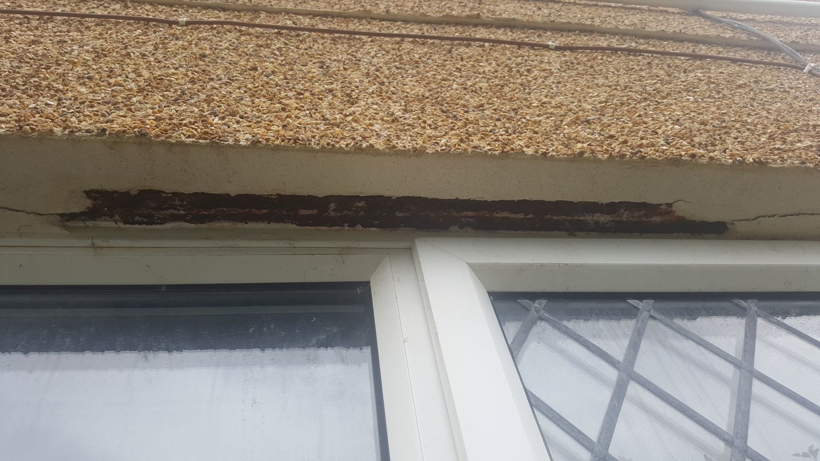

I'm posting this on behalf on an FB friend who I live nowhere near, so apologies for this being a bit second hand. She lives in a rented house and she is worried that the house might be structurally unsound. She has sent these pics of an exposed lintel; note the third one, that appears to show a bit of lintel that has separated and is poking through the remains of the rendering:
She has informed her landlord but he has told her there is only a problem with the rendering and no action needs to be taken. But she tells me the window frame is bowing out (you might be able to see this on the first picture). Also, several years ago some builders told her all the lintels in the house were failing and needed to be replaced. But all that was done at the time was repair of the rendering.
The landlord has seen these pictures by the way, but he insists the problem is only cosmetic and nothing needs be done.
She is worried, as the children's bedroom is directly above this window.
So three questions really: does this problem need sorting? Does it look like it can be sorted cheaply, e.g. by injecting silicone? And is there a possibility the wall could collapse suddenly, or will it just slowly subside at the worst?
I'm no expert but there does appear to be something worth investigating further, if the photos are not distorting the situation.

Does the window open and close properly?
That for starters.
Tell her to get a straight edge (a metre rule, a spirit level) and hold it against a straight edge on each window (on the frame, not on the opening bits)- measure how much deviation there is from straight (the pics do make it look as if the windows are bowed but that may be a lens thing). Write the measurements down for each door/window, if she has a friend get them to take pics while she holds the straight edge against the frame.
If the lintels are failing it is a big problem for her landlord. They are unlikely to suddenly catastrophically fail. Have a look on her councils' website and see which department is responsible for looking after private tenants (just checked- my council has various online forms she can submit with her concerns).

It's unlikely to be immediately dangerous, but it needs urgent action. But in a tenants mind and in any correspondence, it's dangerous and causing anxiety and alarm. That helps with any compo claim.
Dangerous structures normally come under building control and they should come out if it's as serious as described. If not a danger they can allay your fears, if it is they have powers to require the landlord to act.

There might not be a lintel. Possibly the original windows provided some support that the replacement, joke plastic windows fail to do.
The flaking rusty metal in the OPs photos suggest a metal lintel but it’s not absolutely clear. Plastic windows not as structurally strong as wood can be
