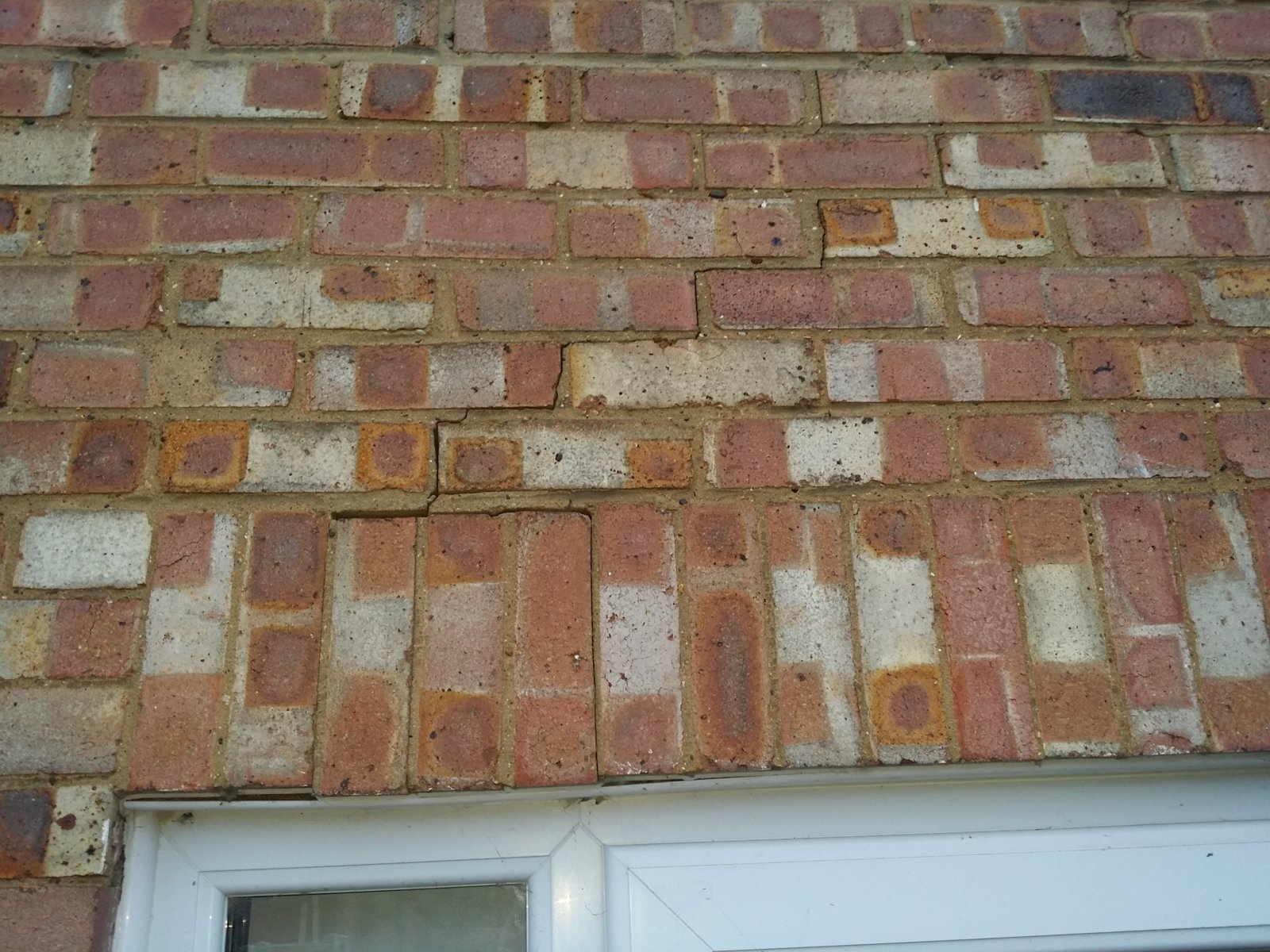

I've just seen this!
wall-crack-jpg.131898
No idea how long it has been like this. As you should be able to see, several up right bricks are pressing down on the patio.
Apparently this patio was installed around summer of 2014 and I bought it in November of that year.
Surely they've installed some kind of lintel and if so, am I supposed to be able to see it?
Could this be a very serious building mistake or nothing to really worry about?
Thanks very much.

Yes very common with new windows the old wooden frames used to support the brick the new UPVC do not. The soldier course (upright) of bricks has even less supportive strength than a normal one.
Installers do not put lintels in as a rule and then this happens!
As said above get a brickie in to fit a lintel and repair the triangle of bricks above.

If you've got the receipt for the installation, then I'd be inclined to go back to them, and have a go at them for causing the damage. No, window installers don't tend to bother installing lintels (lazy *******s) but by now, they should be aware that it needs an assessment to check if one needs installing. Their lack of care has cause the soldier course to drop, and they should at least be made to remove the window, and replace it after the lintel has been put in place.
The builder should be able to support the soldier course, get the new lintel in, and then reinstate the dropped bricks, and finally, repoint the cracked courses above.
The porch shouldn't be an issue, but he may well be more inclined to help sorting out the lintel if it means he might get the porch job as well. As always, talking with him will help.
I had this twice, first time with BAC over a large front window, after a lot of pestering they came back and put an angle iron in that cured it.
The second was a house I bought that had one of those awful tilt and slide patio doors fitted with the same problem, I got a brickie in to fit a lintel before the new door was fitted.
As to the legal position this might be your best first port of call.

It needs a lintel. Every time the door opens or shuts it will vibrate the wall a bit more. Ultimately the door will bind on the frame.
Window and door fitting falls under building regs.
However, because there are so many being fitted, building control cant spend the time.
So window installers have been allowed to self certificate by being registered with Fensa or Certass.
Structural integrity is part of compliance so installers should fit lintels where there are none. The problem happens because lots of houses were built with either metal crittall windows or timber windows. They would have been put in place and bricked around and because they are quite strong and stiff they are able to support the brickwork above. So when an installer cones along and fits plastic, the new window is less stiff and a gap may left above the window, maybe just foamed up and trimmed over. A while later you get exactly what you have.
It needs doing, but I wouldnt panic thinking the side of the house will fall down any time soon......

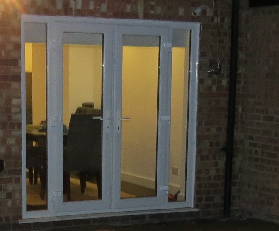

Would anybody have a good idea how much it would cost to put a lintel in? £200, £500 or £1000?

If you look at my threads, I put the quotes I have received for putting in lintels to all of the rear windows on my property.
For a single opening, the quotes came in at £300 - £600 mark.
You may want to check the other windows (especially ground floor ones) for signs of a lack of lintel.Your French doors may be the first to show signs of failure because of the size of the opening and the weight of the French doors opening and closing.
My problem was finding a builder that was prepared to bother with such a small job. I also had a problem finding one that was prepared to install something other than a untreated angle iron. Some builders wanted to remove the soldier course (the decorative part above the window) and replace it with standard brickwork to make it easier for themselves.
