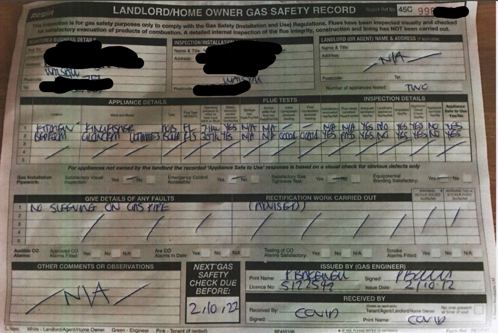

Digging through my paper work, I've found this - It's very blurry and I can't read the headings so god knows if anyone else can understand it..
On the landlords appliance box, he has stated no for both, so whos appliances are they then ?
I can see that now you mention it! Looks like he was going to write Yes, then changed his mind - I'll be sure to ask in the morning!

There's no completed version of the installation and maintenance instructions.
