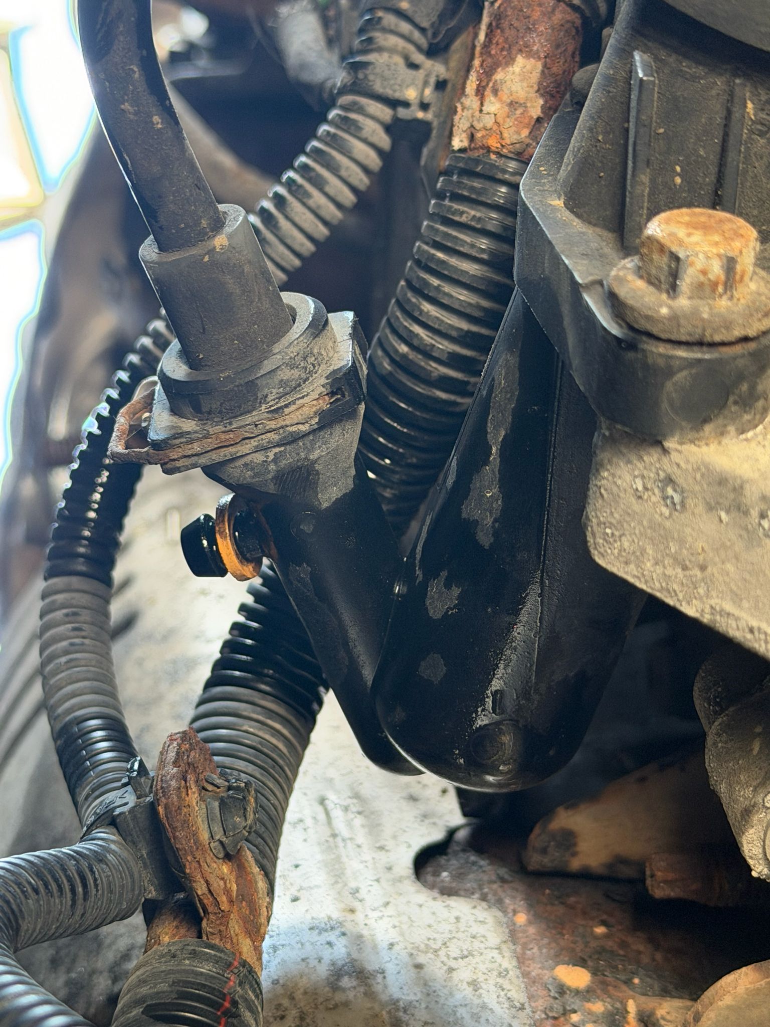

Hi all,
Has anyone any ideas how to bleed the below clutch slave cylinder?
The cars a 2019 vauxhall combo 1.6 diesel.
I'm used to on most slave cylinders the bleed nipple twists 90 degrees to allow the fluid to be bled, this appears to just be an opening with cap on it but when the pedal is pressed or a pressure bleed used nothing comes out.
Below is a stock picture of the part,
Currently the only ideas I've got are either the rubber part at the end needs compressing so that part of the internal piston would align or that you need to release the spring clip and partially withdraw the brake line and if that uncovers the nipple allowing fluid out?
Chris.
