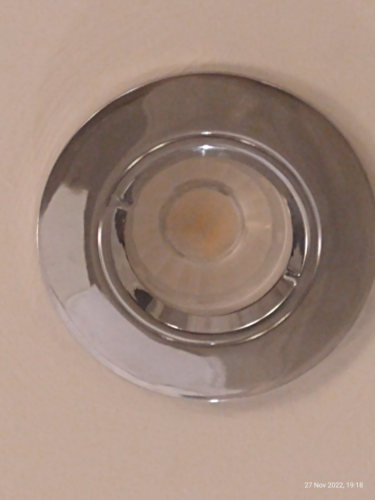

Does anyone know how to change this downlight bulb?
There are no clips like on the videos on youtube. There are only 2 ridges not 3 like the videos, where the middle nicely screws off. Completely lost? I can't turn the middle bit, does the whole thing have to come out?

Normally you twist the middle bit anti clockwise with the two ridges and it pulls down ….it may be a sealed unit and you replace all of it !
The big ring (outer) turns but I'm afraid to turn it too much in case the whole thing falls out.
Hold it still and lift the house off of it. :giggle:
Pull the whole thing downwards. Watch the spring clips as they can get your fingers.

six, to be clear you are saying the whole unit needs to be replaced each time a bulb fails. It looks like a Aurora EN-DLM356 only one i can find online with 2 ridges not 3 in the middle. Or can you take the whole thing out and put a new bulb in?
Assuming you have the correct part number... I know nothing of the product but they are supplied without bulbs according to the 3 sites i clicked on selling them. They use GU10 bulbs so yes less than ¼ turn anticlockwise and drop out.
Pull it out and have a look.
Some of this type of light are integrated and the bulb is not replaceable. You would have to replace the whole thing.
Some have replaceable bulbs.
