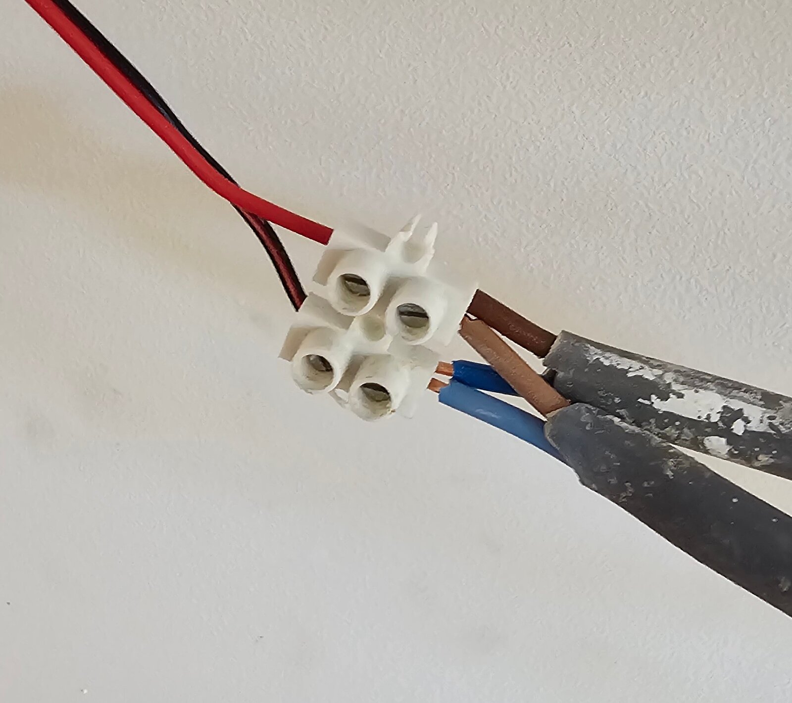

Sorry for the newbie questions. I got three Mean Well 12v drivers and three 12v COB LED strips to light three shelves. As seen in the pic, I have two pairs and one single flexible (220v) connected to a lights switch to power the drivers. Can someone here have a wiring diagram that I can use to ensure that I wire the 220v AC supply to the drivers correctly. TIA

The wires connect to the 230V side of the driver. Two of them will have 2 wires in each terminal, the other only a single wire.
The LED strips connect to the 12V output.
The more usual method is to locate a single driver out of sight in a more convenient location and then run the 12V cable to each shelf.

IMO the electrician did a poor job, the flex isn‘t suitable for fixed mains wiring. The neatest way of doing this would have been to run T&E from the switch to a flex outlet and a short length of flex to the LED driver. I doubt it’s going to cause any issues though.

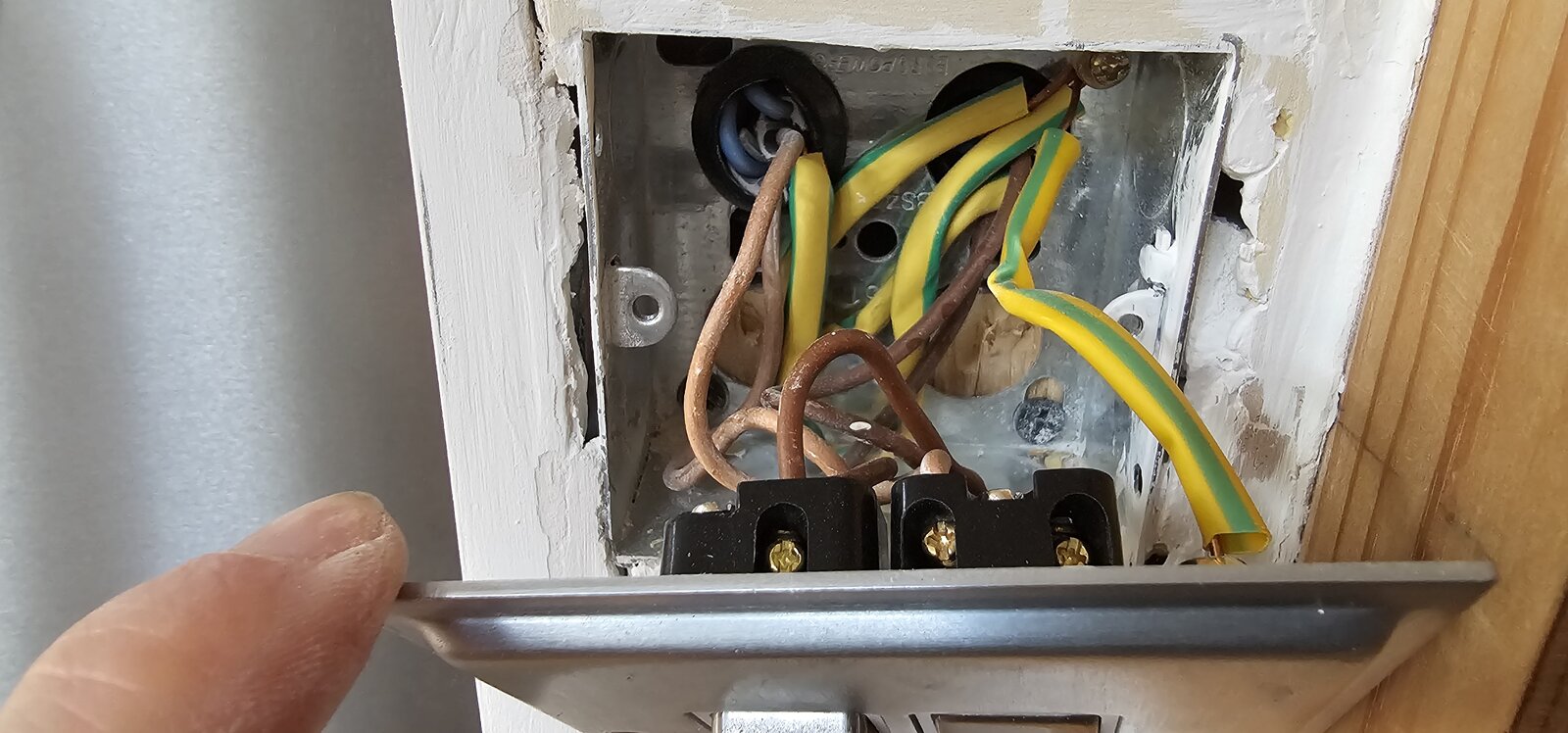

See below a pick of the wiring at the socket which to me (but I am possibly completely wrong) looks like the flex is grounded at the switch end, and it may be that the wires that you see are connected to flex outlet that is out of sight. Maybe not. But I am glad that regardless there isn't anything here as far as you can see that is likely to cause problems.

It would be convenient if I could use the existing flex to run 12v wires to connect the LEDs on the middle and bottom shelves in parallel. But I suspect that isn't going to work and that i am going to need a 12v wire, e.g., this one instead. Just checking with those here who know how to do this properly who could advise what i need. TIA

I don’t see why you shouldn‘t be able to use the existing flex for 12 V. If you want to do an exceptionally neat job, get some red and black heatshrink and mark the ends of the positive and negative wires to indicate it‘s DC.

I connected the Mean Well LPV-35-12 driver to the LED strip 2.4m long at the top shelf and if works fine. Looks lovely.
I then connected the second LDE strip 2m long in parallel to the driver 12v output - see pic below - using the existing flex and the second LED to the second strip work fine also.
I then connected the third LED strip 2.4m long in the same way and the tree LED strips blink on and off.
I used terminal strips in this way for testing. I will sort it properly when i get it to work properly. What am I doing wrong?
