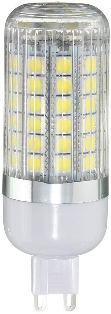

A driver is normally matched to the LED's, normally marked in mA for example 350 mA with a variable voltage like 25 to 42 volt, a power supply on other hand fixed voltage and variable current. However I have seen power supplies for lights called drivers.
So when I opened a G9 bulb, G9-big.jpg in side there was a full wave rectifier, a smoothing capacitor, a current limiting capacitor, a leak resistor and the LED's. That smoothing capacitor will cause an inrush. It also stops any flicker, when using strip lighting some have a very good lumen per watt, and some very poor, the latter often really just for decoration.
The versions I got from Ikea very low output, the version from Lidi very high, at nearly 700 watt you should need sun glasses to work in the garage, the 22 watt Lidi has to be turned down, never mind 118 watt. Standard bulb LED is around 12 watt, may be so no shadow you may need 4 in a garage, but that is still less than 50 watt.
