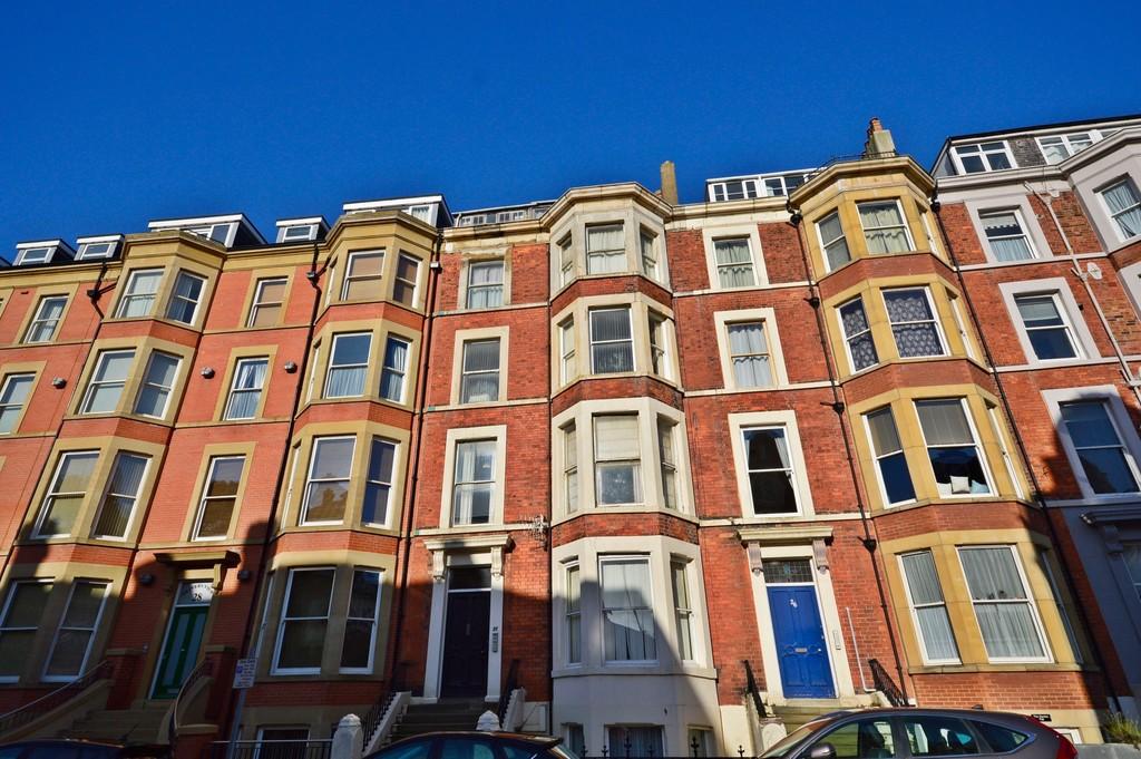

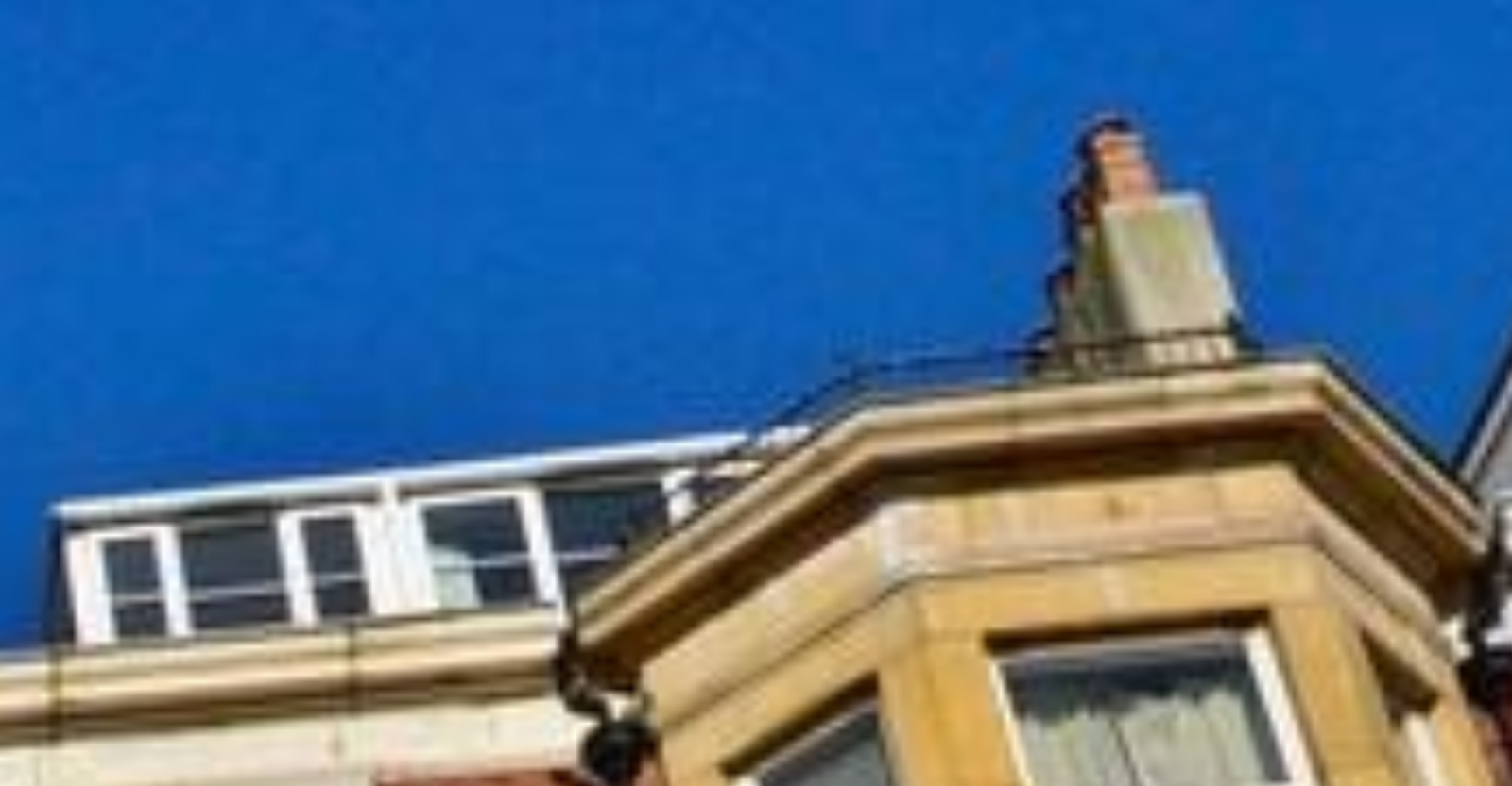

The photo is of a top floor flat and i would like to knock out the windows and lower wall and install some french doors which would then open out onto the roof of a bay window.
Next door has done this on his top floor flat, but i havent been able to go and have a look.
Does anyone have any links to how this job can be done ? How do you water proof the exterior floor area ? I may need to get some help, but i think i can do this type of work.
Also can you see the damp on the chimney in the room ? Any ideas on what may be causing this. The flat is heated so not cold. Is it the flashings ?

Who owns the freehold?
There is bound to be some type of issue if the "floor" that you are talking about is actually someone else's roof.
What you call a bay window looks to me like a dormer? There may be structural issues in removing it?
It's not clear to me whether you want to bring the window inwards, and use the current carpeted floor as outside space? Or replace the existing windows with doors and be able to walk outside onto a flat roof?

The bay is a big structure, which you cannot see.
Just wondered how you make a new floor and water proof it, using a tanking system and not concrete.
The cupboard on the left allows you to crawl round to the front and you can sit on top of the bay. It is still under some roof covering, but it cold and exposed as not heated.

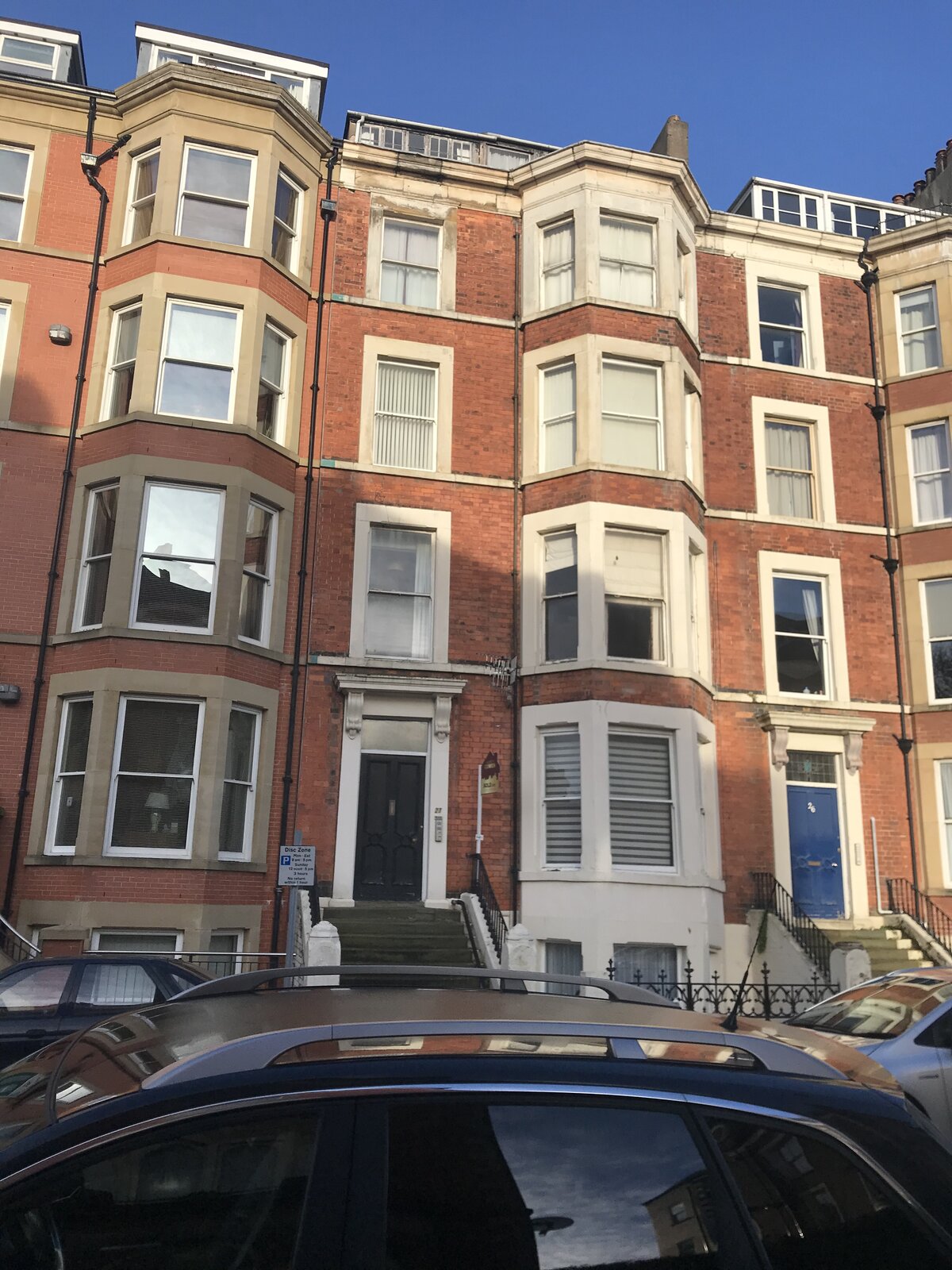

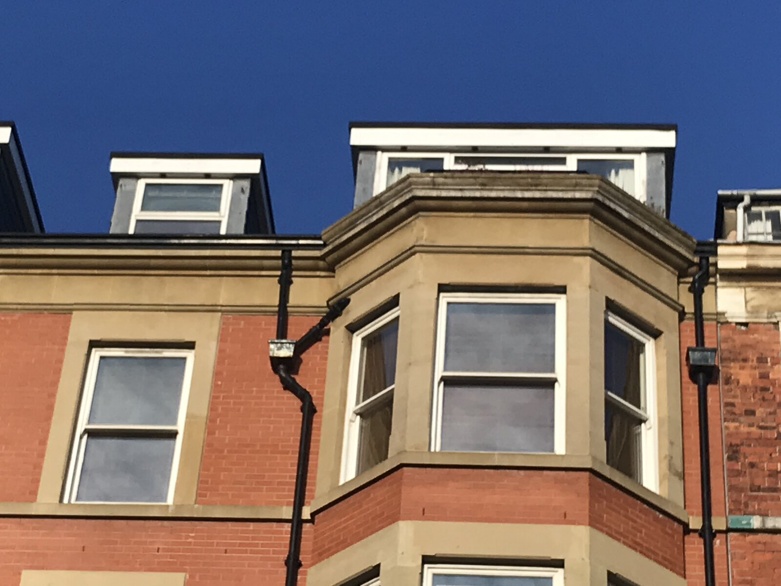

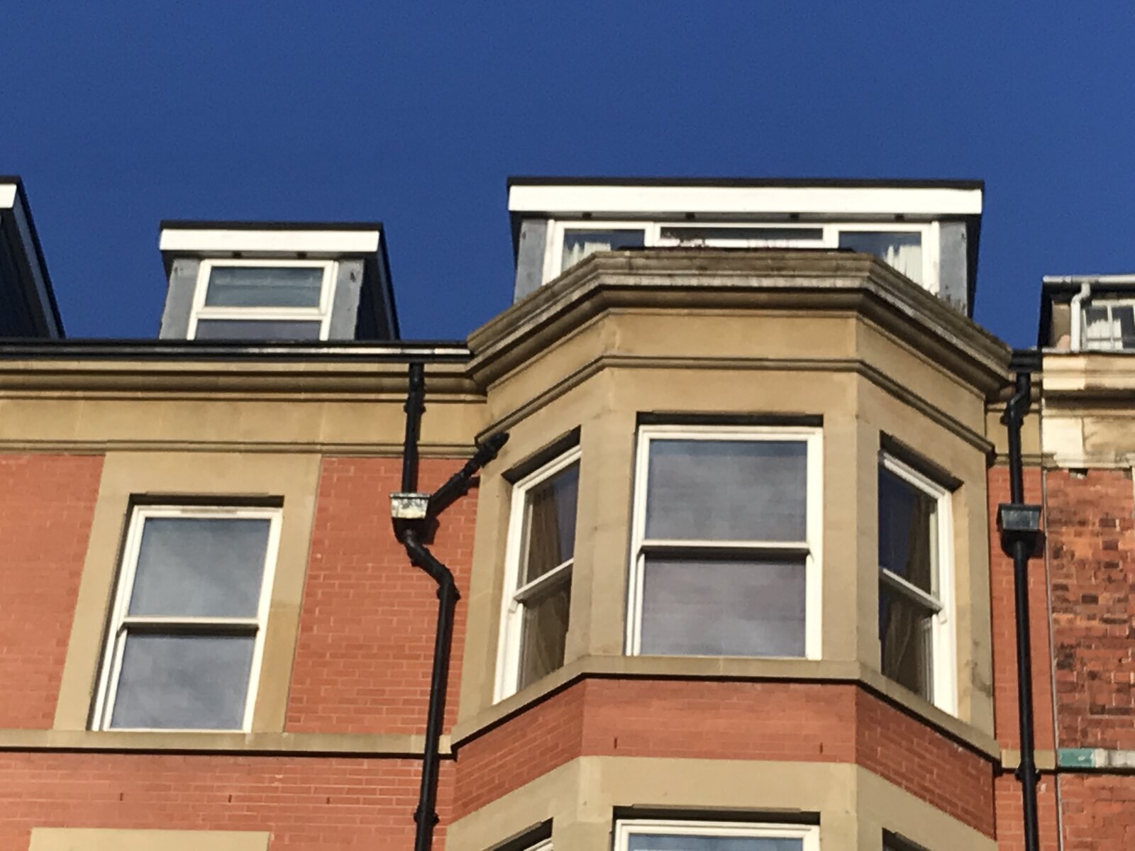

This photo is the external one and shows the bay. The bay does come up quite high. I think it is level with the bottom of the windows line. I don't mean the floor, but the bay walls. So there is a natural protection there and all i will need to do is add some type of balustrade on top.
Any ideas on tanking ?

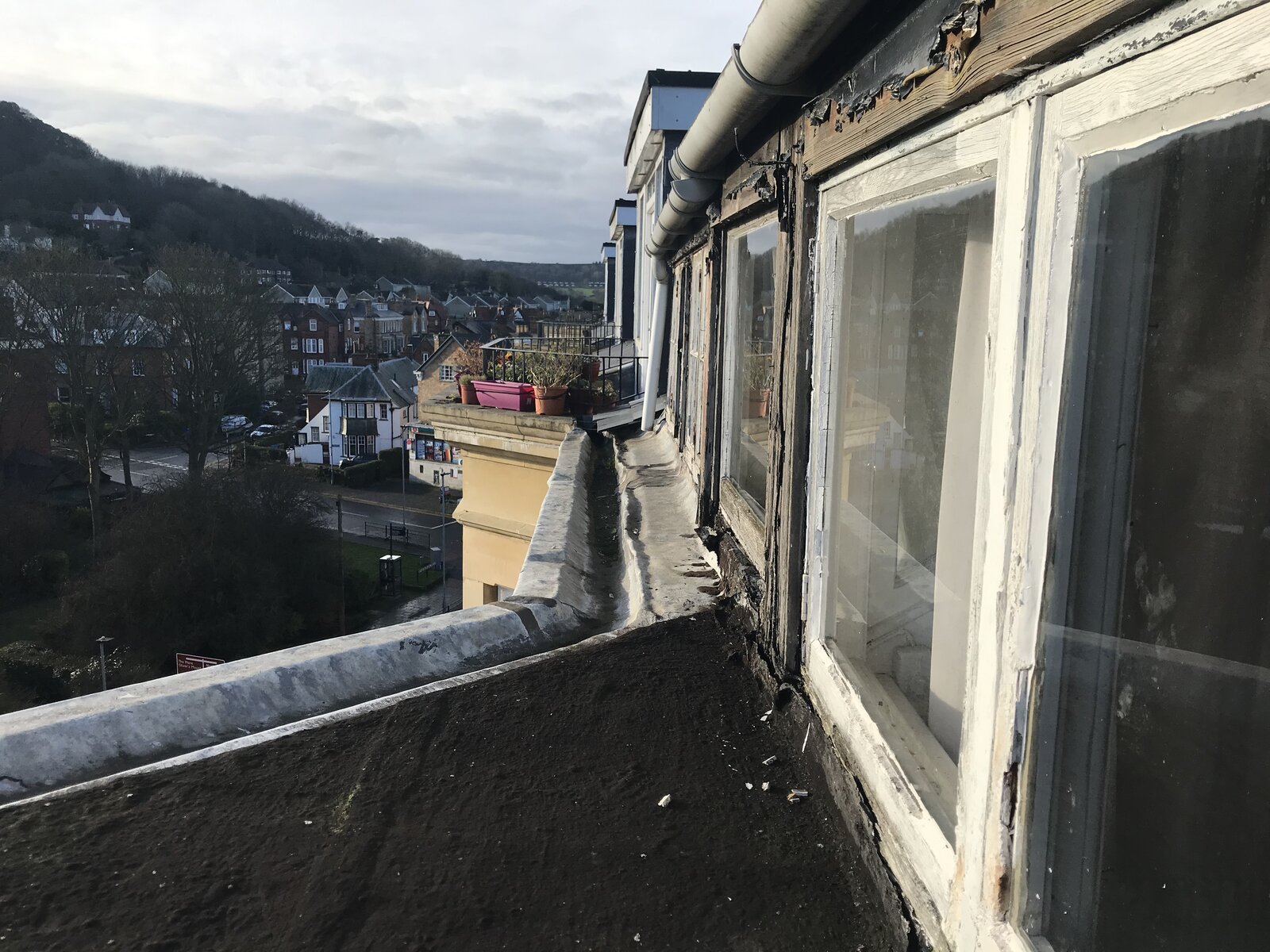

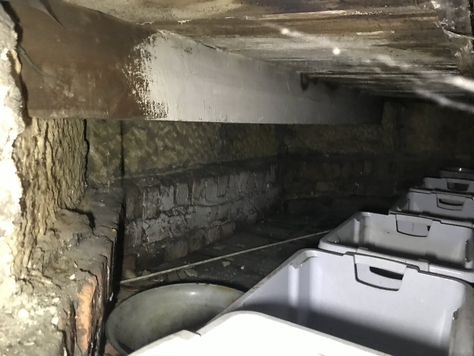

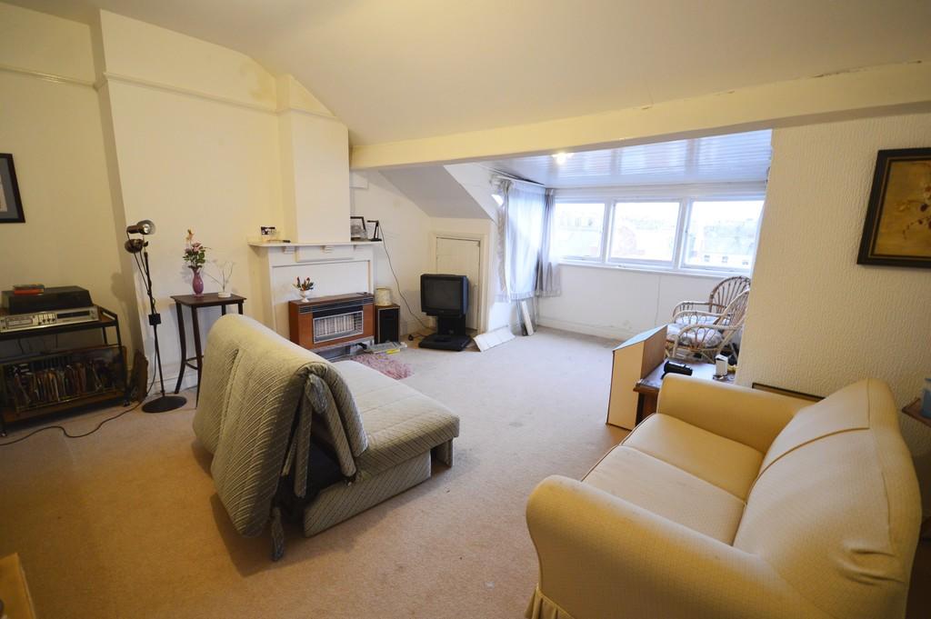

Update. I have some more photos. Pretty sure i can do this work, but i think i will need Planning Permission.
Here is a pic showing the dormer window from inside the lounge area. The whole window down to the floor level will come out to be replaced with french doors. The external bay wall is about 10cm below the window cill level.
There is a pic behind the window wall which shows what it looks like outside. This is actually covered by a wood deck covered with lead i think. But you can see where i could fix joist hangers and run new joisting to take a new floor.
There is also a pic of the neighbours bay which have converted, plus some external photos.
What do people think ?
I feel pretty confident i can sort this out. I think a GRP system is going to be the best solution to make the floor water proof.
