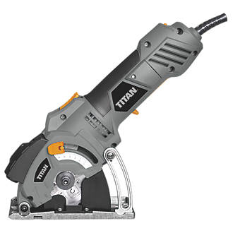

I'd look for a cheap saw - or plunge saw from either aldi or lidl or possibly screwfix
I'm sure this has been gone through at length before.. You won't get a particularly straight perpendicular cut with a jigsaw in anything but thin materials regardless of what you do. That's it I'm saying no more.
I used a Dremel version of this recently and it was excellent, not as frightening as a full circular saw!.
