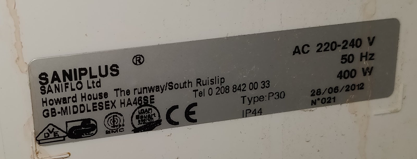

Sorry - my first reply assumed that it's a Saniflo type or equivalent clone.
If it's a Grundfos type then post back - they're considerably easier to clear if it's a blade jam.
If you`re feeling lucky, buy a cheap wet-vac, and then get the suction hose of the wet-vac as near to the toilet pan U-bend as you can then turn the vac on and whatever it is may be sucked out.
Will need make & model to advise any other action.
That really depends on model and age of unit before you can make such a sweeping statement mate.

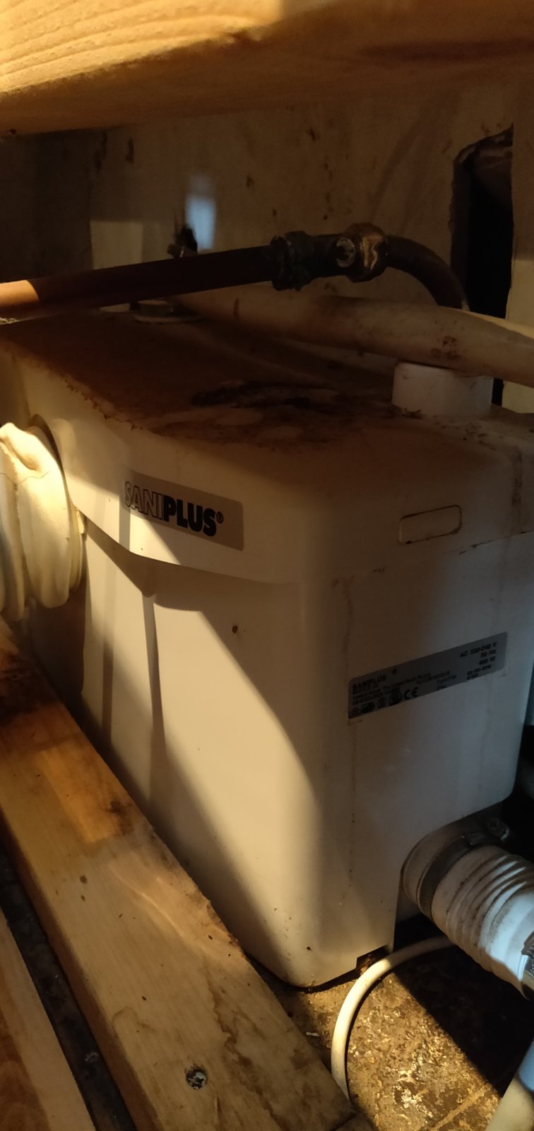

So here it is. There's a pipe going in from the sink too that you can't see, opposite the one bottom right (shower).
Nothing obviously clogging it. When we connect power it runs continuously make a kind of growling noise and the water in the shower doesn't really go anywhere. Flushing the toilet seems to work though... Are there separate pumps/blades for each inlet?
Not straight forward to remove the lid, sounds like it needs a good clean out and service from here, might need a part or two and sorry but it`s not really a diy job plus it`s not going to be nice once the lid is removed.
Are these things designed to be serviced and repairable, rather than just be replaced when they fail £££?
Another one died completely a few months back and we just got it replaced, assuming it was non repairable.
Is it possible just one inlet/valve is blocked then? We had assumed it was due to hair, is that likely?
They are designed to be serviced and repairable, hope you`re not believing that that one is a few months old. Inlet blocked wouldn`t make it continue to run.
