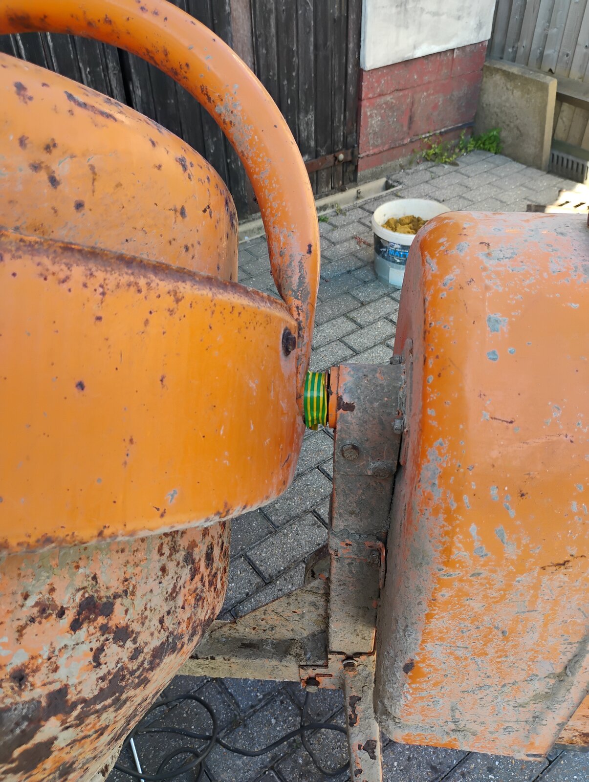

I'm trying to transport a big old mixer and it would be easier if it can come apart. I'll add a picture of it. The electrical tape I've put on it is where id like to pull it (along with the drum) away from the motor.
If I do that does it come apart easily and go back easily or could it create another problem.

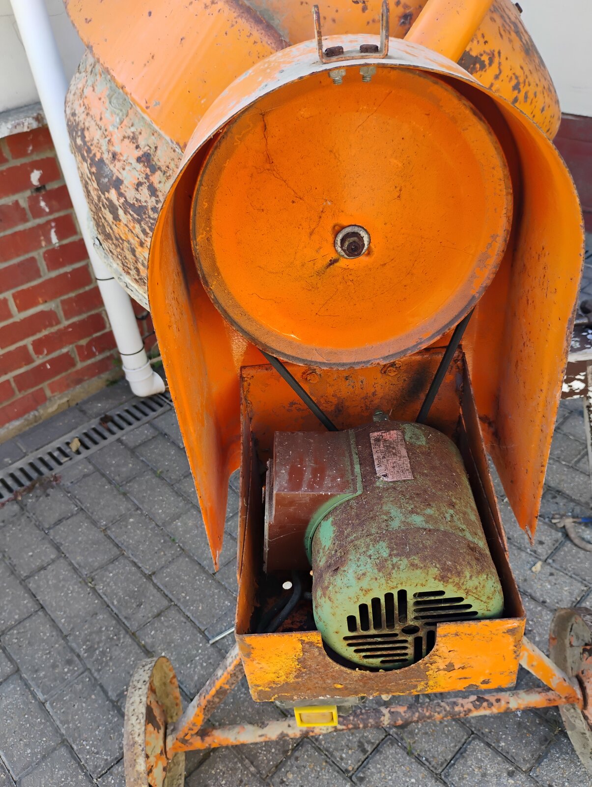

The other picture is what it's attached to
The leg/wheels should fold up (they were usually sold in a big cardboard box). The two bolts on the frame below your green tape, but be prepared for them to be seized and maybe sheer off.
