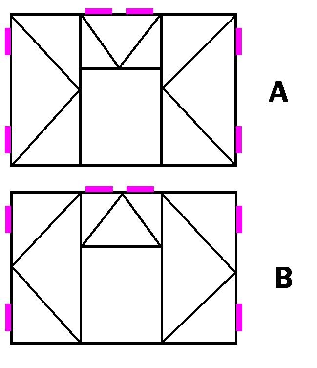

Hello all.
I want to order a new window, but I'm unsure how to draw it for the window maker.
I have added a picture which shows where I would like the 'hinges' in pink.
Do i draw it as per diagram A or B?
Thanks!
It's 'B', and the lines indicating the hanging should be dashed, and ideally a bit lighter shade
And for dimensions, you need to state if they represent frame or brickwork opening size, and if a cill is required (and if the cill is included in the height dimension)
And don't forget about vents, or if escape hinges are required, or safety glass
