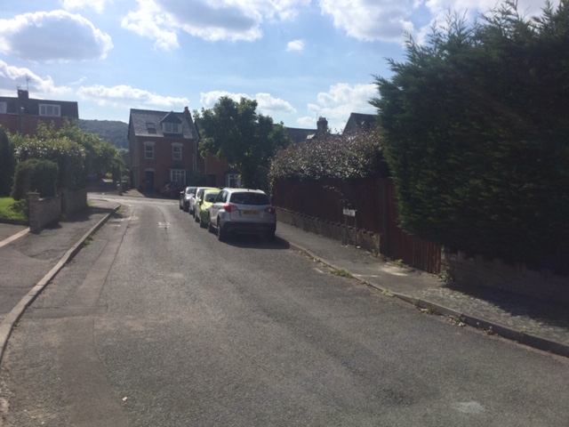

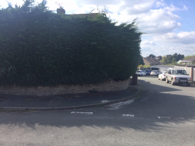

I'm considering applying for planning permission to replace our large hedge with a 2-meter high fence in our front garden.
I know planning can take a while, hence my other post about cutting the hedge back.
The hedge runs along a path next to the road (we live in a cul-de-sac). There is a small half-meter ish wall to define the property boundary.
Privacy is a big concern as our living room is so close to the hedge. I don't want to risk removing the hedge without having planning in place for the fence.
In terms of visibility, there is one driveway on the hedge side of the road (our neighbours) which he doesn't tend to use. The attached pics should help you see what's what.
We did have a run-in with building control when we had to enclose some unregistered land at the end of our drive at the back of the property. During the toing and froing, I do recall a mention of a previous application for a fence in the front being refused (but I think this was from way back).
I am trying to establish how likely it is that planning for the fence would be granted. I assume that the only way to be sure is to get it granted, but I would just as soon save £200 if there is no chance.
What's my best course of action?

As you can see from the photos, close board fences have been used either side of my front garden, these houses are at 90 degrees to mine so these are there back gardens.
What do you think my chances are?
I doubt that any council would approve a fence over 1m high on a bend - due to sightlines form road users - even though its no worse than a hedge.

Thanks! That's what I was afraid of.
