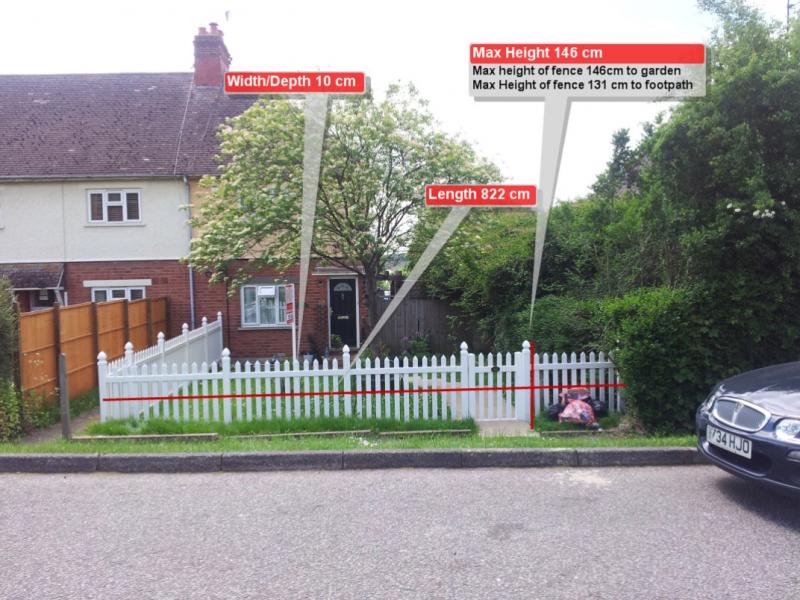

I can't picture this, can you post a photo? (without your neighbour seeing you taking one, don't want to make things worse!)

Photo please.
Here is the Pic.
//www.diynot.com/network/arakis777/albums/

The psycho next door has recently out up a six foot garden fence along our former shared path. Apparently that is OK by the council but not our fence.
We also put in a new private linked to the gate as seen.
The grass strip in front is where the old hedge was, so the fence is actually behind where the hedge was situated. The council now want us to move this fence almost 4 feet back again and paint it black or brown! Worst of all put the same type of hedge back. The original couldn't be trimmed properly as behind the bare front of leaves is just twigs. It was a cheap box hedge I was told.

As far as I am aware I have Permitted Development rights and we are not in a conservation or any other special area. One point though my house used to belong to the railway (we bought over two years ago on the open market), the psycho's house next door used to be council and they bought under 'right to buy' scheme. Our nice neighbour on the other side of the overgrown hedge rents from the council I believe. The road is a real mixture of detached/ semi / bungalows / terrace houses. The frontages of the houses also differ i.e. gray, black brown green (and now white picket fences. Metal railing fences, hedges, open plan etc.
