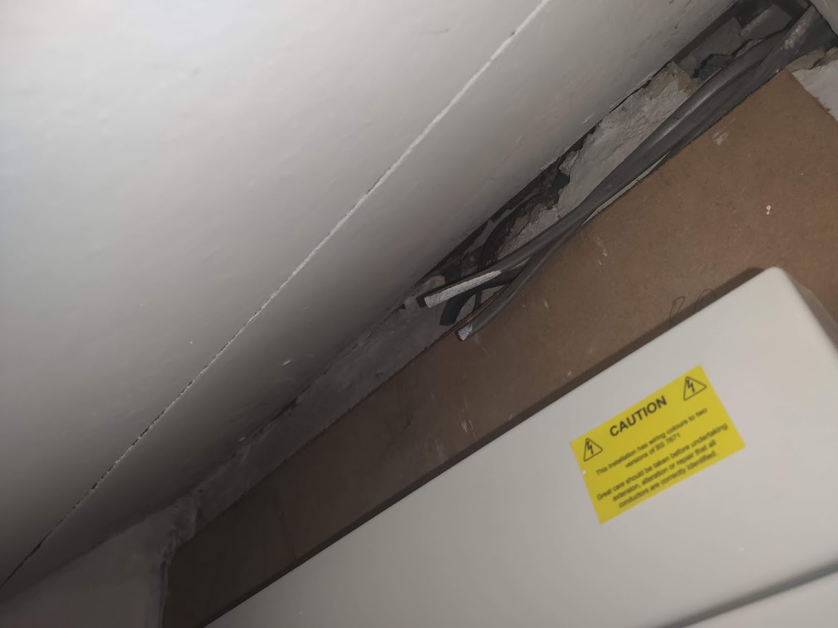

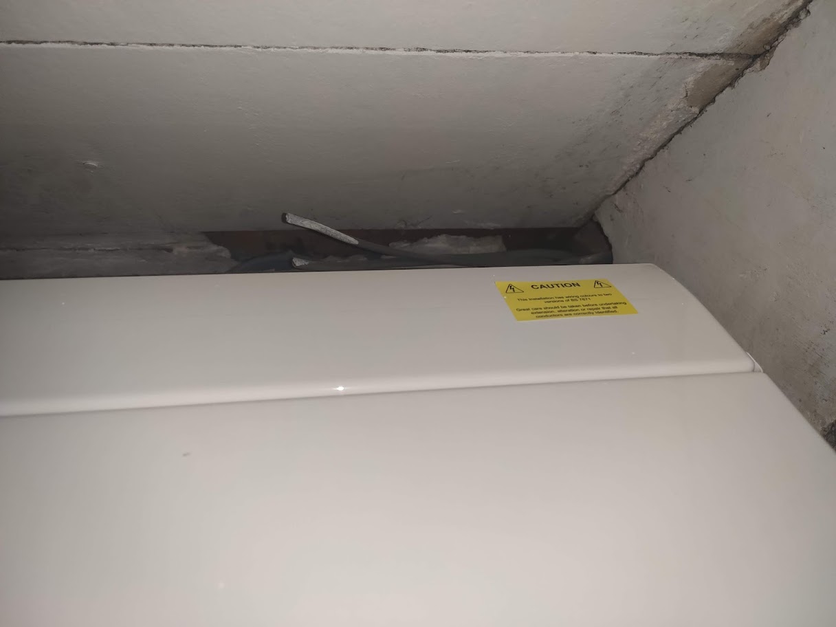

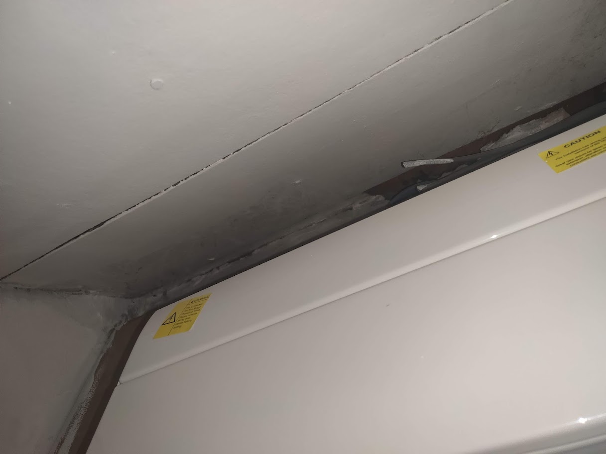

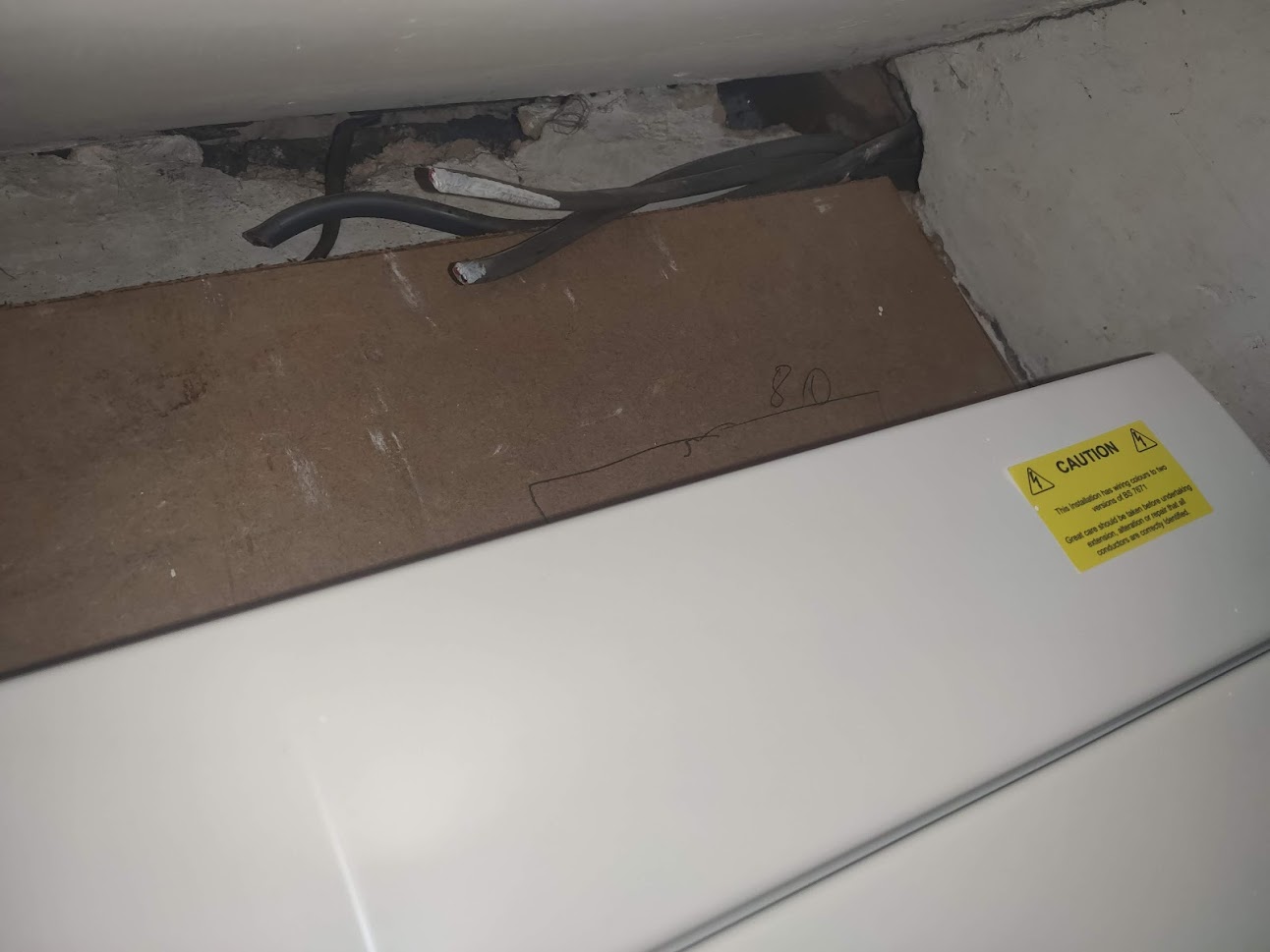

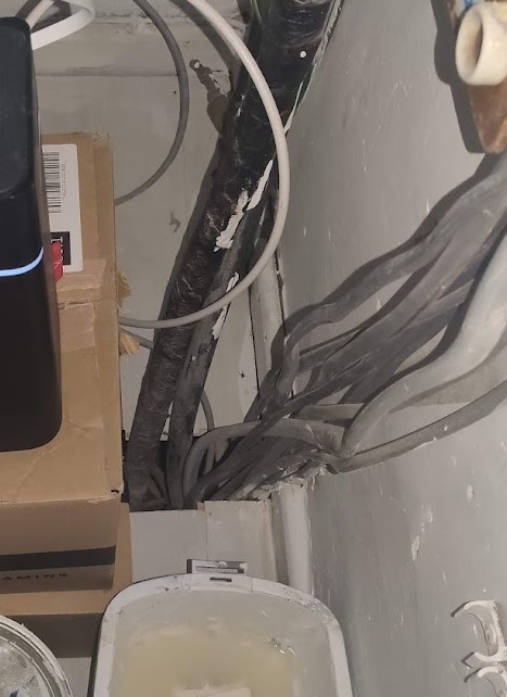

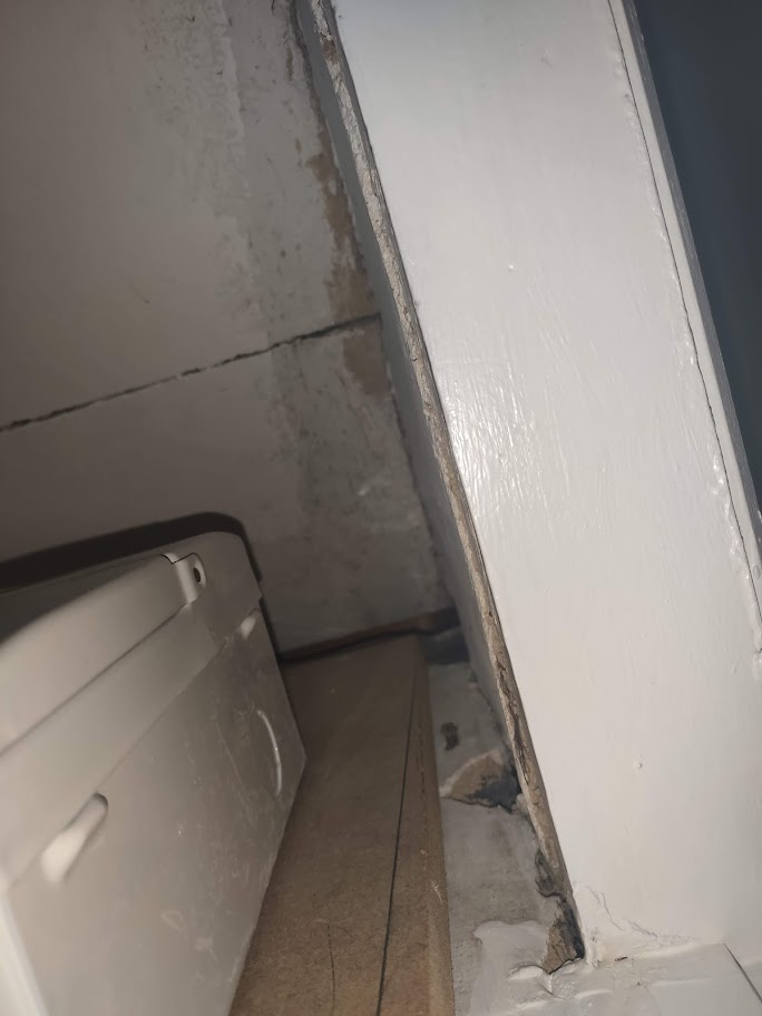

Hi guys,
I have recently moved houses and need to fill in gaps to prevent bugs entering the house. I am not a DIY person, but will be doing lots of research to gain more knowledge. While I was googling, I came across DIYnot and decided to create a post.
I have attached photos. There is the gas meter, electricity meter and the consumer unit. I came a cross expanding foams but wasn't sure if it was suitable for the job. Any guidance will help a lot.

Expanding foams are great for these areas......however, the area needs to be damped first, ideally - so watch what you are doing!

Thanks. I am just worried the cables might get damaged by the expanding foam. I've read contradicting information when googling. A friend of mine suggested I should hire someone and get it done properly. I am going to research more and I have a feeling I can DIY it. If it was just a crack in a wall outside it would have been easier, but the cables, the meters, the gas pipes just makes me nervous as a DIY virgin. Maybe I do need to hire someone. We'll see.

You might want to use minimal expanding foam.
https://www.toolstation.com/exact-gap-hand-held-expanding-foam/p66044
Oh, and it is not "exact". It does however expand less than some other brands.
@Burnerman is correct about spraying the area first. It helps adhesion and speeds up curing.
I would strongly recommend purchasing a can of foam cleaner as well. It will cost about a fiver but if you make a mess it will enable you to clean it up.
Oh.. and the majority of spray cans only work upside down. If you need to take a break until the next day. Hold the can up the normal way, pull the "trigger" to expel some of the propellant (but not the contents).

Put down polythene dust sheets though to catch the stuff that falls down though.
Any excess can be cut away a few hours later.
