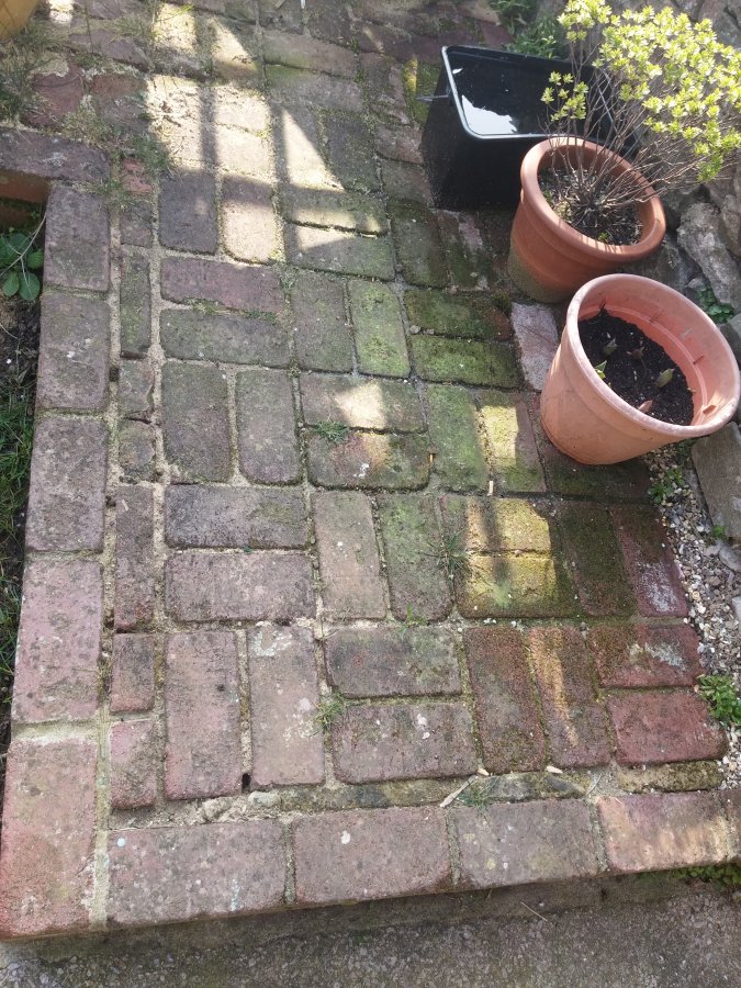

Its time to clean up the patio and rake out all the old weeds! My question is whats the best way to fill the spaces around the brickwork?
mortar, 3 parts plastering sand to 1 part cement mixed up damp/semi dry and pressed in hard and iron with a trowel or jointer.
