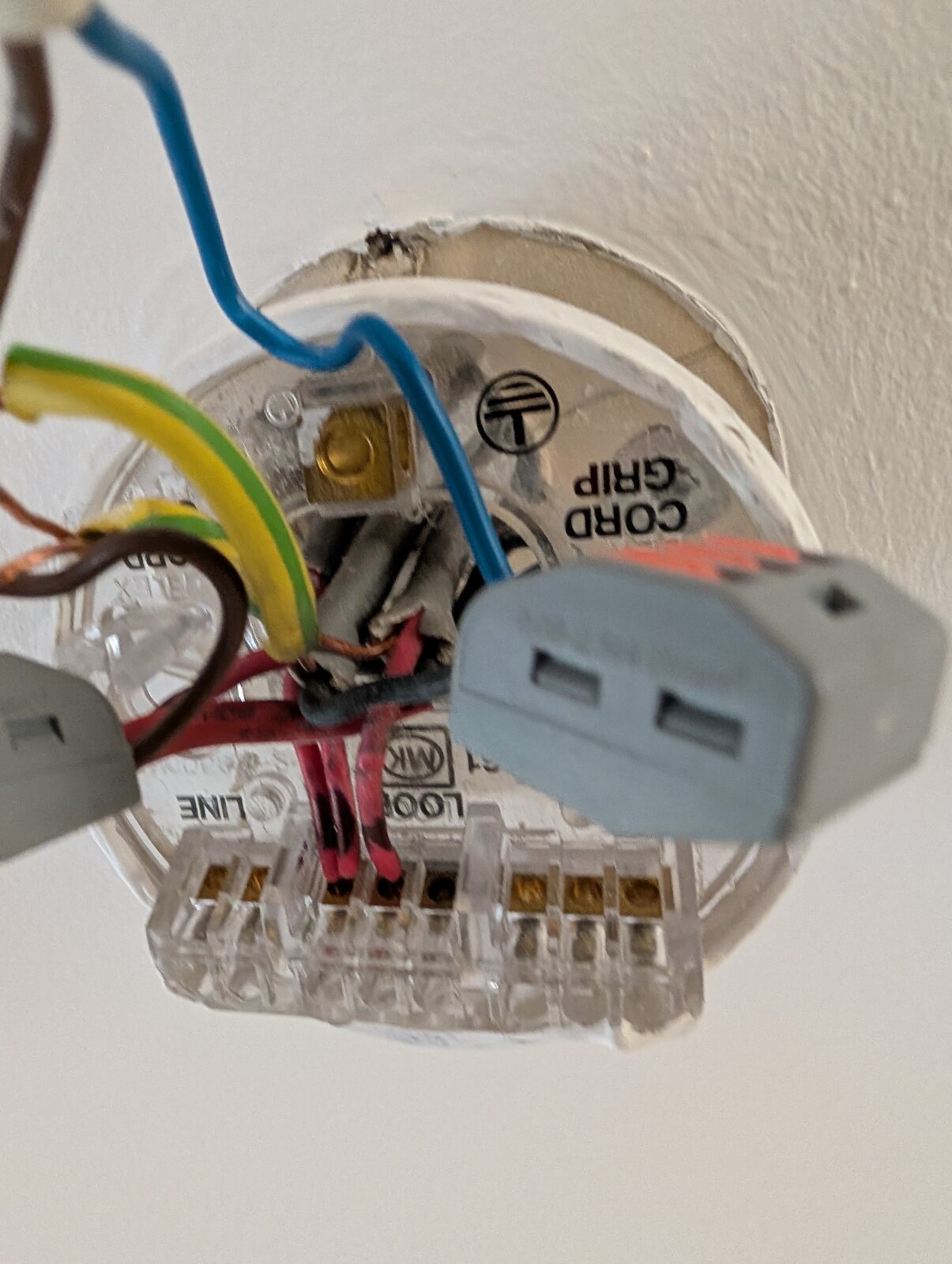

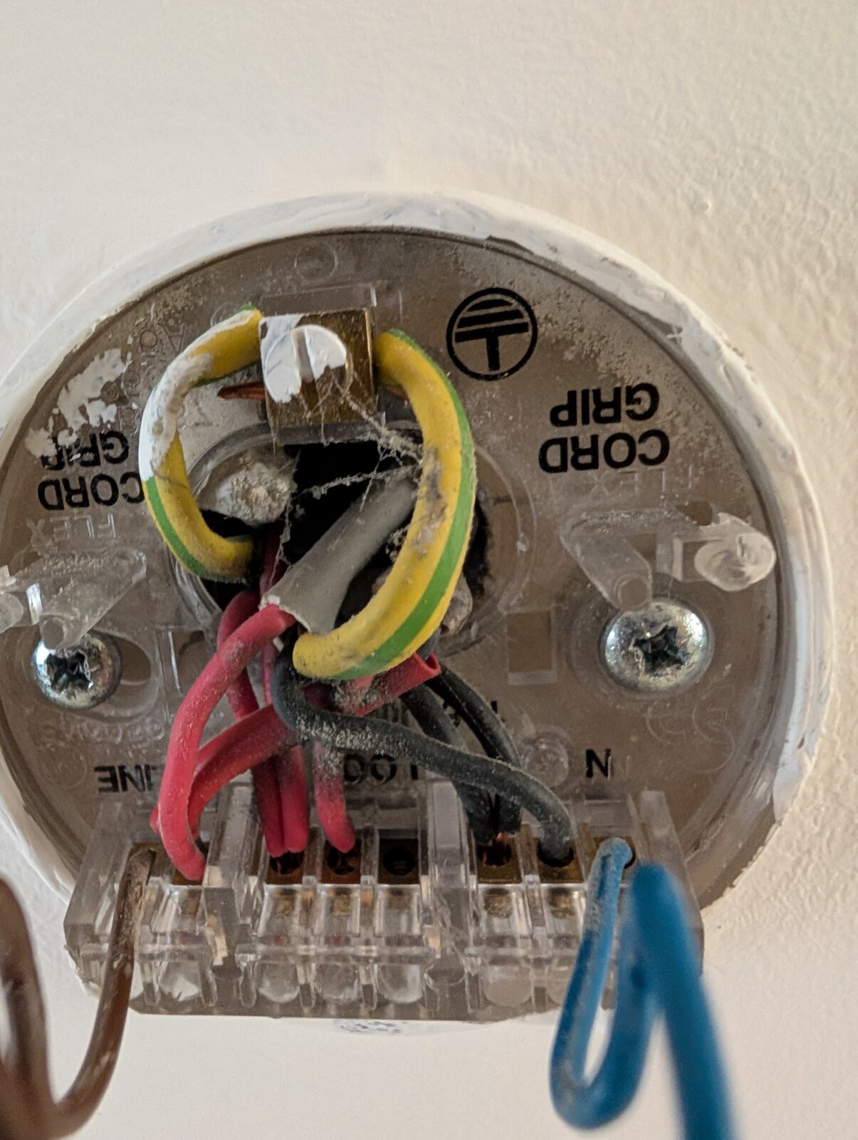

Hi ,
I am trying to fit another ceiling light, I've separated each set of connections to appropriate three or two wago connectors. No I cannot find space inside the base of the ceiling light to stuff four of these connectors! What am I doing wrong ? How to find space for them ?
Kind Regards
I am not an electrician...
But I would go for the smaller Wagos
Edit, and if you are keeping the rose, why do you need wagos?
What exactly are you going to fit?
Are you going to remove the rose?
Fitting a ceiling light. Removed the rose to fit the bracket for the heavy light . Separated the wires into different wago connectors ( four of them). Now I've got fit the base of the light to the bracket and put all these connectors inside and somehow fit them inside.
You could do all the connections above the ceiling? If you have access?
Not sure I'd bother with wagos there; it looks like it will cover the old rose so use the connectors in the rose..
